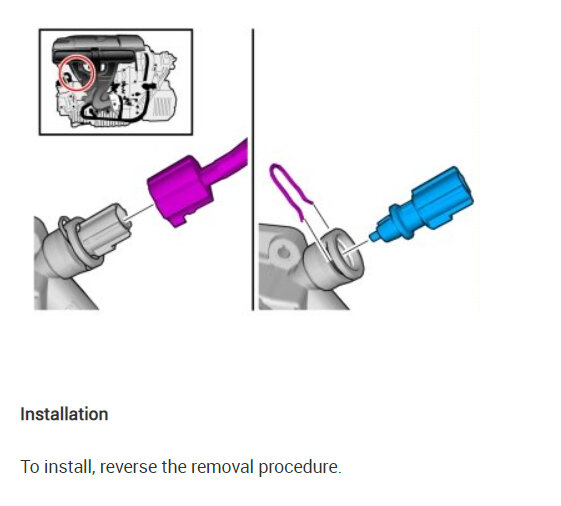

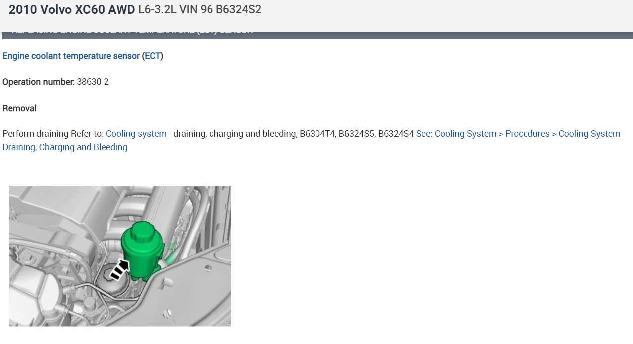

I have seen the engine coolant sensor cause this issue or a leaky fuel injector, I would remove the spark plugs to see if one of them is dark, this will be the cylinder with the bad fuel injector.
What reading does the scanner say is the temperature of the coolant sensor? Here is the location in case it is way off.

One picture show what looks like a power steering reservoir. Do you mean it's in the coolant reservoir?

That's a good sign it is not an injector, it looks like the coolant sensor is behind the power steering reservoir.
