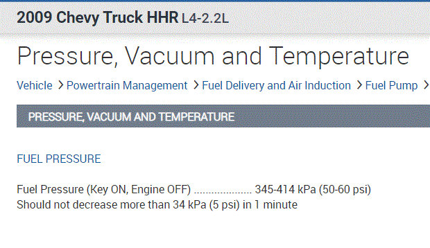

Based on that code, you are getting too much fuel to the engine. In this case, it wouldn't be a vacuum leak. A vacuum leak would allow unmetered air to enter the engine and create a lean mixture. This code can be caused by several things. However, here is a link that shows how to test for a vacuum leak:
Have you checked fuel pressure? Is this the only code present? If you have a live data scan tool, could you let me know the short-term fuel trims?
Make sure there are no restrictions in the air intake tube/air filter box. Also, check fuel pressure. Here is a link that shows how it's done:
I attached the manufacturer's pressure specifications below. Do this and let me know what you find.
See pic below.
