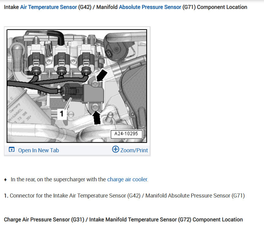

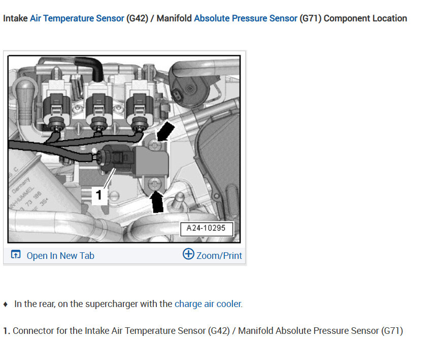

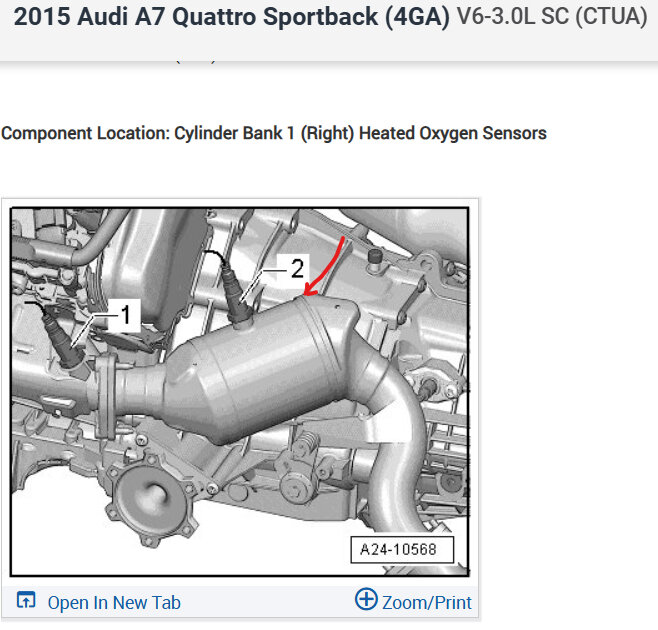

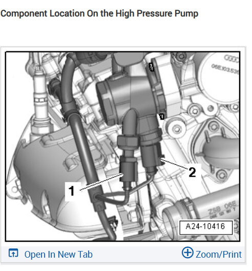

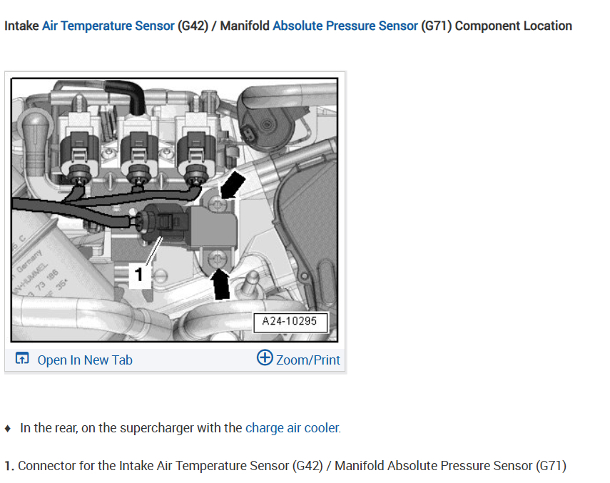

This can be caused by a few different things, Weak MAP sensor, intake runner control not opening fully, a weak high pressure pump or a partially clogged catalytic converter.
Here is a guide to help you check the cat:
Here is a guide that will help explain the causes of rich exhaust.
https://www.2carpros.com/articles/why-an-automotive-engine-will-run-rich
The P0172 code on a 2015 Audi A7 3.0L indicates that the engine control module (ECM) has detected that the air-fuel mixture is too rich in Bank 1.
Here are the locations of the MAP sensor and the cat for bank 1. You should be able to go to live data on the scanner and see the reading from bank 1 and bank 2 which should so differences which can help us as well. Check out the images (below). Please upload pictures or videos in your response of any problems so we can see what to help you with.
