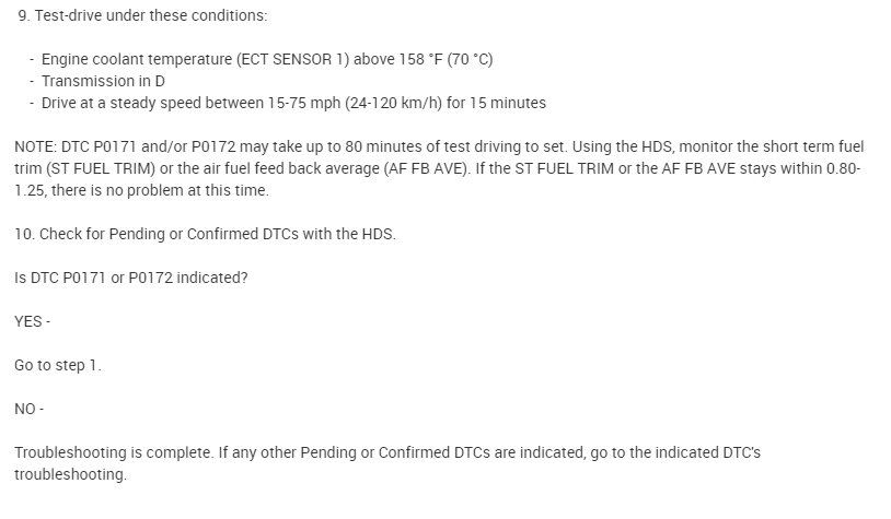

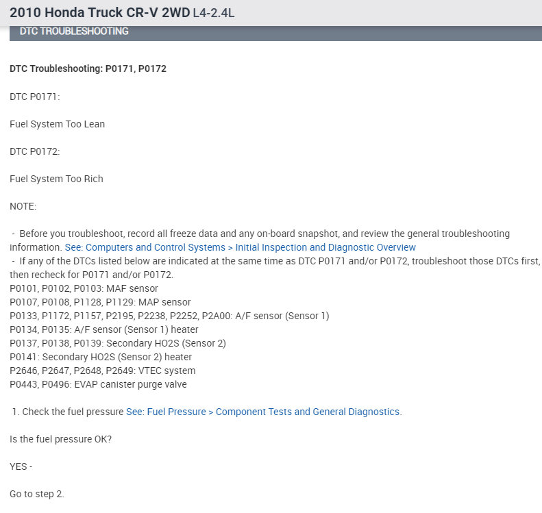

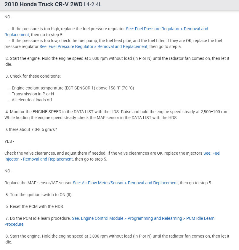

The code P0171 can get triggered due to a number of reasons.
It could be for having a vacuum leak, faulty mass air flow sensor, exhaust leak, worn spark plugs, bad oxygen sensor etc.
Take a look at this guide, it covers the basics of the code.
https://www.2carpros.com/articles/repair-lean-mixture-codes-p0171-or-p0174-on-some-manufacturers
I have attached the troubleshooting guide for the code P0171 below for your reference.
Let me know of any questions.
