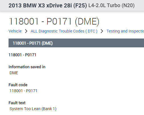

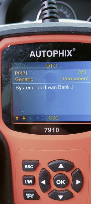

Code P0171, Permanent System too Lean Bank 1?
175,000 MILES • 2.0L • 4 CYL • 4WD • AUTOMATIC
ASHOK SAINI
  • 32 POSTS
I have smoke tested everything all tight, changed fuel cap, cleaned MAF and other sensor at throttle, installed new diverter valve, which have eliminated other faults but I keep getting this code even after I erase the temp code 118001 mixture control: Fuel-air mix too lean after driving 10-15 kms but this permanent code stays, I think is there anything /part under the engine valve cover which could be causing it but do not know what part is causing.

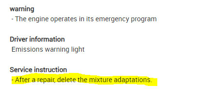

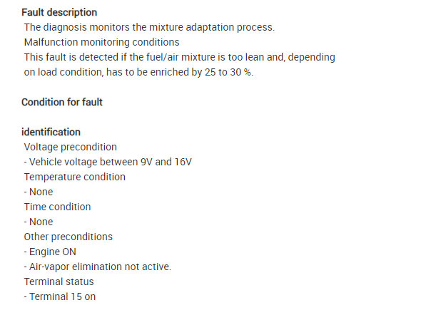

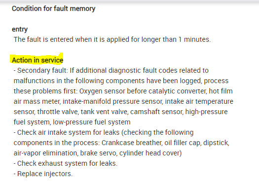

I attached the description below of the code from my manual. Read through it and let me know if the things mentioned under the "Action in Service" section were related to the prior repairs.
