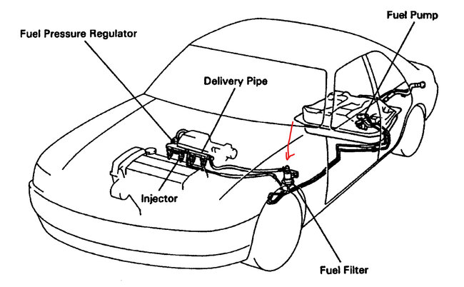

my car failed smog there was a code P 0171 that came up I have changed the spark plugs the wires the valve cover gasket and o2 sensor but the check engine light still remains on started the diagnosis on it everything turned out fine but still have p 0171 any advice

p0171 means the engine is running lean, check fuel pressure with a gauge and for a vacuum leak.

The first thing I would do is change the fuel filter which will restrict the amount of fuel the engine is getting causing the lean code, here is a guide that can help you understand the lean code as well.
https://www.2carpros.com/articles/repair-lean-mixture-codes-p0171-or-p0174-on-some-manufacturers
Here is the location of the fuel filter so you can swap it out. Check out the images (below). Please let us know what happens.
