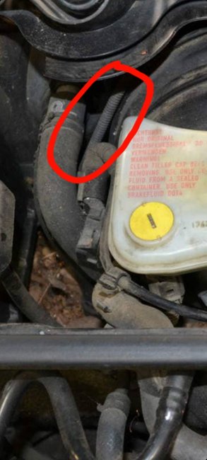

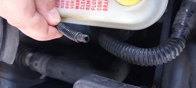

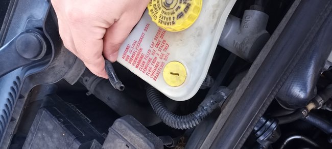

So, I used a smoker a friend made. I didn't see anything through the intake manifold or crankcase vent valve, but I ran the hose through the intake manifold and smoke came out through the side of the airbox (as seen on the video attached). Also found a rogue disconnected hose by the brake booster (see images attached). It was tucked in and hidden probably by the previous owner. Any clue on where it can possibly connect to or what the part is called? Thank you.

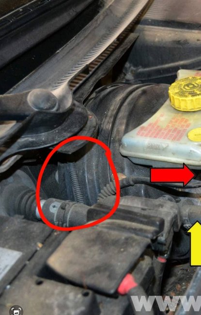

I searched everywhere online and couldn't find anything about what this plastic hose part is called and where it connects. The hose leads to the driver's side door. Some images I found online (see images attached) seem to show that it should connect under to the side of the master cylinder and booster or somewhere around there, but I can't see for sure. Help is appreciated.

Just to jump in on this, if you are seeing smoke coming from under what appears to be exhaust, then that is most likely not the cause of the lean code.
Here is a guide that talks about lean codes in more general info but if you find a vacuum hose then that is most likely the source:
https://www.2carpros.com/articles/repair-lean-mixture-codes-p0171-or-p0174-on-some-manufacturers
What I would suggest is we cap that line if you can run the engine and feel it pulling a vacuum through the hose.
Then you can clear the code and run the engine and make sure that code does not come back.
If we confirm the code is gone then we can use the documents below to try and locate where the line goes.
However, can you trace the other side of it and see if it leads to the intake or a vacuum pump?

Thank you for the response, Kenny K. I've done some research and inspection and figured out that the disconnected hose connects to the battery. It is a vent for the battery that releases the battery gases under the fender. I thought I was on to something. Back to the grind. Thank you for clarifying the smoke coming from the exhaust. I was confused. I cannot find a leak using smoke anywhere in the engine. Maybe it's a small leak. I've tried inducing smoke through the PCV valve, intake manifold, dipstick. Are there other areas I should run smoke through to inspect for leaks? Thanks again
