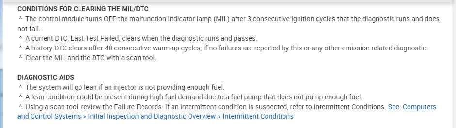

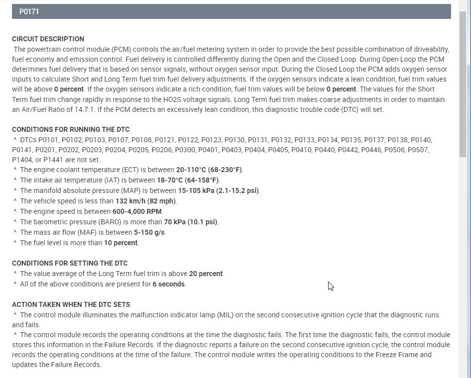

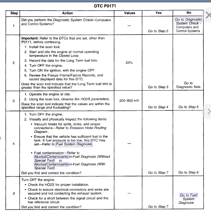

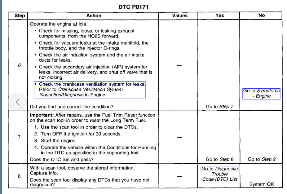

There are a number of things that can cause this. First and foremost is a vacuum leak.
However, we need to run through the testing shown in the attachments.
Also, here is a guide that goes through most of the same things but just a different format. Let me know what you find with the testing and we can go from there. Thanks
