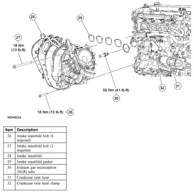

Fuel pressure should be checked (48-70psi), but a few simple things to check before that is the intake gaskets, smoke tests will not always catch these! also what was the freeze frame data for the ect/cht temperature when the code was set? if it reads under 120 or so degrees, that also tells me it could be the intake gaskets, even though the light came on when it was warm. You can monitor the O2s11,21 sensor pids while spraying the intake with brake clean (away from the alternator). The voltage will spike upwards when you hit the leak source. Do this when the engine is cold though.

After looking further, the Long Term Fuel Trim Bank 1 seems way too high, so the engine is really trying to compensate. While in both cases the Intake Manifold Pressure seems in the good range, no? I will keep an eye for it when the car is cold, if there is an issue then it really points to the gasket.

Thank you thank you thank you for the awesome info!!!! I can't say this enough!!! This is what I look at every day so it has become like second nature to diagnose a vehicle with this data! Your throttle position tells me that you were at a standstill or parked and the engine time running is not long but is close to a cool start which leads me to believe that the intake gaskets are the culprit. The ambient temp also leads me in that direction because every year during this time I do tons of intake gaskets because the rubber in them turns hard as a rock and doesn't provide the sealing action. The freeze frame data can be misleading in that is is not a true "freezeframe" of the exact time that things happened to set the code, instead it is the time that the parameters did not correct to the in spec numbers that the PCM is looking for, in other words when things go lean the PCM will try to run the fuel the opposite way for a certain amount of time, after this amount of calibrated time if things do not change then it will set the code, which could be several minutes after the lean condition occurred and the engine is now warm and the gaskets are all warm and supple. The run time also is an indicator.

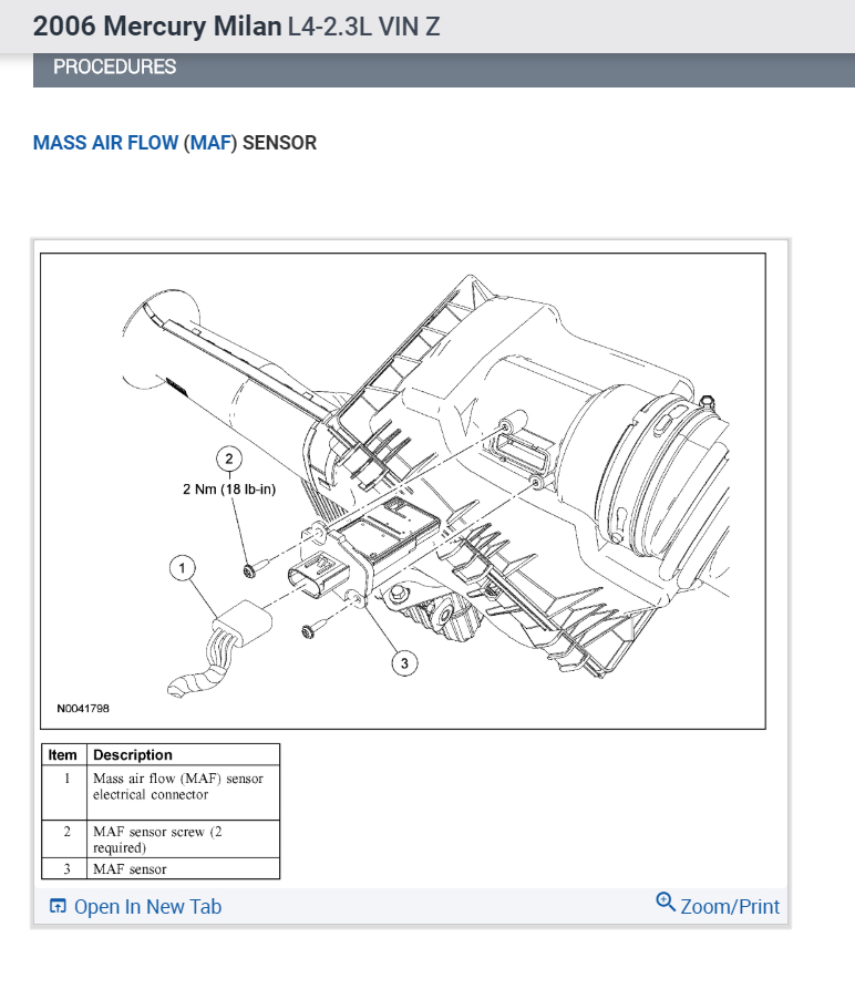

If I can jump in here. I noticed this:
Engine Load = 44.314 %
At idle, and that you cleaned the MAF? I would replace the MAF with a new unit because cleaning doe not always work and sometimes it can make it worse. Here is a guide to walk you through the repair and the location for your car below:
https://www.2carpros.com/articles/how-to-replace-a-mass-air-flow-sensor-maf
