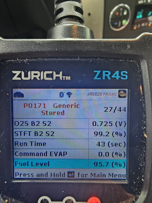

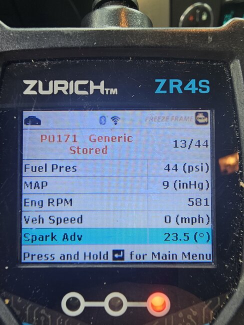

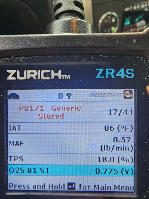

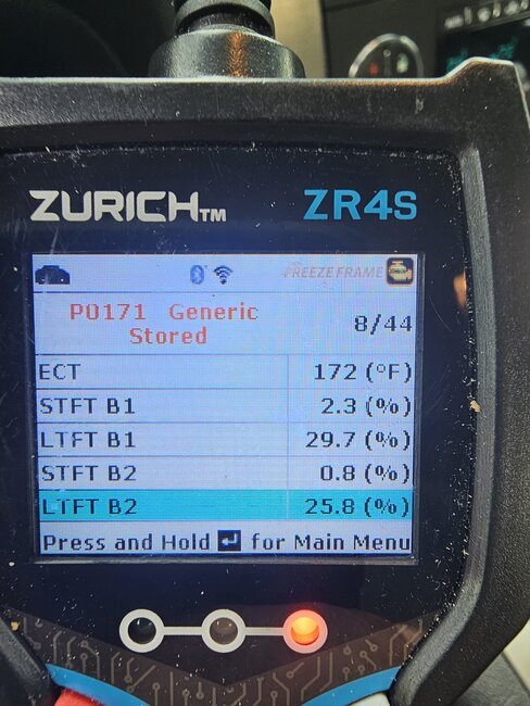

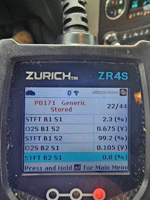

P0171 code. Cleaned MAF then got a p0174 temporarily. Sprayed water at base of intake and no noticeable difference. Not sure where to go next. My basic scan tool said fuel pressure at idle was 44 psi. It is the 5.3 lc9 flex fuel engine. Sluggish take off and bad fuel economy. About 13MPG.

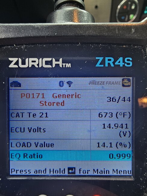

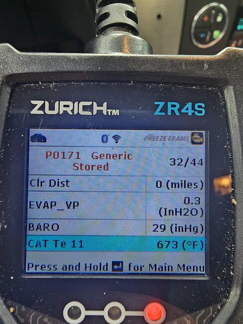

Sorry, the cleaning didn't fix it. It caused a second code, p0174, temporarily. I tried to load the scanner freeze frame to give you more info.

By these readings I would replace check for vacuum and exhaust leaks and if there none replace the sensor. Also, you should check the fuel pressure, here are guides to help you:
https://www.2carpros.com/articles/repair-lean-mixture-codes-p0171-or-p0174-on-some-manufacturers
Use this guide when the engine is cold only:
and
Key On Engine Off (KOEO): The fuel pressure should be approximately 60-66 PSI. (Pounds per square inch).
Key On Engine Running (KOER): The fuel pressure should be approximately 55-62 PSI.
You can rent the gauge at the local auto parts store for free or cheap. Please go over these guides and get back to us.
