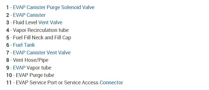

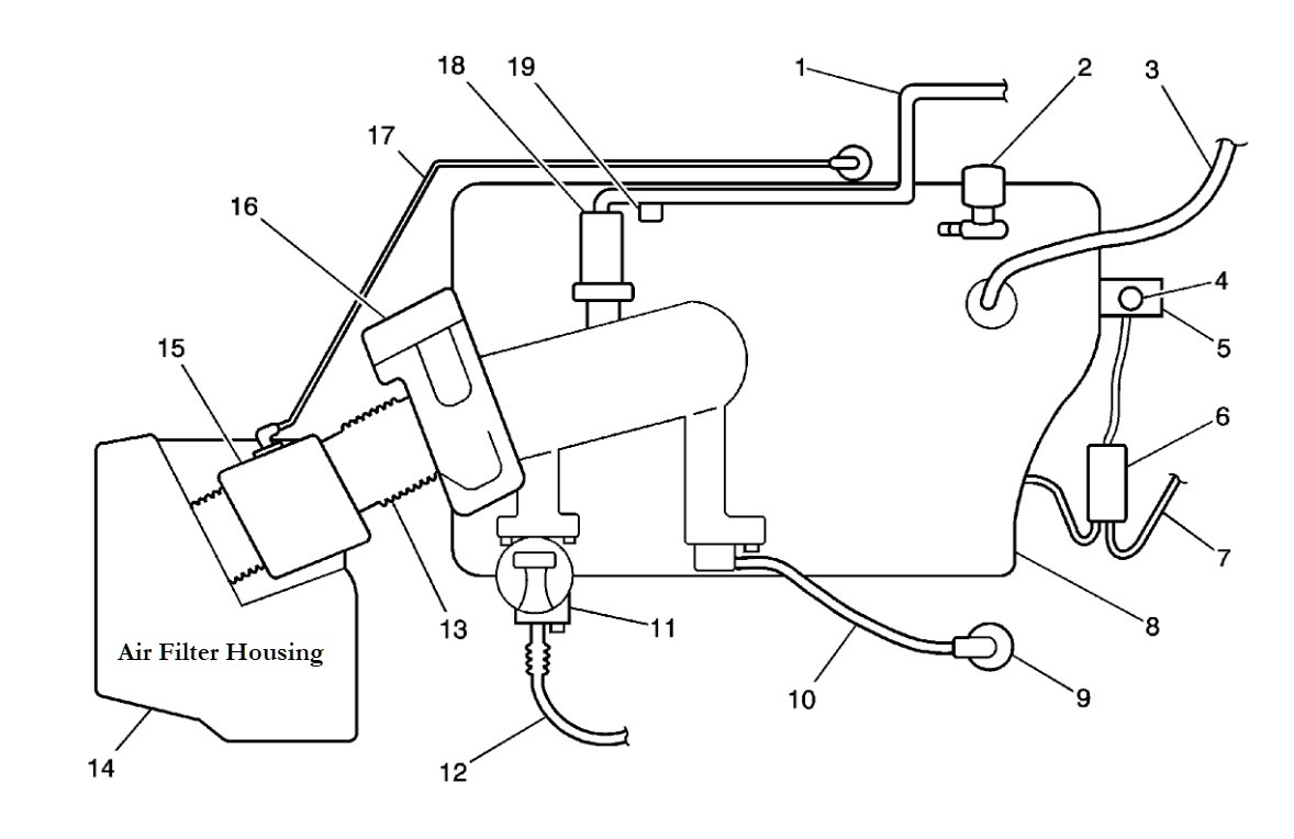

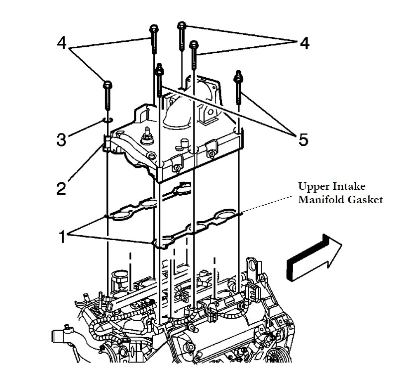

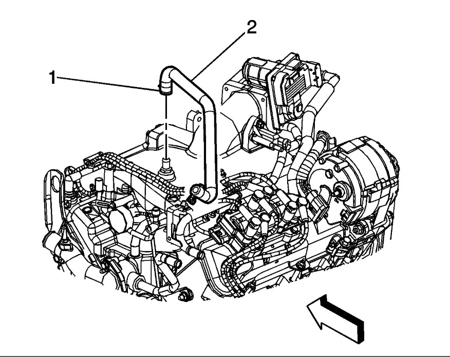

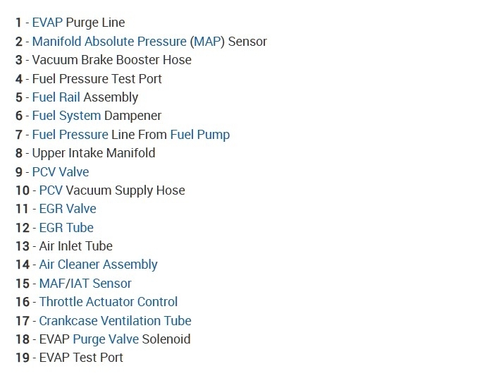

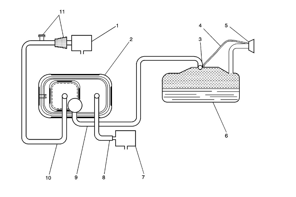

Diagrams 1 and 2 below are the vacuum hose routing looking down on the top of the engine. You can do a visual inspection first for any loose or broken hoses. Some vacuum leaks you can hear hissing. After you do your visual inspection, looking at some scan tool data will be our next step. We need to know if its an actual air leak into the engine, or possibly a lack of fuel.
If we see high positive Fuel Trim numbers on the live scan tool data (ie +15% for example) and raise the rpm to 2500 and the that +15% comes down closer to 0%, we know we are most likely dealing with a vacuum leak. The +15% means the engine computer(ECM) is adding 15% more fuel than it should to compensate for additional air entering the engine.
on the other hand, a failing sensor can cause the same code (is, an Oxygen sensor with a stuck low voltage will cause the ECM to think there is a lean exhaust when there really isnt.
You can see how combining scan tool data and a couple simple things such as raising the rpm can reveal what may be happening. The other diagrams are of the upper intake manifold gasket. There is a lower intake manifold with gaskets on each bank of the engine. We would find intake leaks using a smoke maching and isolating the crankcase from it to check for leaks. There are some other methods as well if needed.

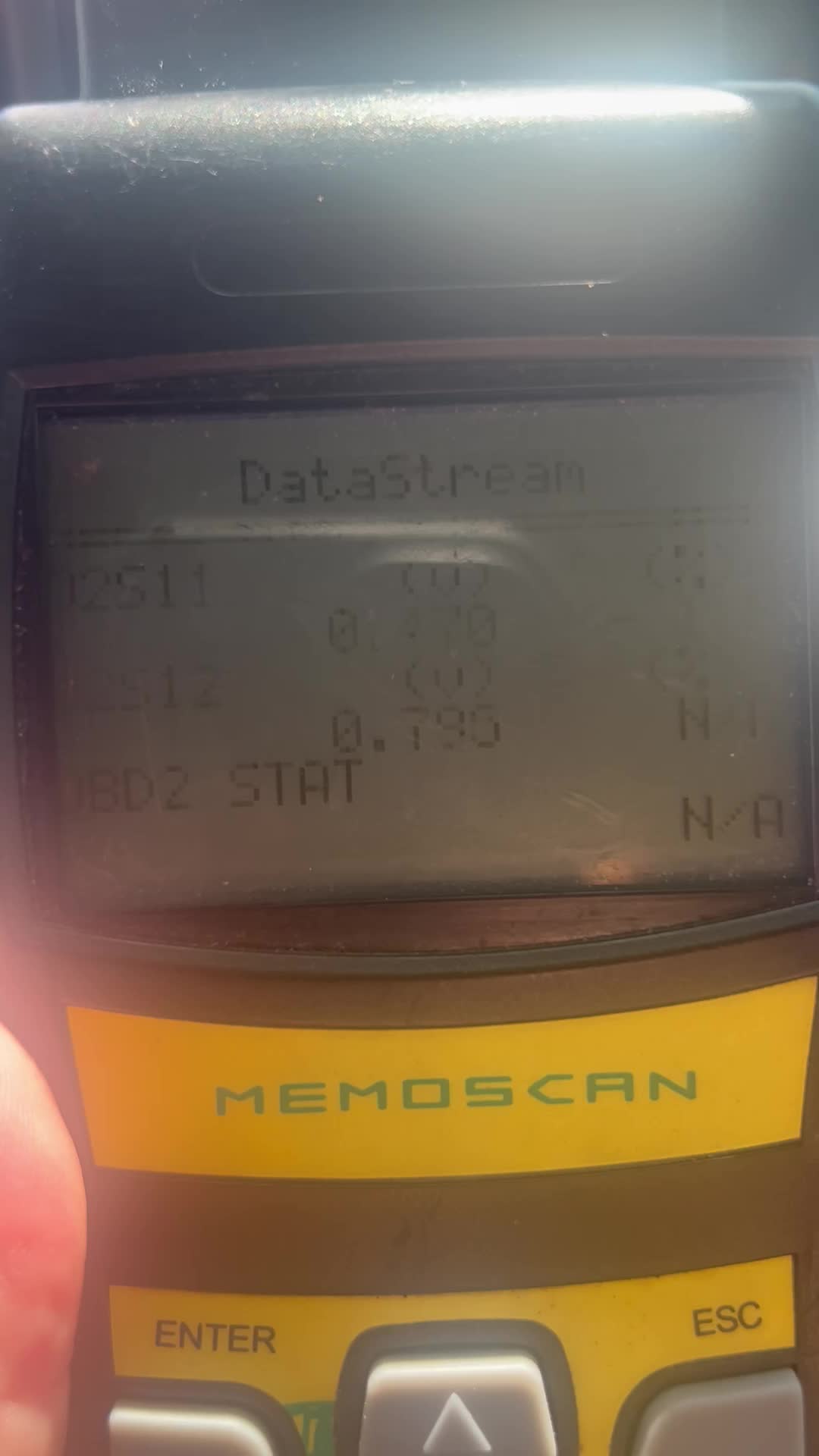

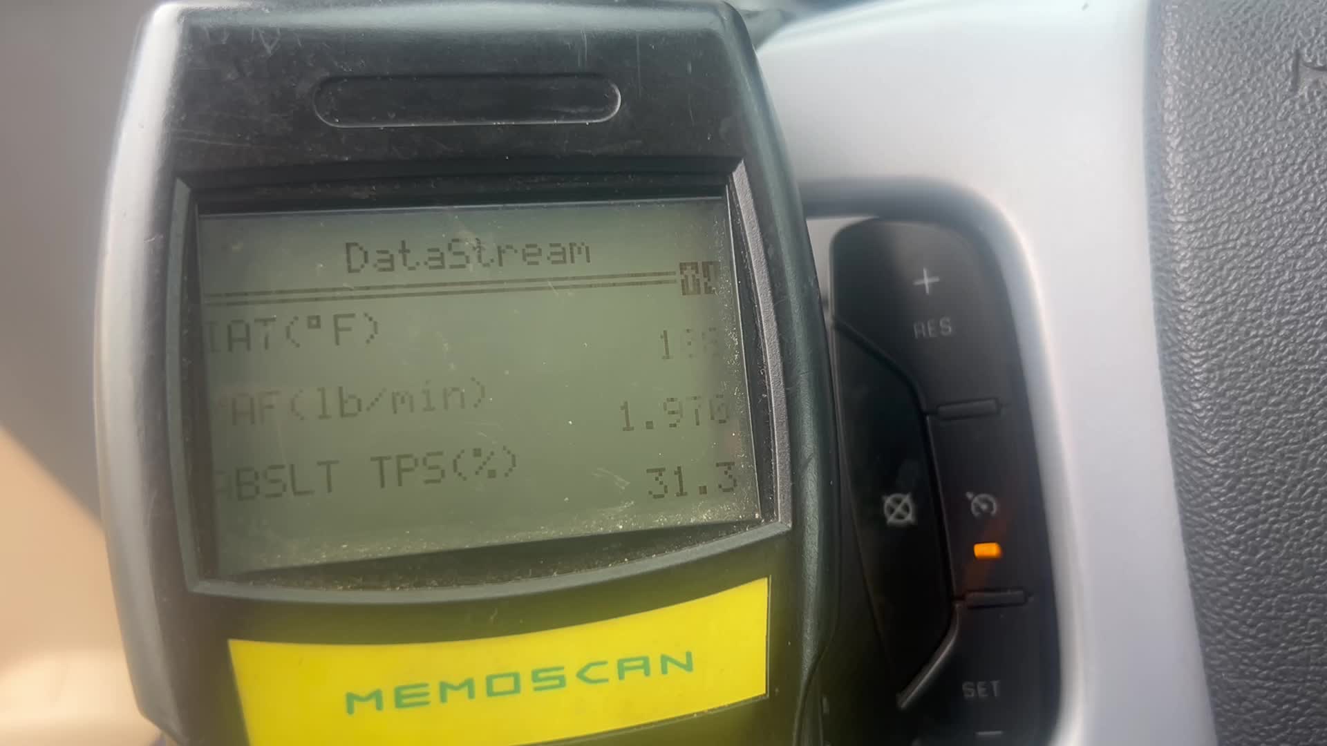

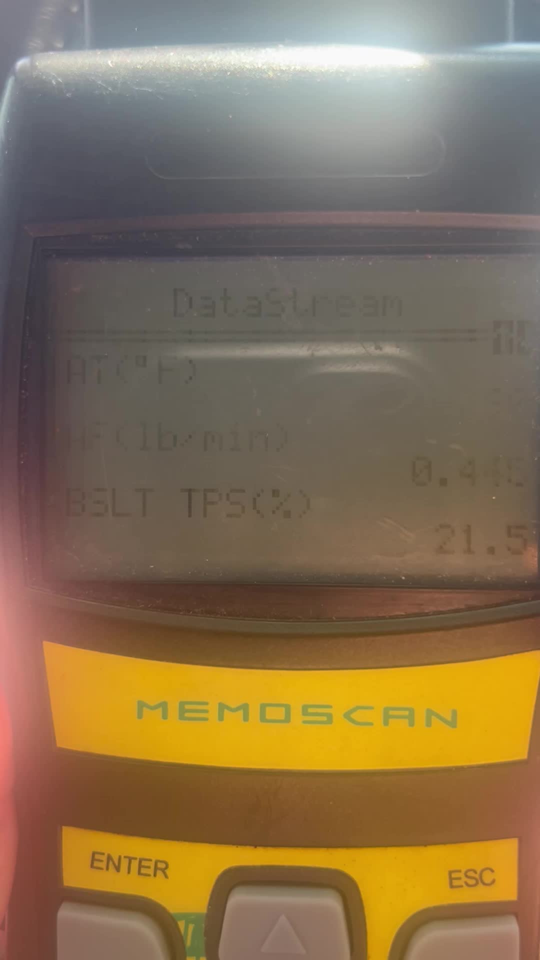

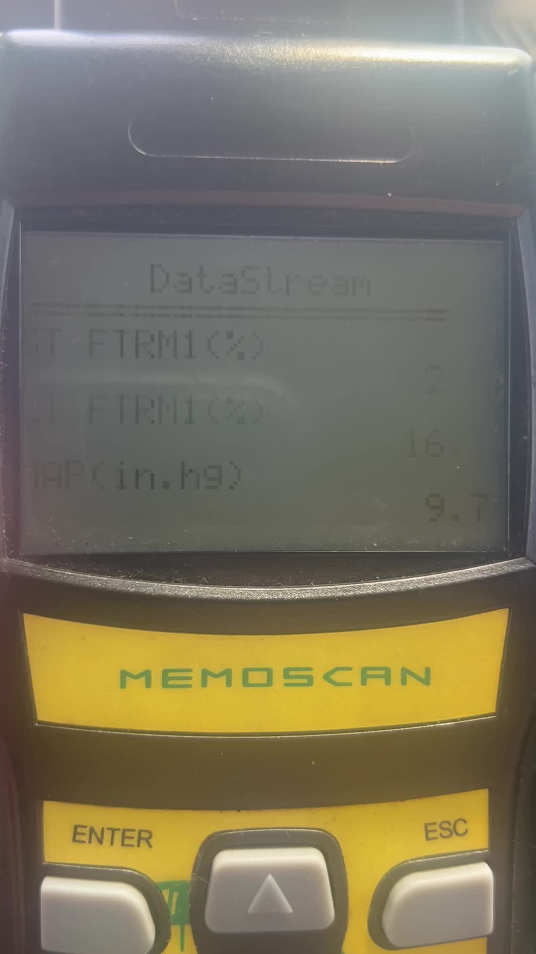

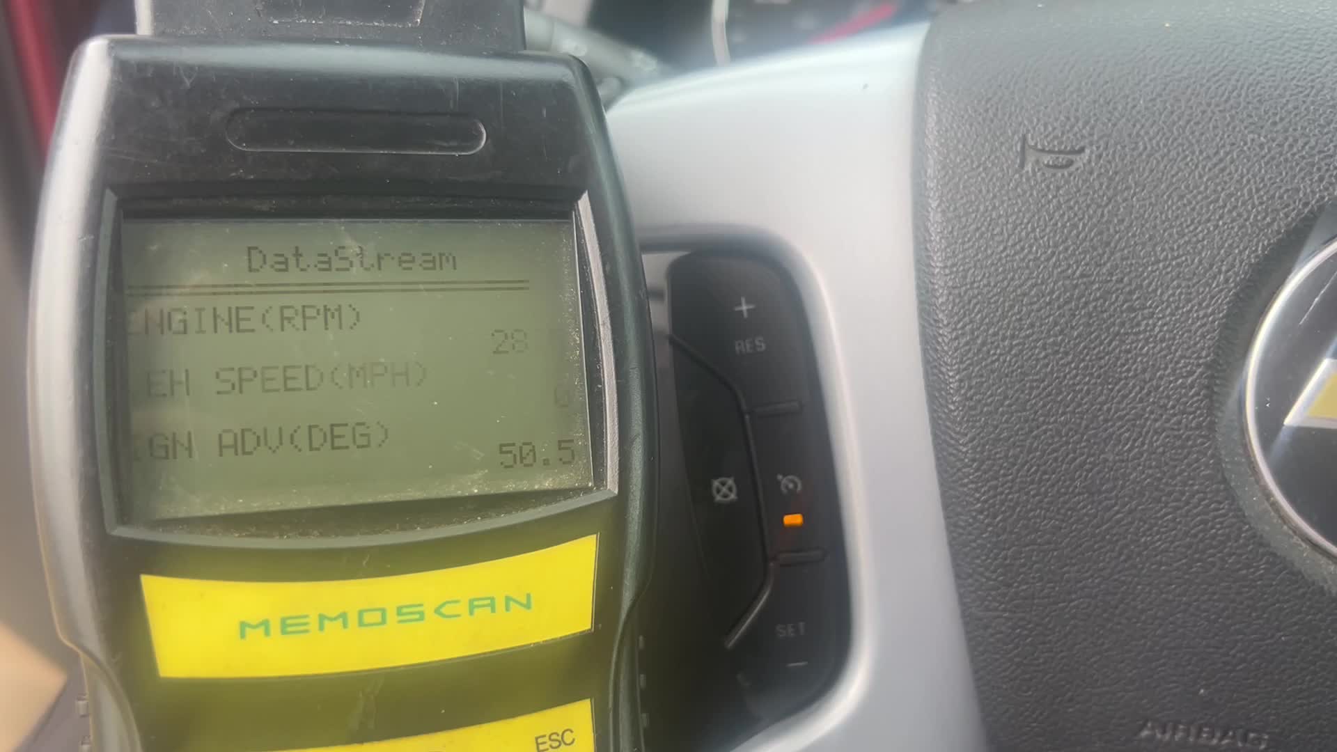

Here are the readings I got they are fluctuating and I know it’s hard to read but I have attached videos

STFT and LTFT, are the short term and long term fuel trims. Those are the numbers we want to see at idle and then at 2500rpm. Take note if the numbers are positive or negative. Technically it should be a high positive number if the ECM is setting a lean code. Positive numbers from 1% to +25%(for example) means the ECM is adding fuel, attempting to bring the air/fuel ratio back to where its suppposed to be. Negative numbers mean the ECM is taking fuel away, the opposite condition.
You want to have Fuel trims that are as close to zero (0%) as possible. I dont like to see anything that stays steady above 10% +/-. That points to a problem.
the next sensor I would look at are the Oxygen sensor readings.
This vehicle Im sure has 4 Oyxgen sensors, 2 up front before the Catayltic converters and 2 after the cats.
The rear Oxygen sensors (B1S2 and B2S2) bank 1 and bank 2, sensor #2, should read a steady voltage, lets say 0.6volts (600mv).
You dont want to see them fluctuating their voltage, or stuck low or high, such as 0.1volts or 0.9volts. Note this less than a 1volt reading on a basic OLD2 scan tool like you have.
Start by checking the oxygen sensor and fuel trim data at a hot idle and then raise the rpm to 2500rpm, try to hold it steady, and recheck those same sensor readings.
Oxygen sensors may be displayed with the B1S1 02 reading(Bank 1 Sensor 1-up front), Bank 2 Sensor 1-up front.
Just a quick look at the wiring diagrams, I only see 1 oxygen sensor up front of the cat and 1 behind it. Which is odd on a V6, usually there are at least 1 per bank of the engine.
*I was able to zoom in on a picture of your scan tool readings, the LT (long Term) FTRM1 has a reading of +16%, not good, add that with the 2% of ST (short term) fuel trim and you are at +18%.
Now raise the rpm to 2500 and hold it for a minute or two, does that number come down towards 0%?

The MAP reading looks ok at idle. Im trying to see if I can make out any other readings in your vidoes. If im seeing the MAF correctly, I think 0.445lb/min, that is about correct at idle, (converts to 3.3g/s). I cant see the IAT(F) reading at all.

The ECM is adding 18% more fuel, compensating for some issue. Im not seeing any bad sensor data yet, but check it at 2500rpm and let me know if that number comes down. And the Oxygen sensor readings - 02S11 and 02S12. These are you oxygen sensors. 02 Sensor 1 Bank 1, thats the front oxygen sensor. 02S12 is 02 Bank 1 Sensor 2- this is the sensor behind the catalytic converter in the exhaust pipt.
I can see the rear sensor is reading 0.796volts, so almost 0.8volts. The front sensor should be fluctuating from 0.2volts to 0.8volts to 0.2volts and so on. If it is stuck there, at what I think is 0.4volts? Im not sure, but it should not be a stuck voltage reading.

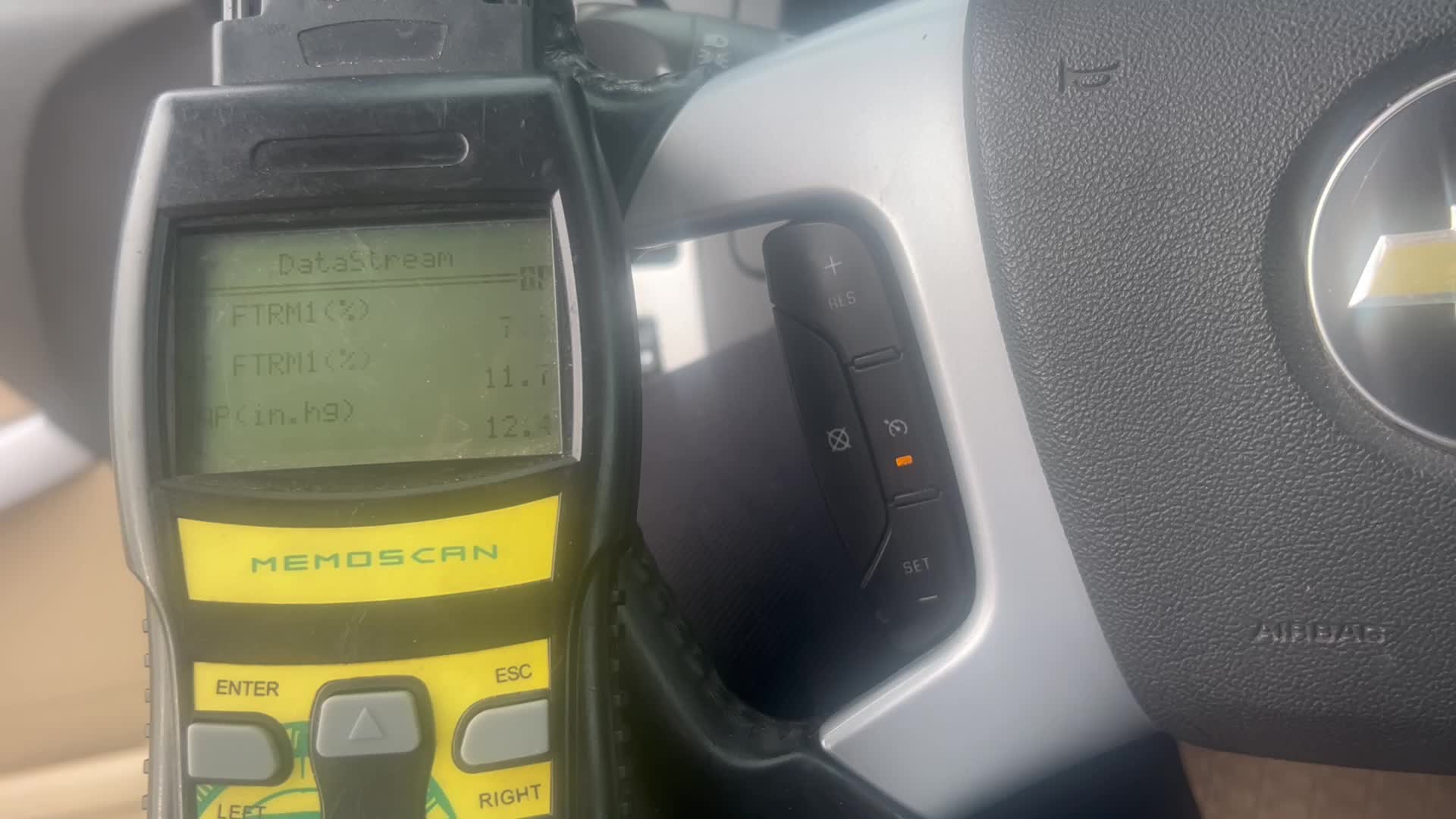

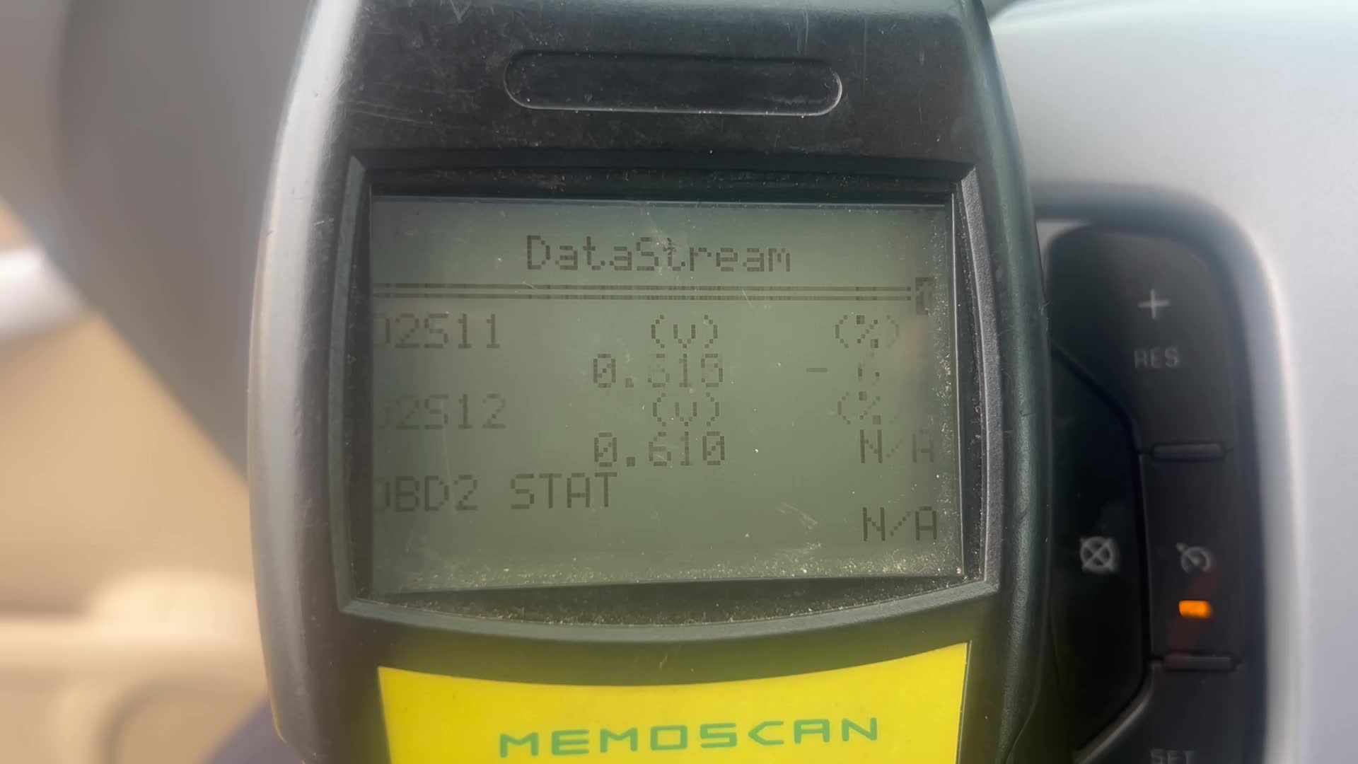

Here are the updated videos you requested
I idled the car just like you said

So in the last video you can see that as you held the throttle open, the Long Term fuel trims came down to +10%, and the Short Term was at -6% from what I could see. Adding those numbers together and we get +4%, which is good. Remember we want close to 0%.
This is confusing I understand that, but High positive fuel trim numbers at idle that come down at higher rpms, points to a vacuum leak being at least a main issue. Issues sush as a bad intake gasket or broken vacuum hose will cause leaks into the engine that effect it more when manifold vacuum is high such as at idle.
I would check for any leaking hoses and such, but really doing a smoke test on the intake manifold to check for leaks is what I would do if there are no obvious air leaks into the engine. This guide below has picture examples of cracked hoses and vacuum leaks. Smoke testing the intake will need to be done by a shop with the equiptment to do so. Or the test results can be misleading, especially on V engines like this.

I posted these previously, but diagrams 1 and 2 are for vacuum hose and air intake hose routing in the engine compartment, diagrams 3 and 4 are for the vapor management system. If you dont have a smoke machine, it can be difficult to find these leaks, especially if its something like the lower intake manifold gasket leaking (for example), you wont be able to see that at all. The fastest way to get this repaired, if you have an inspection coming up, would be have someone smoke test the engine for you. Not the repair, let someone diagnose the fault and tell you what the issue is. Then do the repair yourself if you are comfortable with it.
Another test you can do with the engine running is spray a little water with a spray bottle around the area of lower intake manifold. If the leaks is present there and bad enough, you will hear the water being pulled in. It will sound like an air leak a bit more because of the water. But you can spend endless hours looking for leaks like this without the proper testing equiptment.
