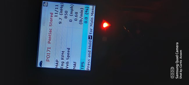

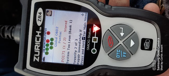

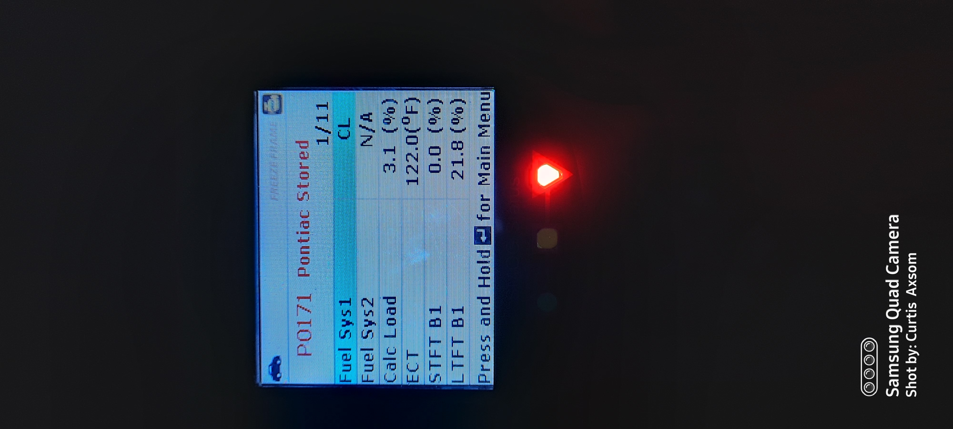

Replaced: vacuum hoses, intake manifold gasket, new spark plug wires, new spark plugs, fixed exhaust leak, new PCV valve, new MAP sensor. I am still firing a p0171 code. It was happening frequently but since the MAP sensor replacement it's only happening at very low speed. I will list the freeze frame details: fuel system- CL, calc load- 3.1, ect- 122, stft- 0, ltft- 21.8, map- 9.7, eng rpm- 850, veh speed- 0, maf- .68, tps- 0. I'm monitor status is showing 2 red icons...c and ev. Any ideas what to change next?

Good morning,
Can you give me the long-term trim for the O2 sensor, bank 1?
https://www.2carpros.com/articles/repair-lean-mixture-codes-p0171-or-p0174-on-some-manufacturers
I would also check the fuel pressure. Low pressure is a very common reason for the lean codes.

I don't think believe the reader I have does that.
Feb 26, 2021 at 9:59 AM
It is in the first picture. It is 21%.
Make sure you check the fuel pressure.
