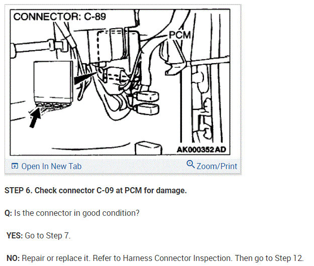

after rough idle and i had p0154 and p0172 i cleaned the mass airflow sensor and replaced the 02-sensor bank 2 sensor one (driver side pre-cat), both of those codes disappeared and were replaced by p0155. I will be checking the connections tomorrow for power as well as probably inspecting the lines back to the ECU.
Oct 16, 2021 at 12:28 PM
TIM GOODLIFFE
  • 7 POSTS
please note that the standing voltage of the sensor (at idle) before replacement was about .04 (bank 1 was .20) and after replacement was .72 (bank 1 was .76) so much closer.
Oct 16, 2021 at 12:47 PM
  • 110,236 POSTS

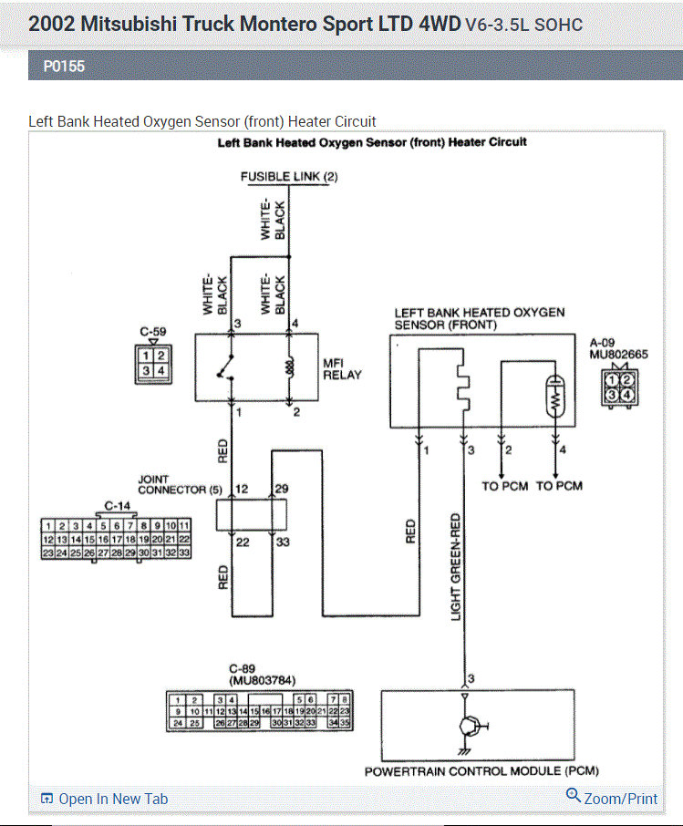

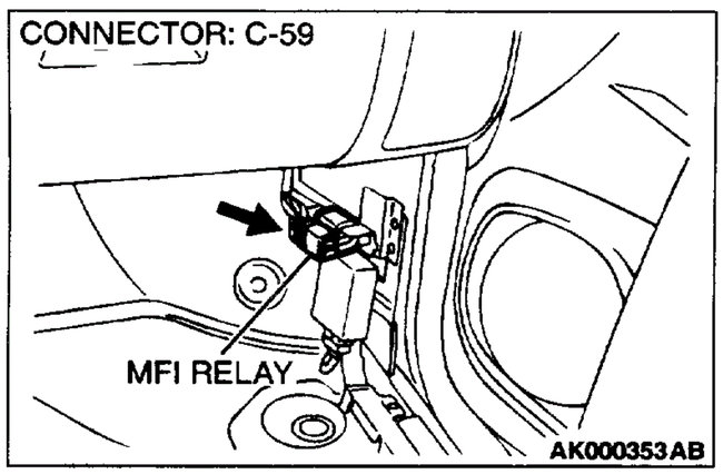

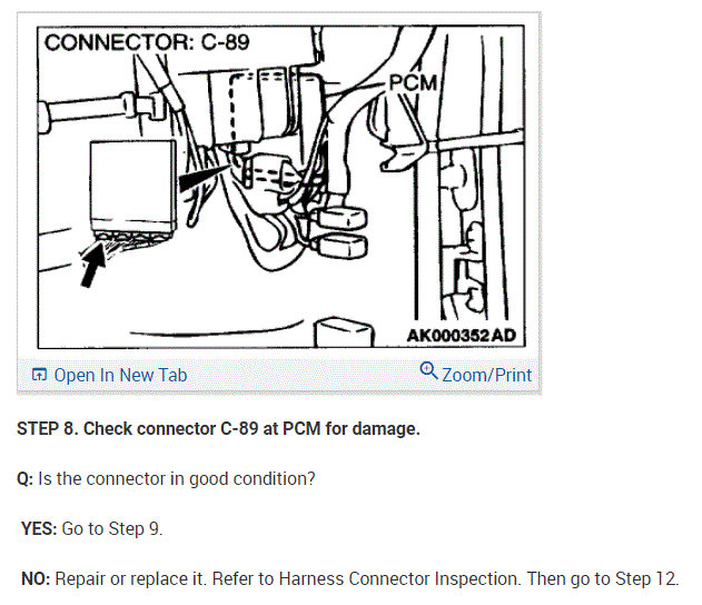

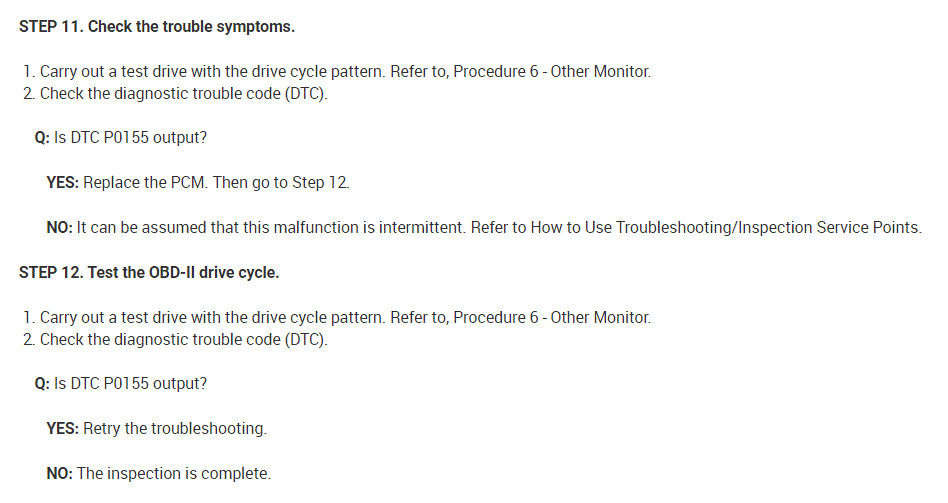

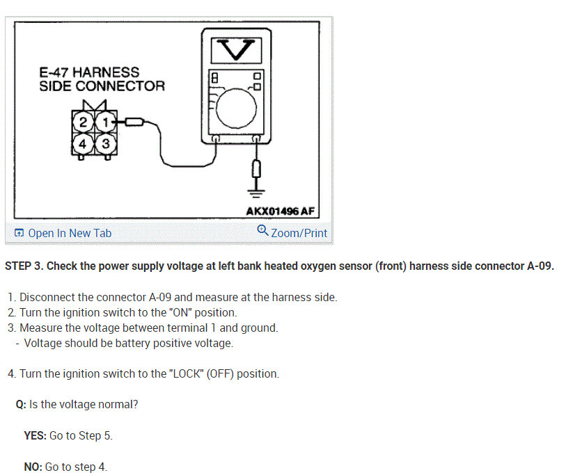

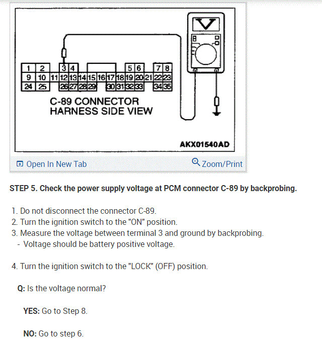

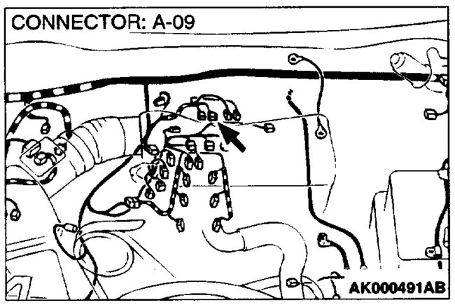

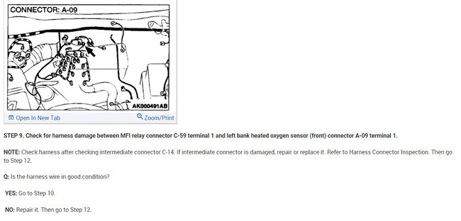

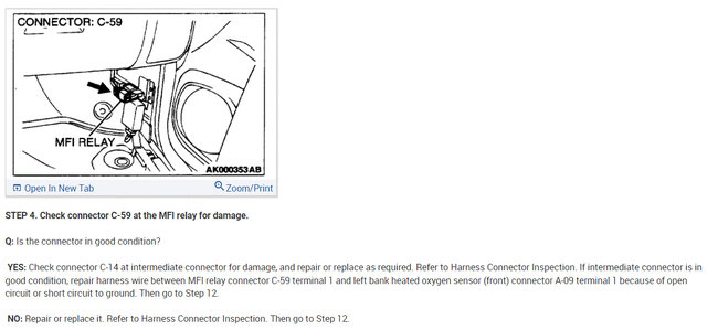

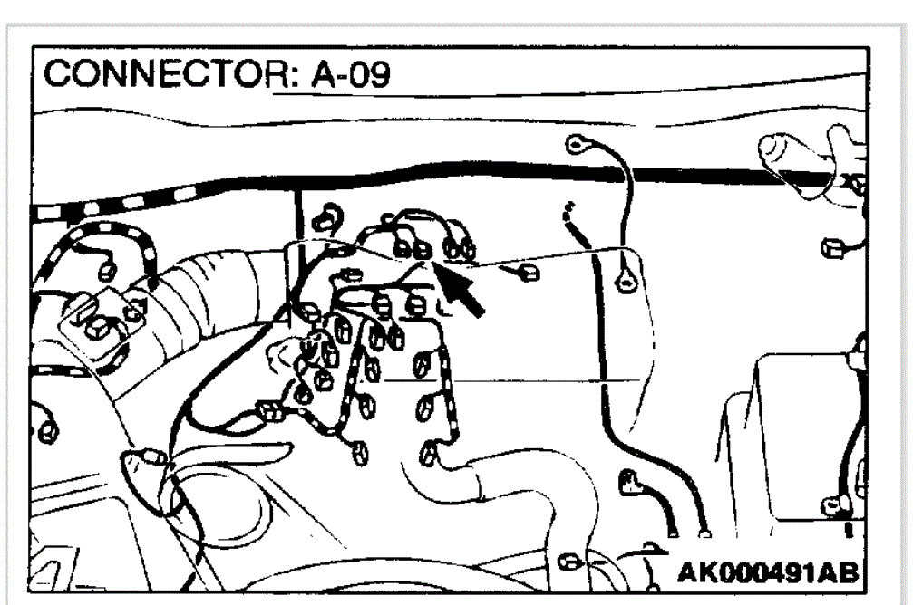

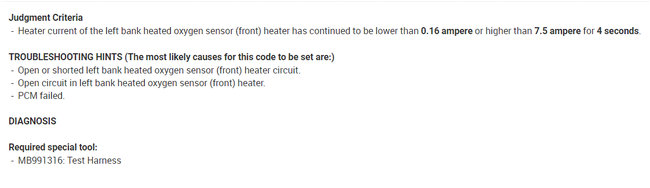

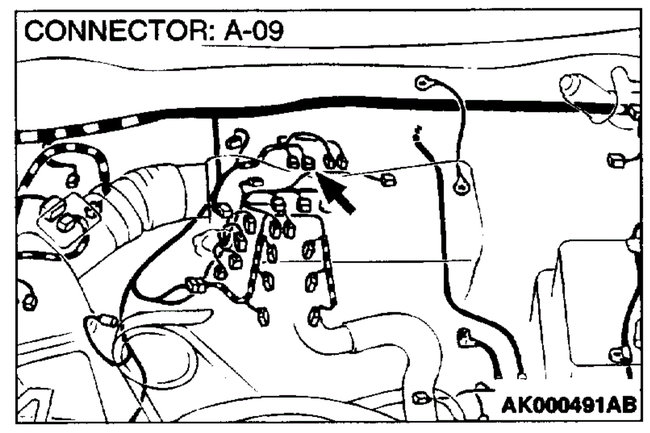

Checking the wiring and the connections is a perfect place to start. If that doesn't help, then we need to move to checking the circuit.
Is the engine running normally? The code indicated there could be a short, an open circuit, or even a PCM issue.
If you look below, I attached the diagnostics specific to this code. Let me know if you are comfortable performing the tests.
Oct 16, 2021 at 4:33 PM
