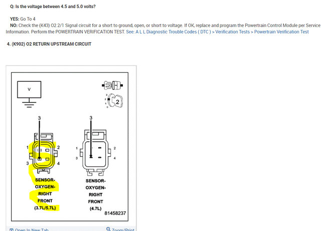

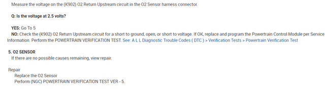

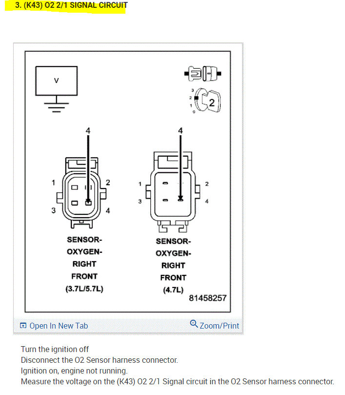

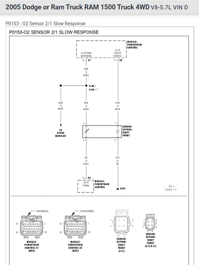

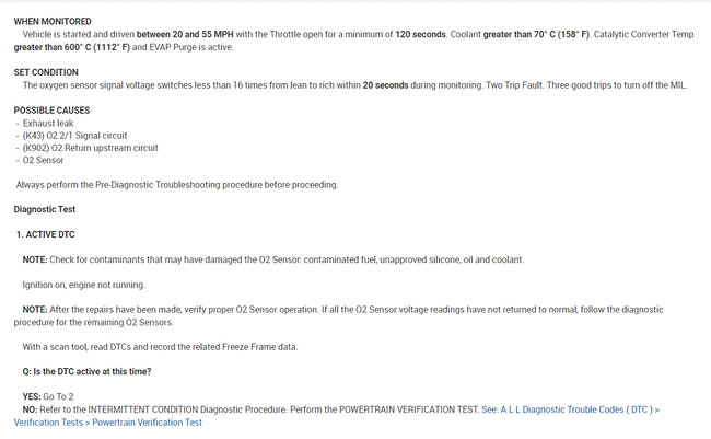

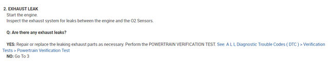

Wow, you have done a lot. Based on what has been done, it is likely a wiring issue. The code indicates a slow response (bank 1 sensor 2), so I suspect excessive resistance.
Do me a favor. I attached the diagnostics for this code below. Take a look through them and let me know if you are comfortable performing them.
Here is a link you may find helpful when testing:
Also, if you have a live data scan tool, hook it up and see how the O2 sensors are reacting and let me know, and check the short-term fuel trims so I know how it's running (lean, rich, or within spec).
