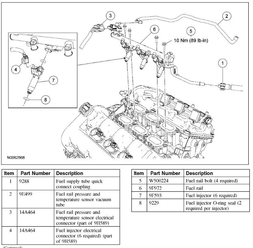

Yep, it sounds like you have a fuel injector that is stuck open. I would remove the spark plugs and one of them will be black and the other will be much cleaner, the plug with the black plug will be the problem, please remove the spark plugs for inspection and upload an image or short video of the plugs so I can see if you have any questions.

Here is how to change out the fuel injector once you find the bad one or two. Check out the images (below). Please upload pictures or videos in your response of any problems so we can see what to help you with.

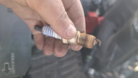

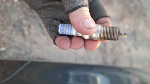

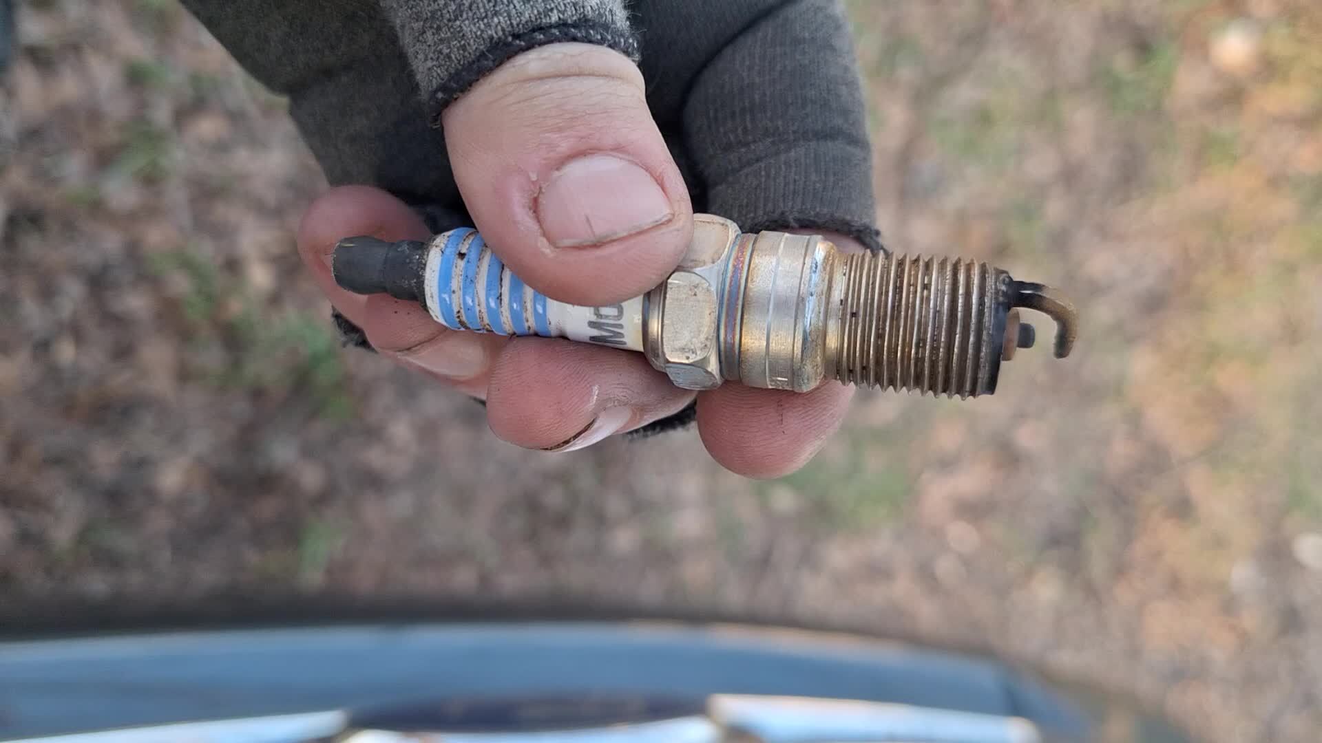

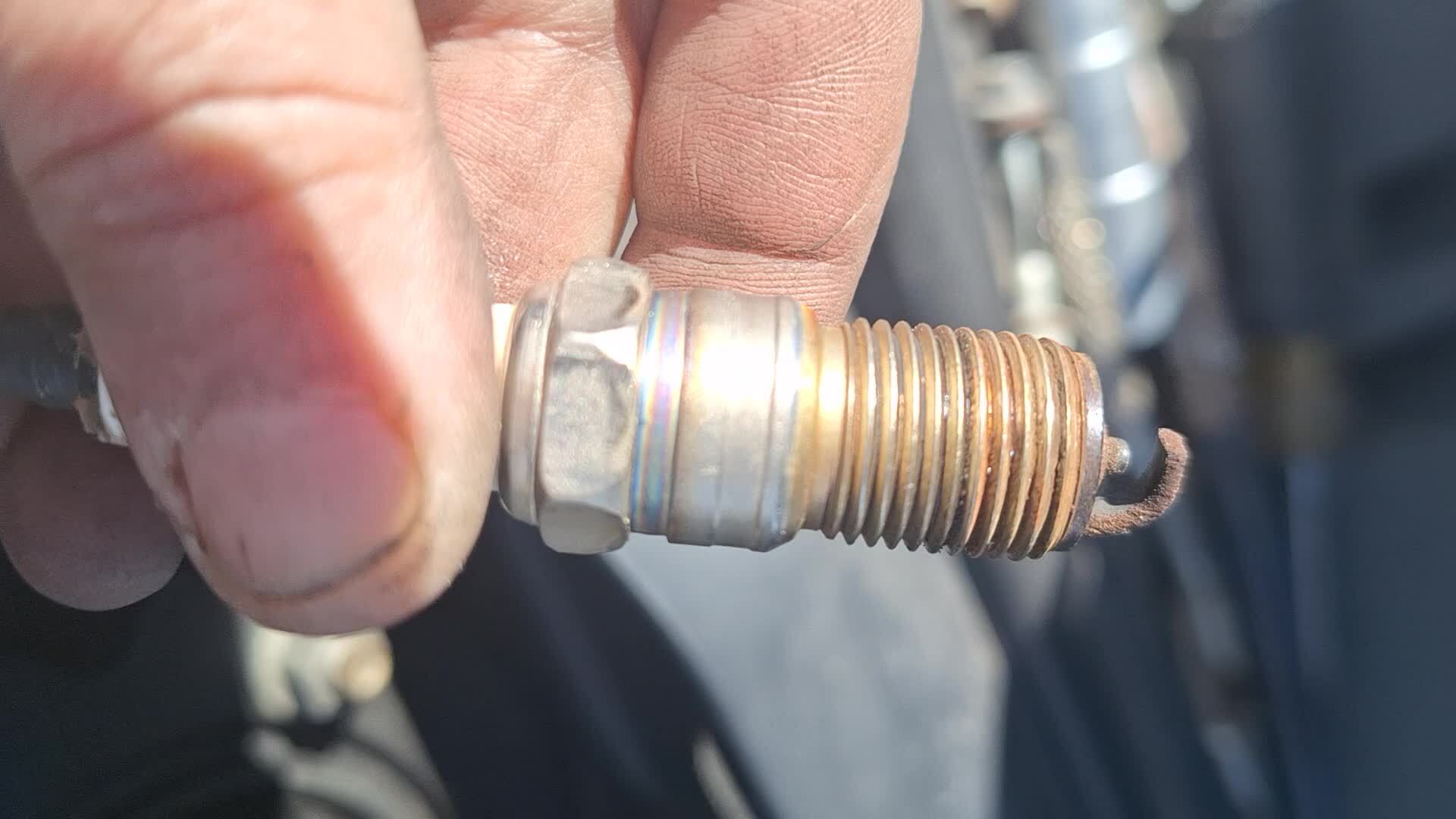

First spark plug from the passenger side.

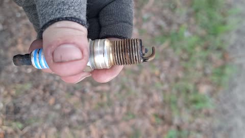

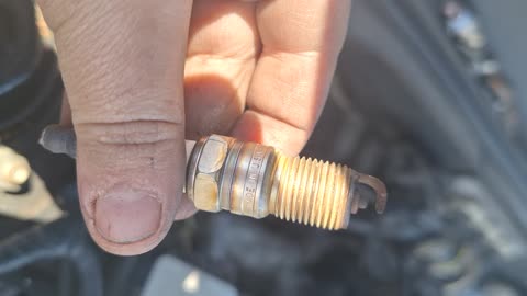

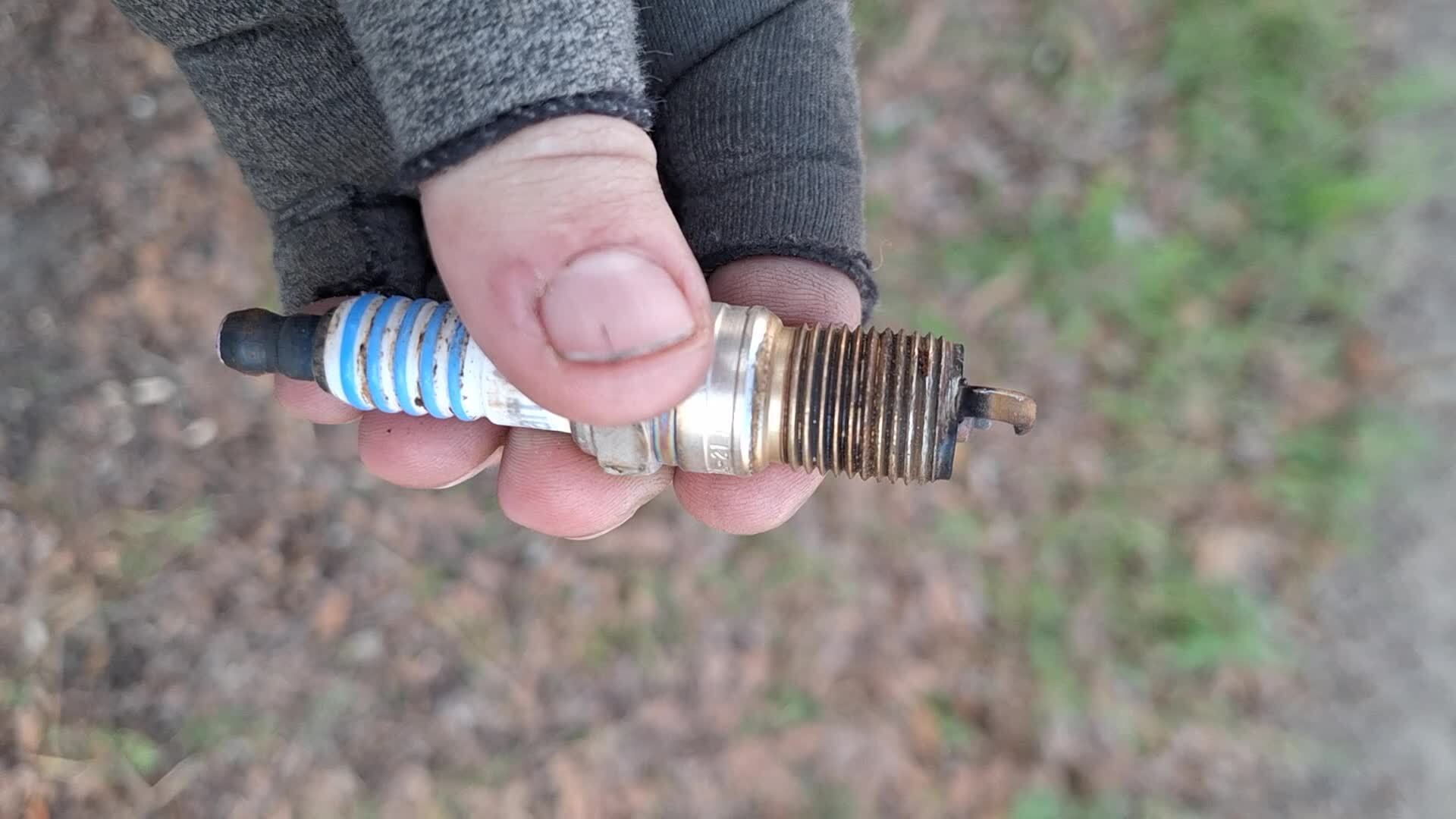

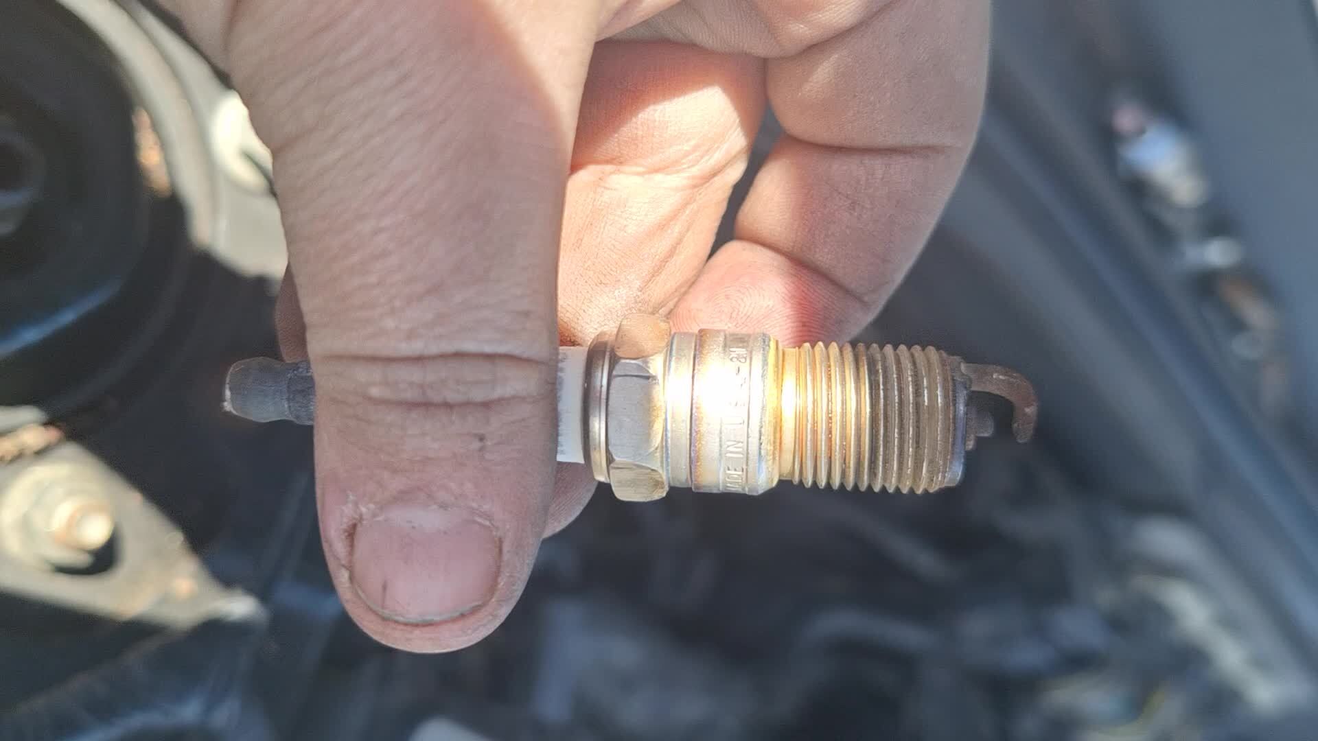

Second spark plug.

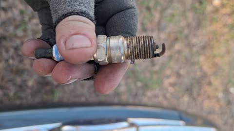

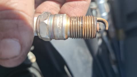

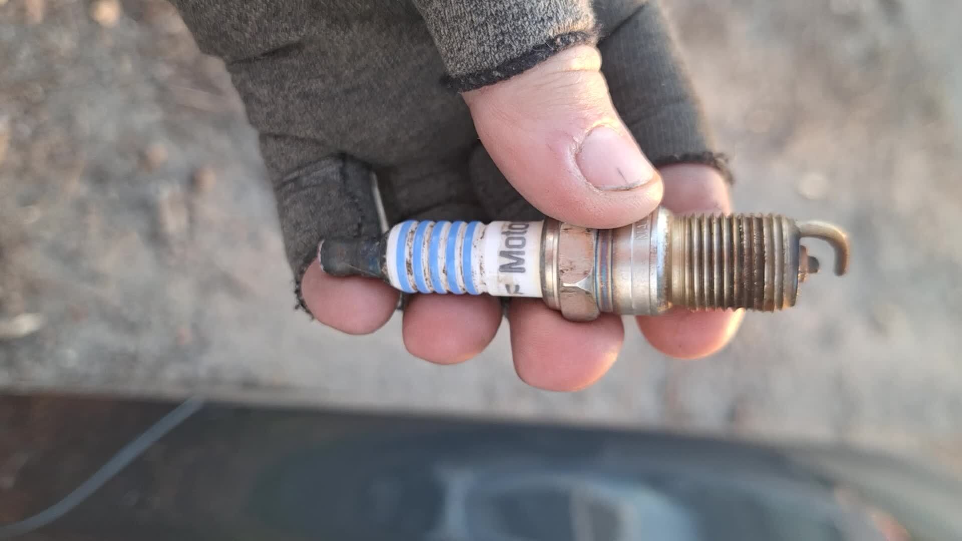

Third spark plug.

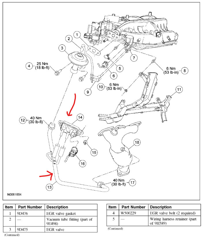

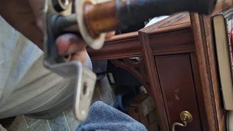

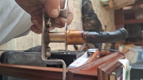

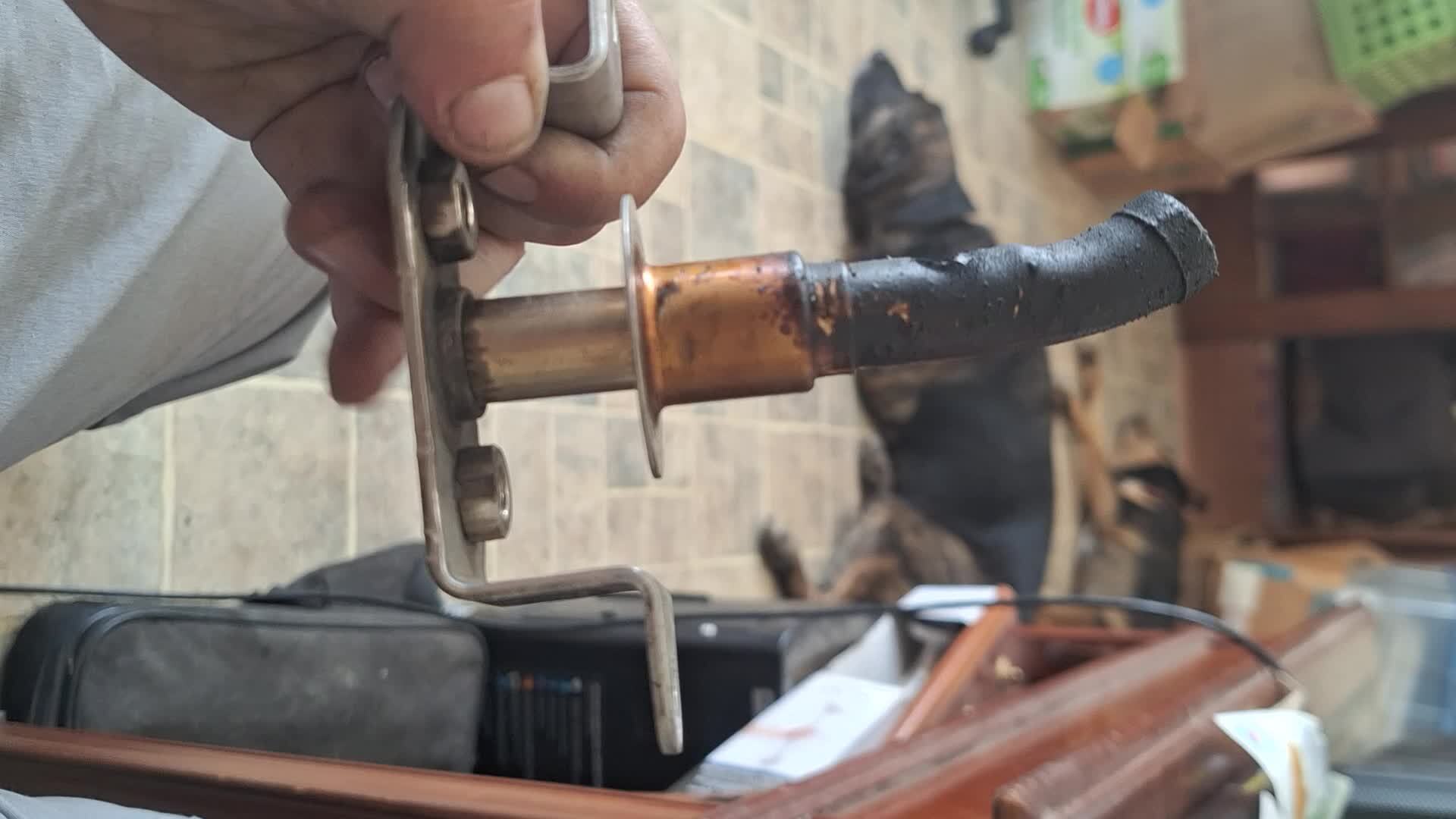

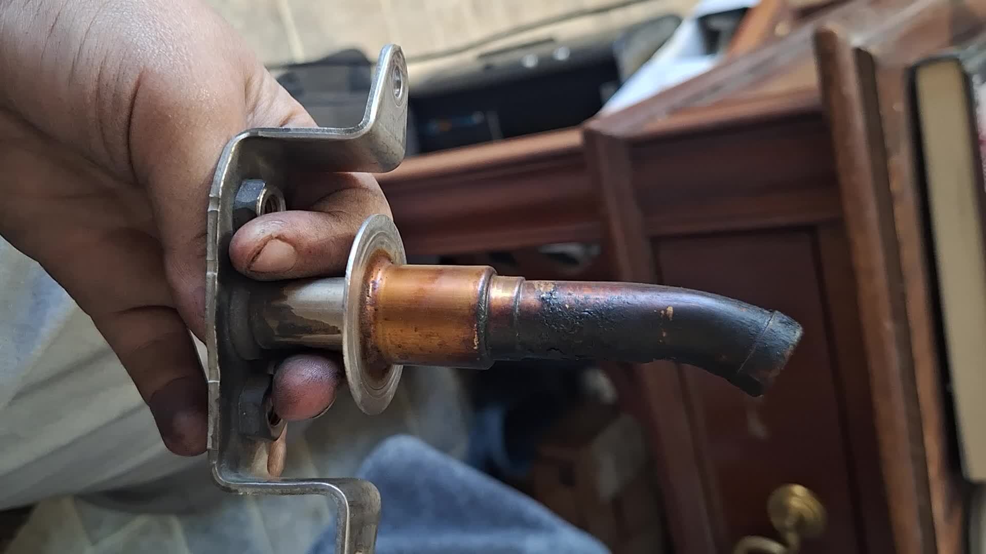

This is the EGR emissions connecting tube flange outlet.

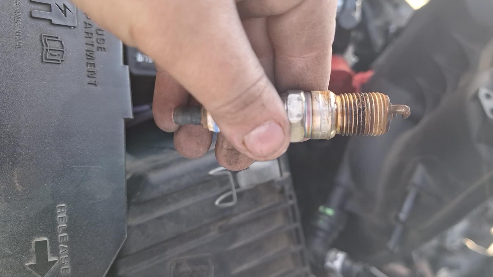

First spark plug from the back.

  • 55,433 POSTS
Thanks for the videos. The spark plugs look good mixture wise, but they are completely worn out and need to be replaced. If the EGR tube is broken this will be an issue, sorry i could not tell from the video. You cannot have any leaks before the primary oxygen sensors. I like the doggies! Check out the images (below). Please let us know what happens.

I checked out the ignition coils and they looked good. I just put in the new spark plugs and put boot lubricant on.

  • 55,433 POSTS
Sounds good, thanks for the video of the EGR tube. It does look broken and there can be no leaks, so we need to repair/replace that as well.

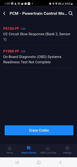

I replaced the EGR tube today. I cleared the PCM module. Ran through another entire system scan and I am still getting a PCM code, 4x4m control module, and now an ABS code. The ABS and 4x4 code is U0401-20 Invalid or missing (CAN) data from the (PCM). The PCM code is P1000-FF On-board diagnostic (OBD) systems readiness test not complete.
Mar 12, 2025 at 9:12 AM
  • 55,433 POSTS
Please start a new thread for the ABS and 4x4 codes, on the p1000 means you need to keep driving it because the monitors have not set.

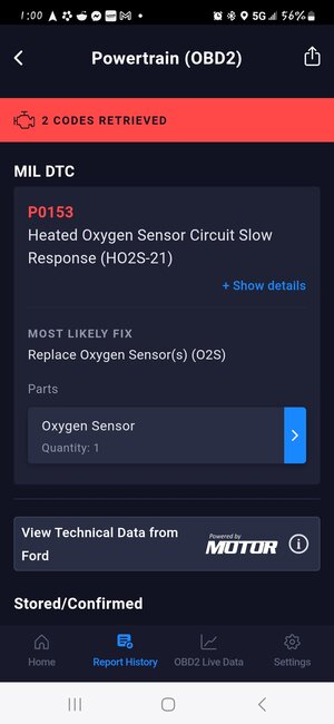

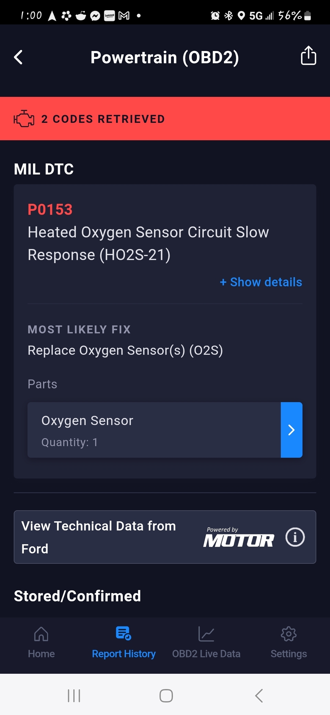

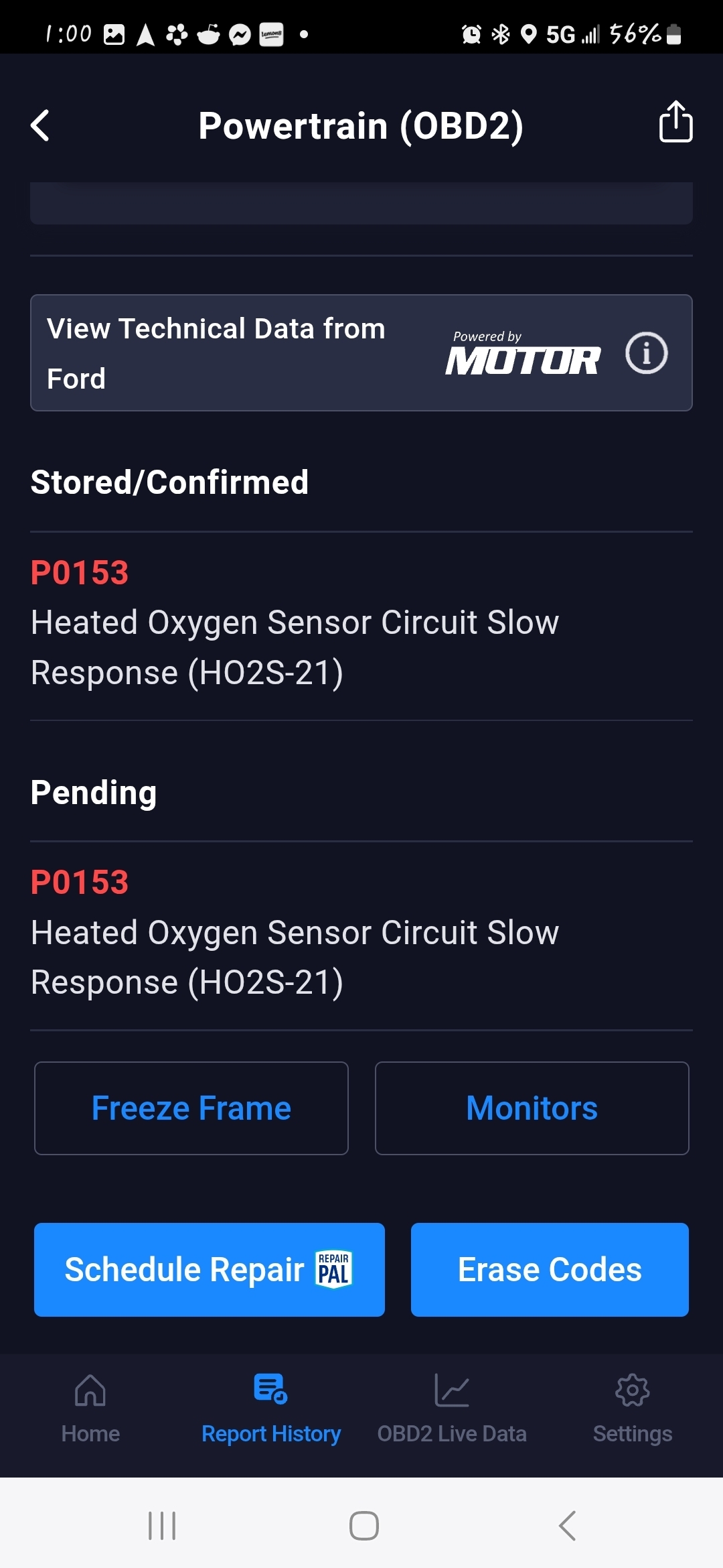

I was driving to Macon for an appointment and the check engine light came back on. Scanned it and this is what came up.
Mar 14, 2025 at 3:02 AM
  • 55,433 POSTS
Since you didn't have the code before you changed the sensor, I would say it is defective, I would get another one and then clear the codes.
