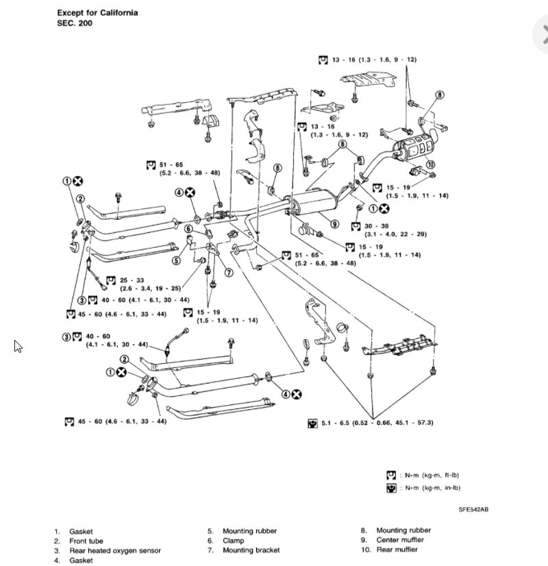

VG33E QX4 (also Nissan Pathfinder). I am looking for help trying to decide if the Bank 2 Sensor 1 Oxygen Sensor should be replaced, or if the code could be caused by something else?
Symptoms are; poor fuel economy (13mpg/Hwy), and a strange "cold weather/hard start" problem that gets worse as the outside temperature drops.
I've read that these VG33E 3.3L V6 engines often have a grounding or electrical connection problem with the Oxygen Sensors.
Also, possibly could be incorrect fuel pressure, bad fuel injectors, intake air or exhaust gas leak, or even Cam/Crank Sensor problem?
I have some OBDII Live Data/Freeze Frame readings other than the P0151 code which seem to me to be wrong, but not sure - I'm definitely not a mechanic:
Spark Advance Degrees: 63.5
SHRTFT2: .8
LONGFT2: -3.1
Should I just have that O2 Sensor replaced and see what happens?
Thanks in advance for any ideas or suggestions!
Oct 14, 2020 at 3:38 AM
The easiest way to determine if this is one o2 sensor is to just swap it to the other side and see if the short term fuel trims switch banks. So compare it to the other side and then see if they change. However, with your short term and long term being where they are, that doesn't appear to be an issue. The numbers are where they are supposed to be so unless the is an issue like what you are describing the sensor would appear to be fine.
With that being said, we need to step back and see what the fuel pressure is when you say it is low. Did you check it and if so, what is the PSI at key on and then while idling?
https://www.2carpros.com/articles/repair-lean-mixture-codes-p0171-or-p0174-on-some-manufacturers
Check out the diagrams (Below). Please let us know what you find. We are interested to see what it is.

The code is P0151. I've been reading up on it, and with the (certain years V6) VG33E Nissan/Infinity engines, there is a Technical Service Bulletin issued because of a lot of grounding issues with the O2 sensors. I can post that Service Bulletin (and all the years/vehicles) it pertains to if you'd like, but I found a much easier (and much cheaper) alternative solution on YouTube. Can I post YouTube videos on this site?
This grounding problem should be checked and/or completed prior to replacing any O2 sensors, from what I understand.

Kenny: Success! The new DIY ground cable did the trick. The P0151 code cleared immediately, I didn't even have to clear it with the code reader. I have now cleared the old data (Codes, Live Data and Freeze Frame Data). I will drive it a while and recheck codes, mileage etc., to see if the issues are totally cleared up. I do suspect something else might be going on as I had some weird (to me) numbers on the OBDII reader. I'll post back in a couple of days and elaborate. Many thanks for sticking with me while sorting this out.
