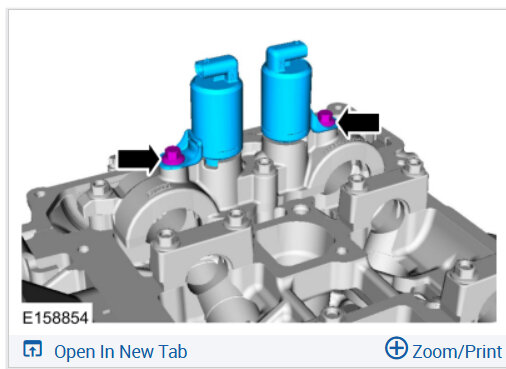

Yep, the ole P0149A code. This means the timing chain system, camshaft position actuator is not working correctly, It could be the engine needs oil, or the oil and filter need to be changed. If the engine has fresh oil in it then you might want to look at the camshaft oil control valve which can be clogged or no longer working, here is the location so you can check it out.
P0149A : Camshaft Position - Timing Over-Retarded (Bank 1)
Remove the oil control valves and look at the screen at the end of the valve. Check out the images (below). Please upload pictures or videos in your response.

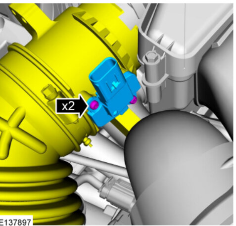

I am so sorry for the confusion man. The code is not what I said it was. The code is p219a. I replaced the O2 sensor with another one, but the code did not clear itself. I erased the code to see if it will pop back up. With this code, what do you think it could be?. Just to recap, I replaced the O2 sensor with a p0131 code and then afterwards I got the p219a code. What's your thoughts on it?
May 15, 2025 at 4:12 AM
  • 55,065 POSTS
Np, if car repair was easy everyone would do it lol. The code
P219A - Bank 1 Air/Fuel Ratio Imbalance
Which means the system is lean and the reasons for this is the MAF needs to be replaced or there is a vacuum leak, here is a guide to help you8 and the MAF location so you can swap it out, do not clean it, it will not help, once the sensor has gone bad it needs to be replaced.
The p0131 code is for the sensor heater so it is not related to the mixture problem.
https://www.2carpros.com/articles/repair-lean-mixture-codes-p0171-or-p0174-on-some-manufacturers
We just made this video for finding intake leaks.
https://www.youtube.com/watch?v=LRKWV4Are5c
Check out the images (below). Please let us know what happens. Make sure the intake boot is connected correctly.
