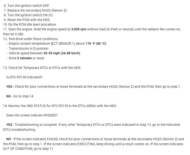

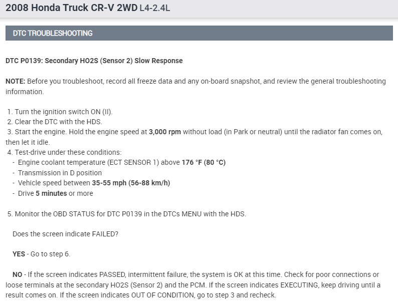

The code P0139 can get triggered due to faulty connector to the sensor as well as wiring issue. Sometimes the PCM will need to be reset in order for this code to go away.
I have attached the diagnostic steps for the code P0139 below. Follow those steps as it can help you determine the issue.
Let me know of any questions.
