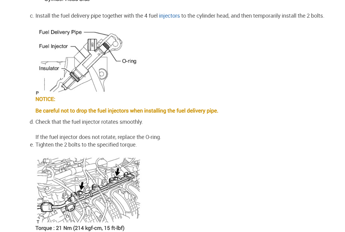

Changed O2 Sensor and my mechanical checked wiring, exhaust leak and fuel injectors. Still the same code is coming. Also, after checking the fuel injector the fuel goes down fast which i can see which driving even 10 miles.

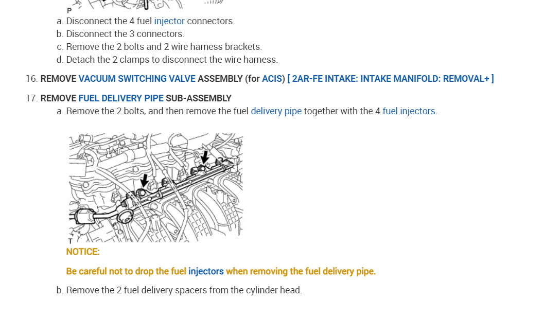

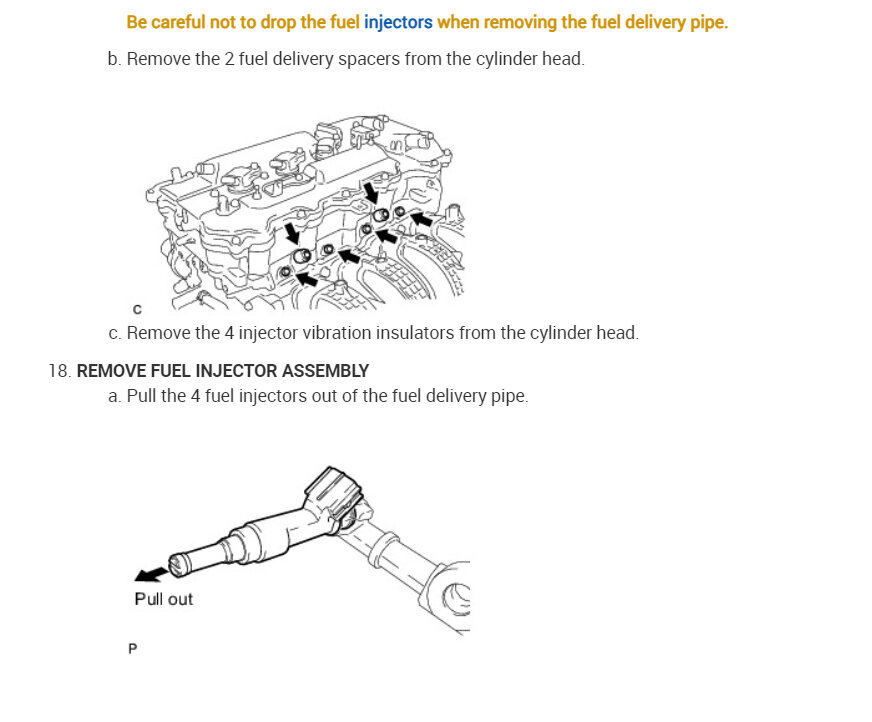

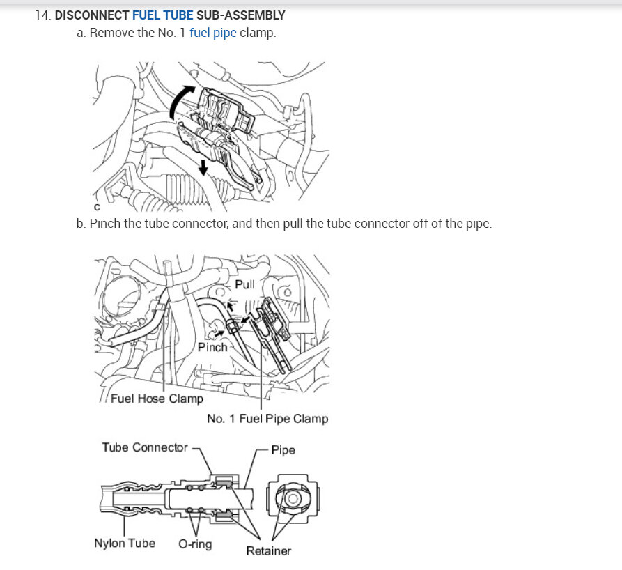

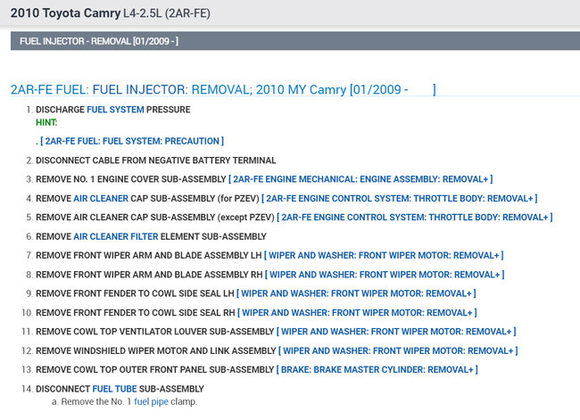

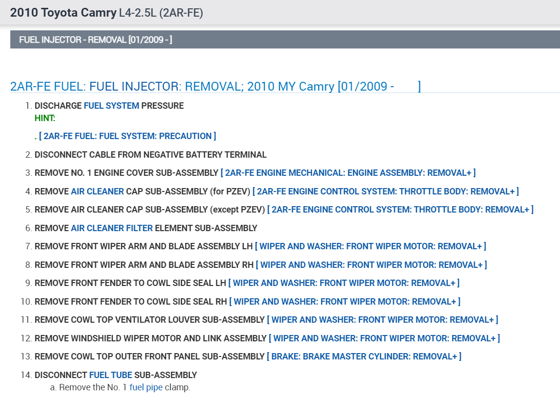

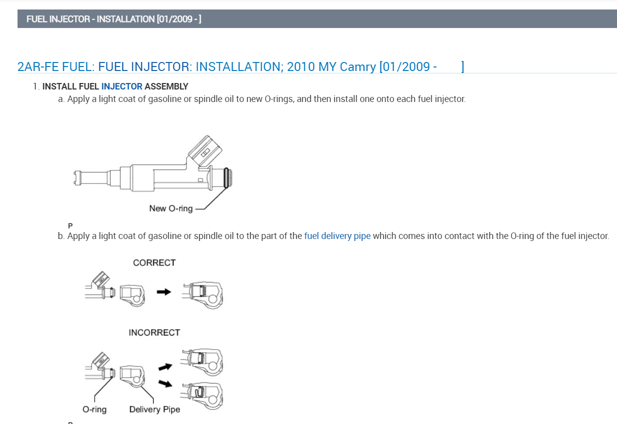

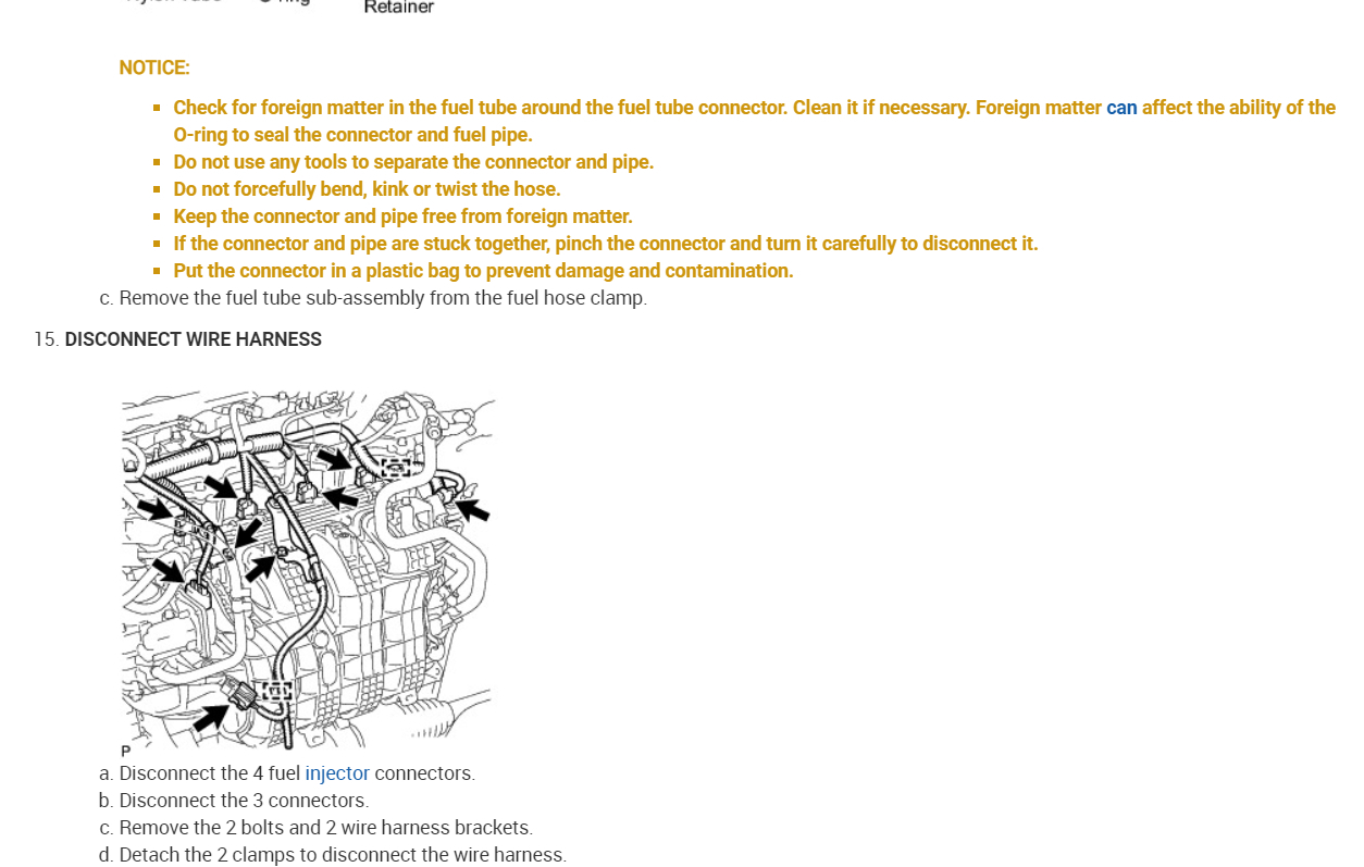

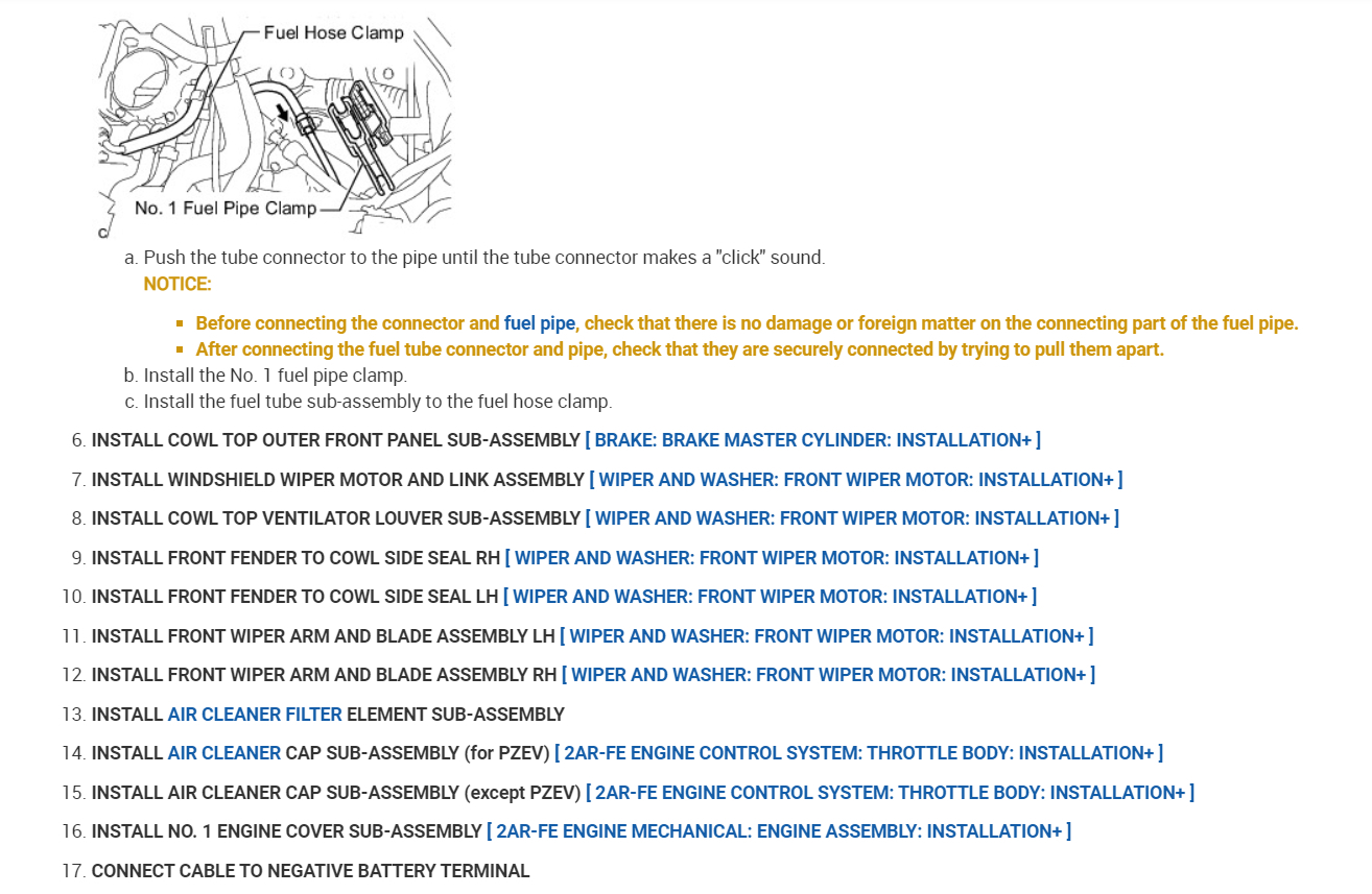

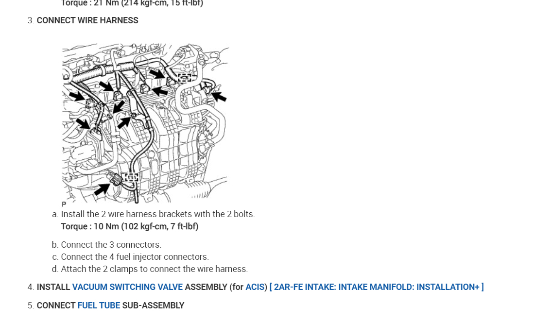

So, these codes can come up if you have a bad fuel injector, I would remove all spark plugs to look for the one that looks different from the rest. This will be the cylinder that needs to injector replaced. Here is a guide to help with the spark plugs and instructions in the images below to help with the fuel injector:
https://www.2carpros.com/articles/how-to-change-spark-plugs

Thank you for your suggestion. i have changed all fuel injectors and the problem remains the same as check engine light P0136 and P0138. but now the miles per gallon have increased. Do you have any suggestions?

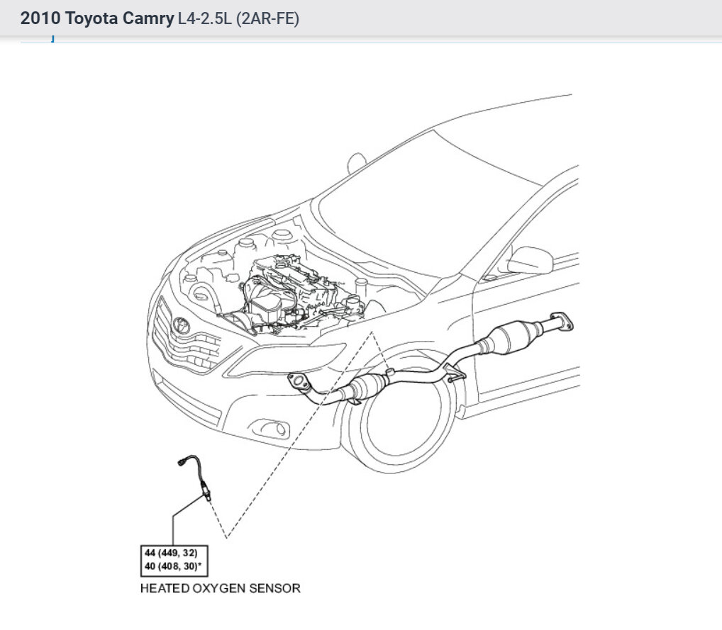

Did you clear the codes once the repair was done? How does the engine seem to run also did you change out the spark plugs as well and if so, how did they look? Also, I would change out the bank one sensor 2 to see if that helps, the bad injectors could have ruined the sensor.
This guide can help walk you through the steps and I have included the sensor location below:
https://www.2carpros.com/articles/how-to-replace-an-oxygen-sensor

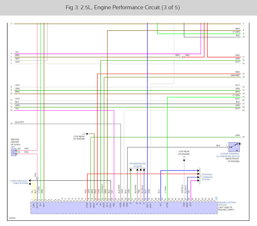

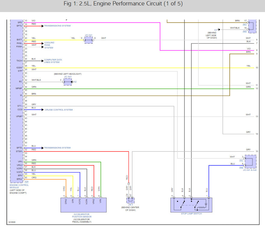

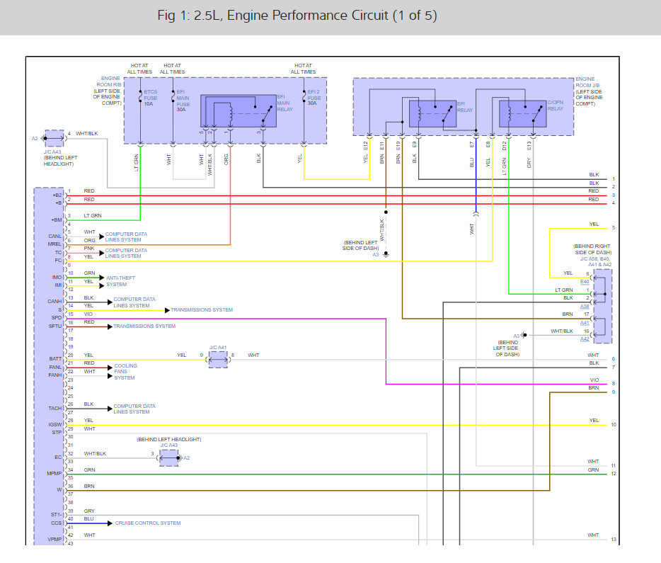

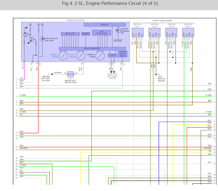

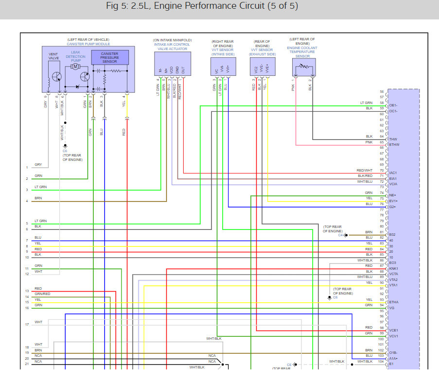

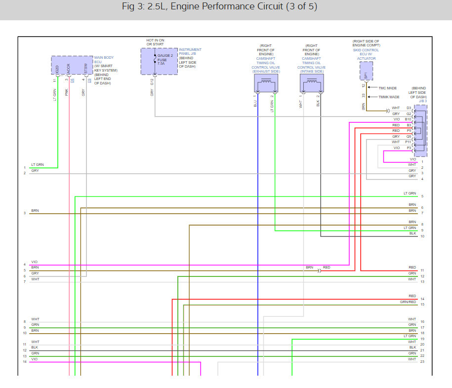

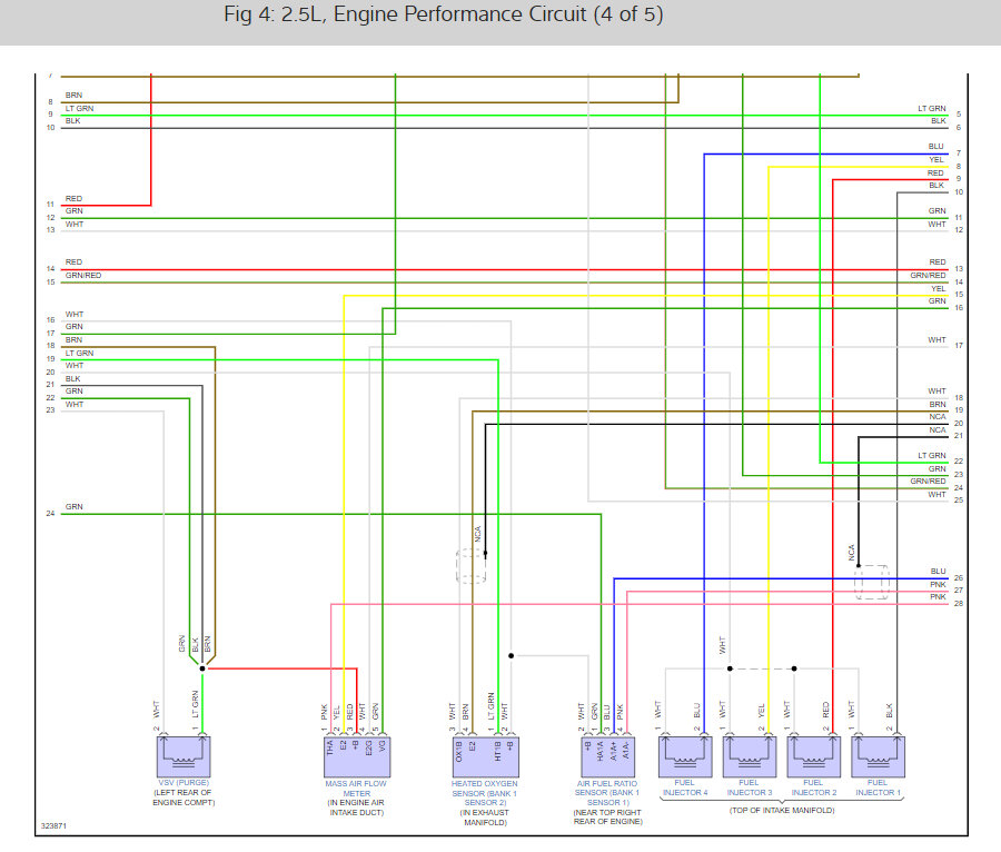

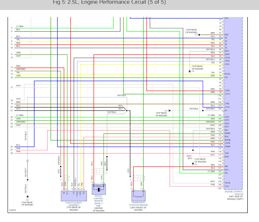

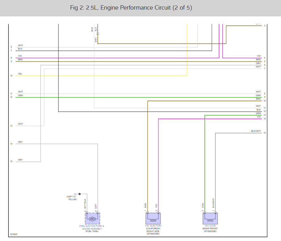

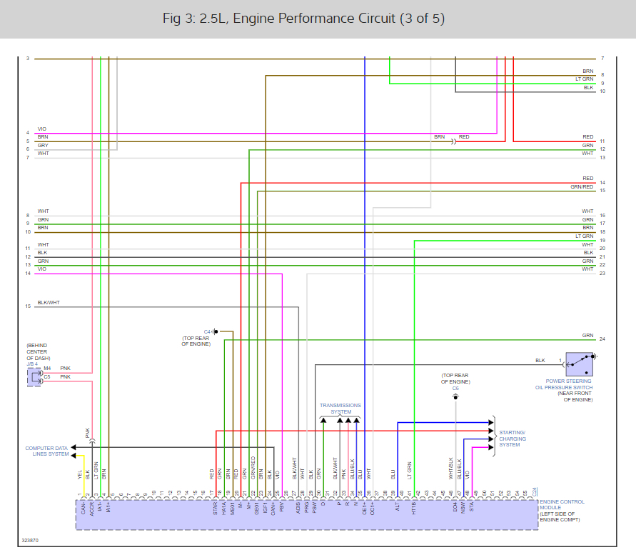

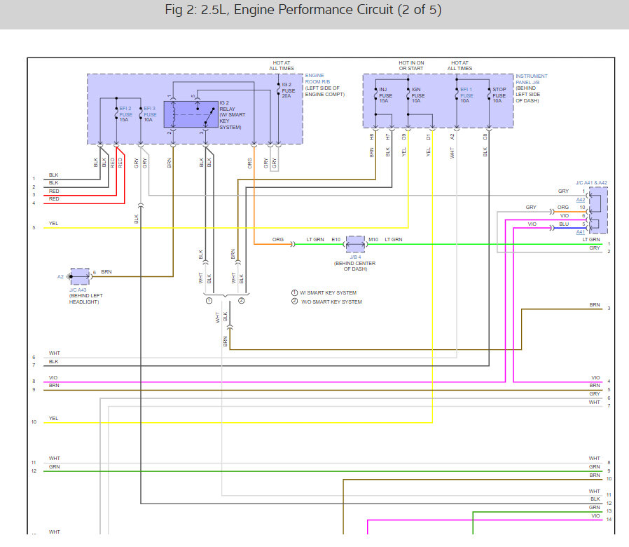

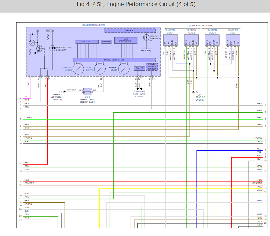

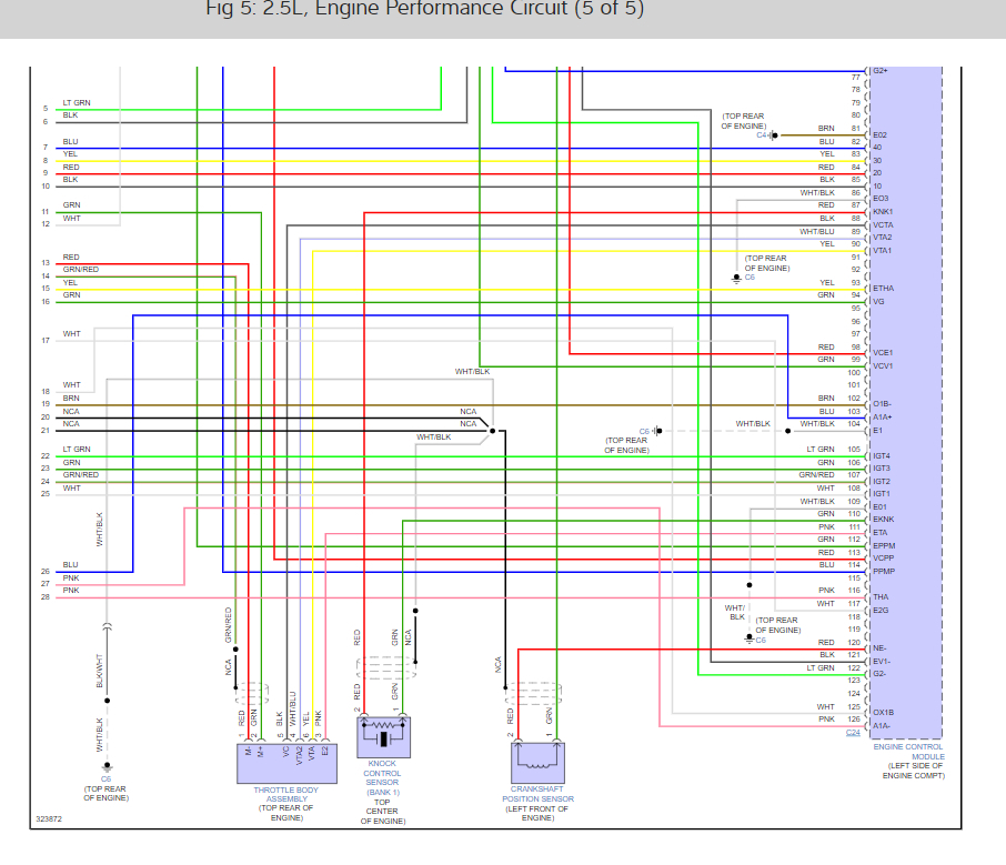

P0136 Code - O2 Sensor Circuit - Bank 1 Sensor 2. We should check the wiring to the sensor because it sounds like the PCM might be bad.
Here is a guide to help and the wiring diagrams to help you as well:
Jan 7, 2023 at 3:01 AM
