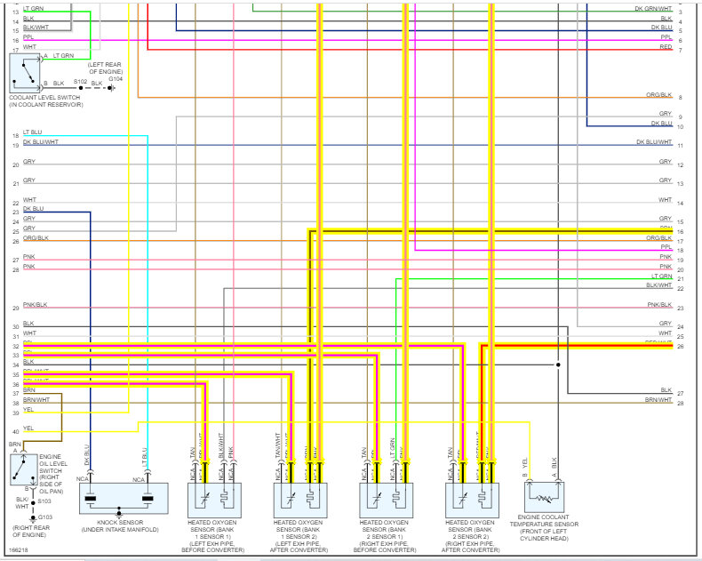

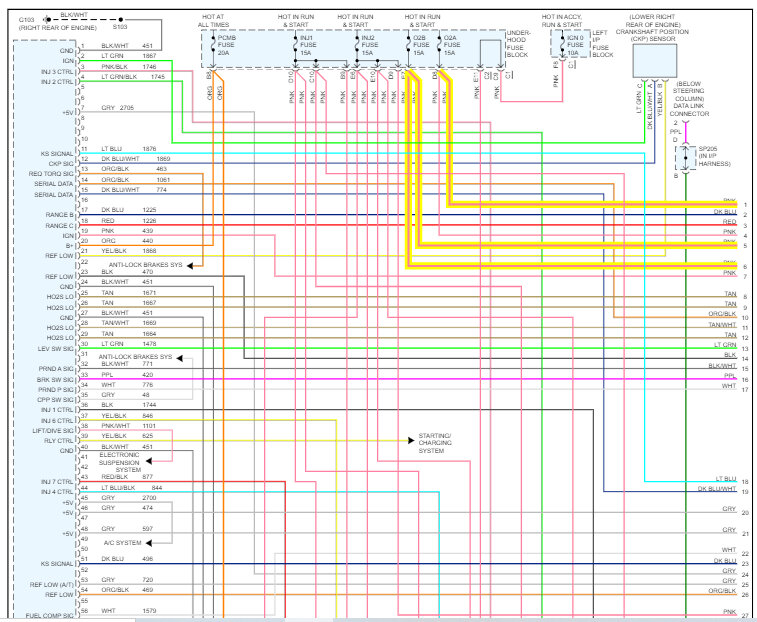

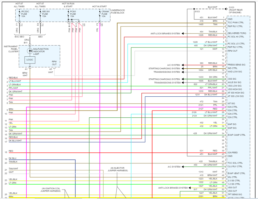

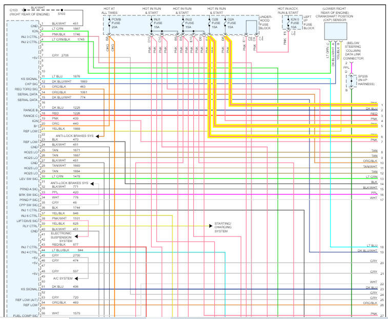

codes P0135 and p0154, upstream o2 sensors?
160,000 MILES • 5.3L • V8 • 2WD • AUTOMATIC
DAYSTEVE40

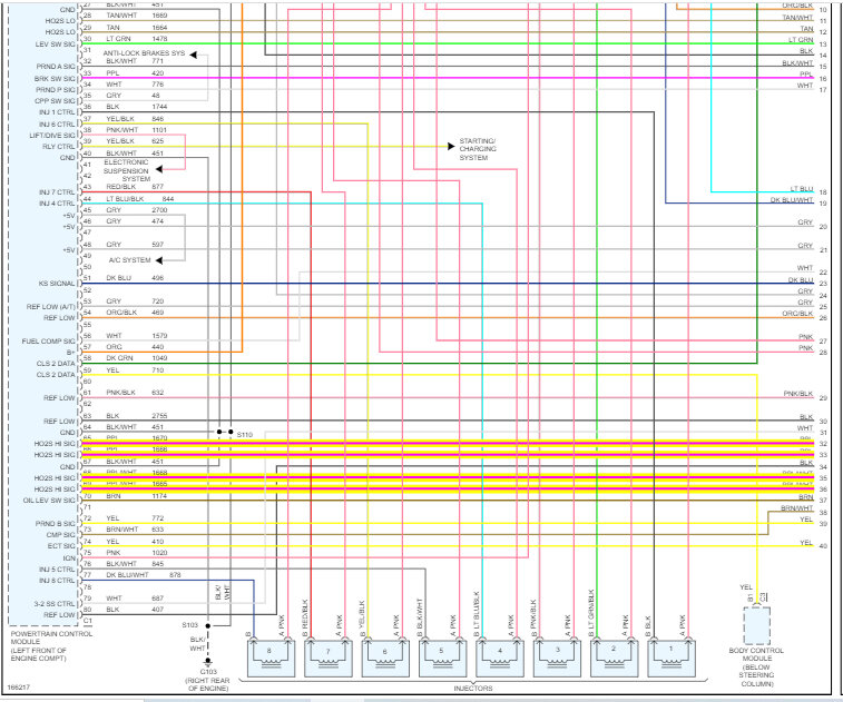

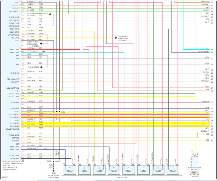

I need to know what pins on the connectors and the pins on the ECM. I need to check and test for wiring problems with the upstream o2 sensors.
Dec 17, 2022 at 5:00 PM
  • 110,248 POSTS

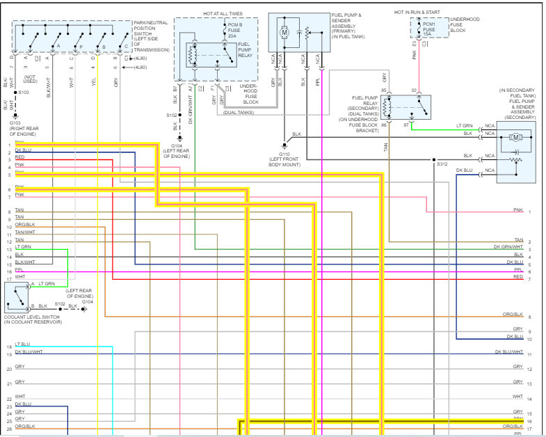

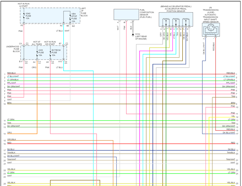

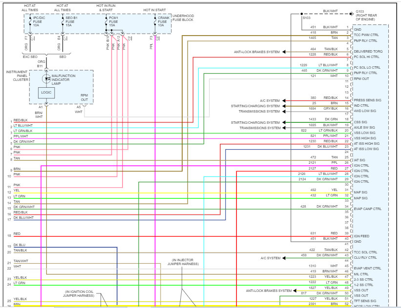

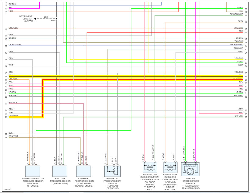

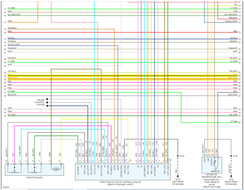

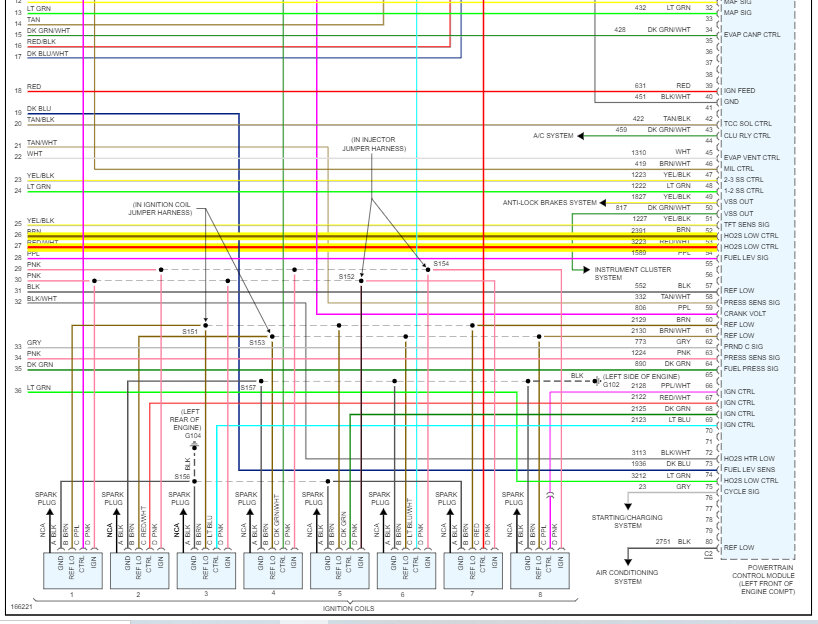

I attached the entire wiring schematic for the powertrain management circuits. I highlighted all wiring related to the oxygen sensors.
Take a look through the schematic and let me know if this helps or if you have other questions.
See pics below. Note: The schematics were 5 pages long. I cut each page in half to make them readable for you. I also overlapped them so you can follow from one to the next.
Dec 18, 2022 at 5:41 AM
