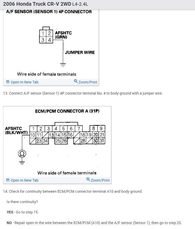

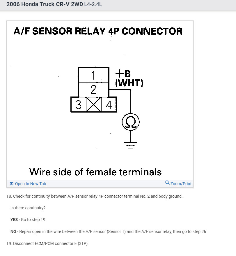

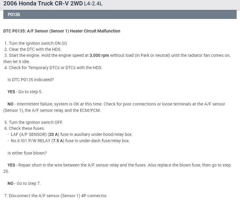

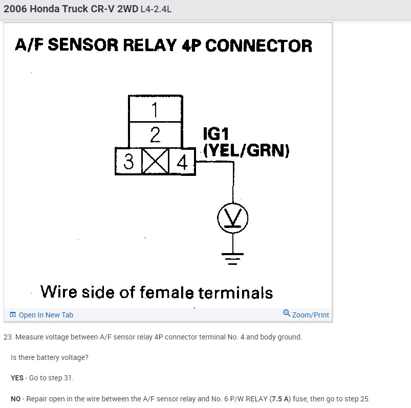

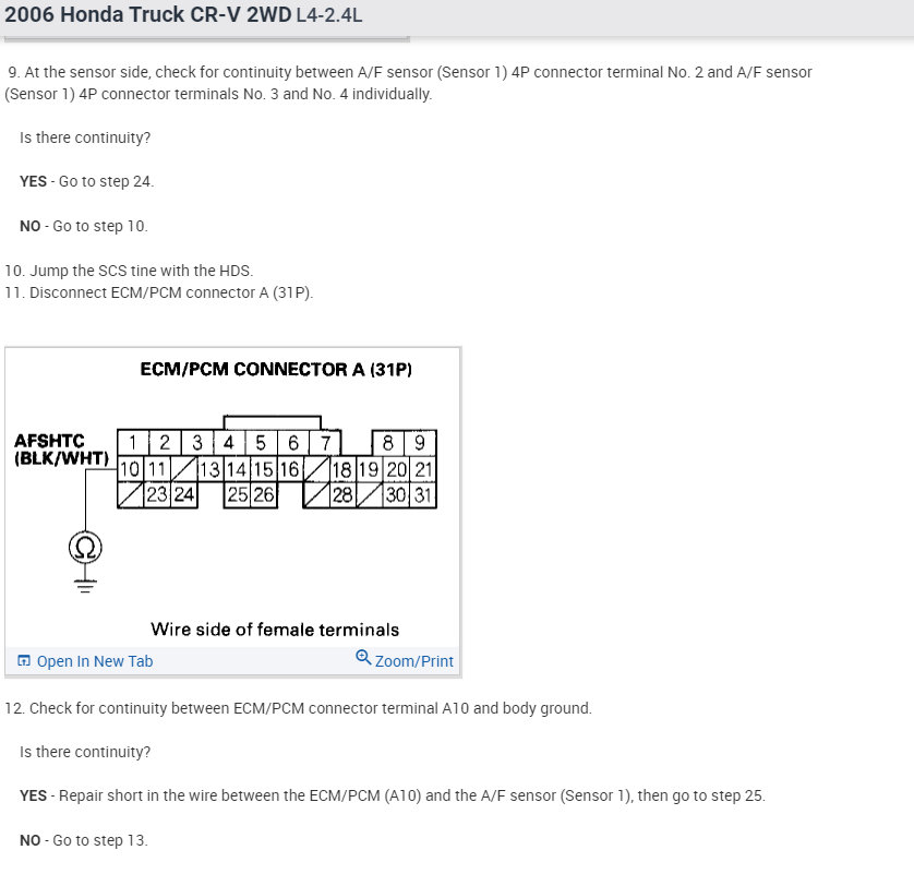

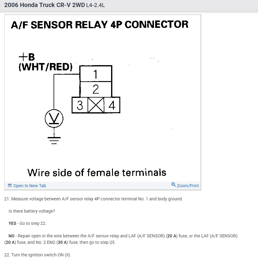

The code is pointing to the primary oxygen sensor. Now it could be due to a bad sensor or an issue with the wiring. Since the wire was ripped out it is possible that there is damage to the harness for the oxygen sensor.
So yes, it is possible the issue is due to the theft as something was damaged due to it, however it might be difficult to prove it.
Driving with an oxygen sensor code is not necessarily damaging to the vehicle. However, it can impact fuel efficiency as well as emission.
So, this will not pass emission inspection.

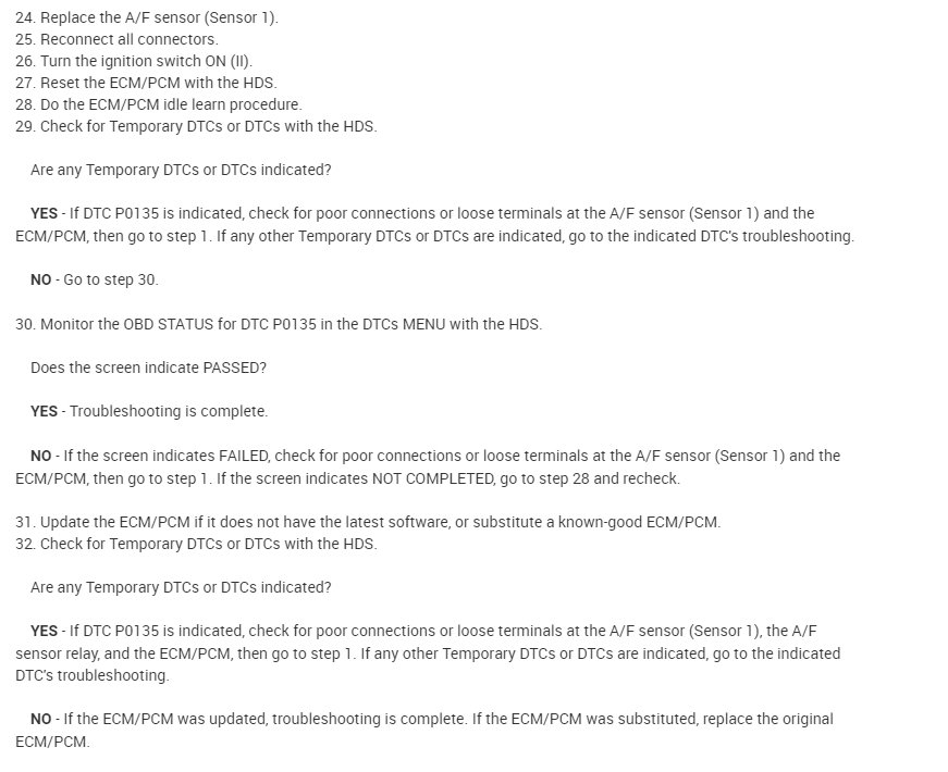

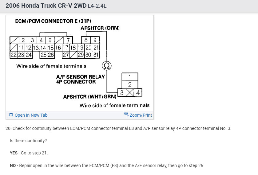

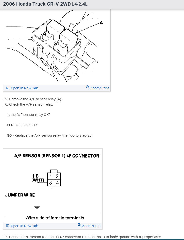

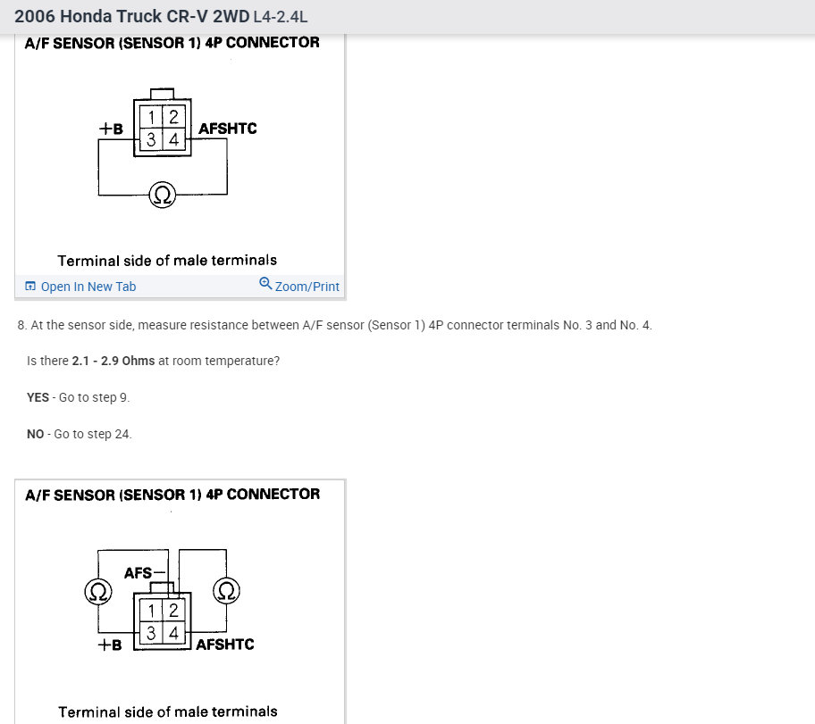

I have attached the diagnostics procedure below for the code P0135 below.
