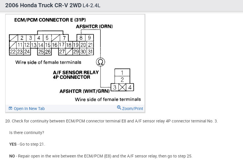

After having my catalytic converter and two O2 sensors replaced (they had been cut out / ripped out and stolen), both the Check Engine Light and the Orange Triangle/! Light will not stop shining. The mechanic hooked it up to their computer and a P0135 code is the result.
Prior to the damage from the theft, my CRV was in perfect working condition. There was no evidence of any sort of pre-existing malfunction. I did drive it after the theft because i could not leave it where it was and, also, to drive it to the mechanic. All told, i put fewer than thirty miles on it before it was repaired.

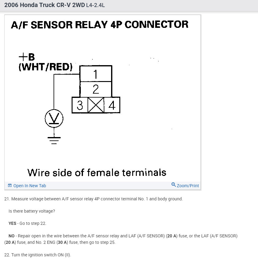

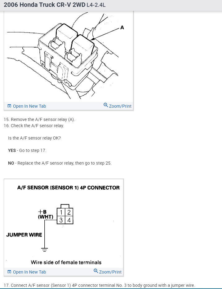

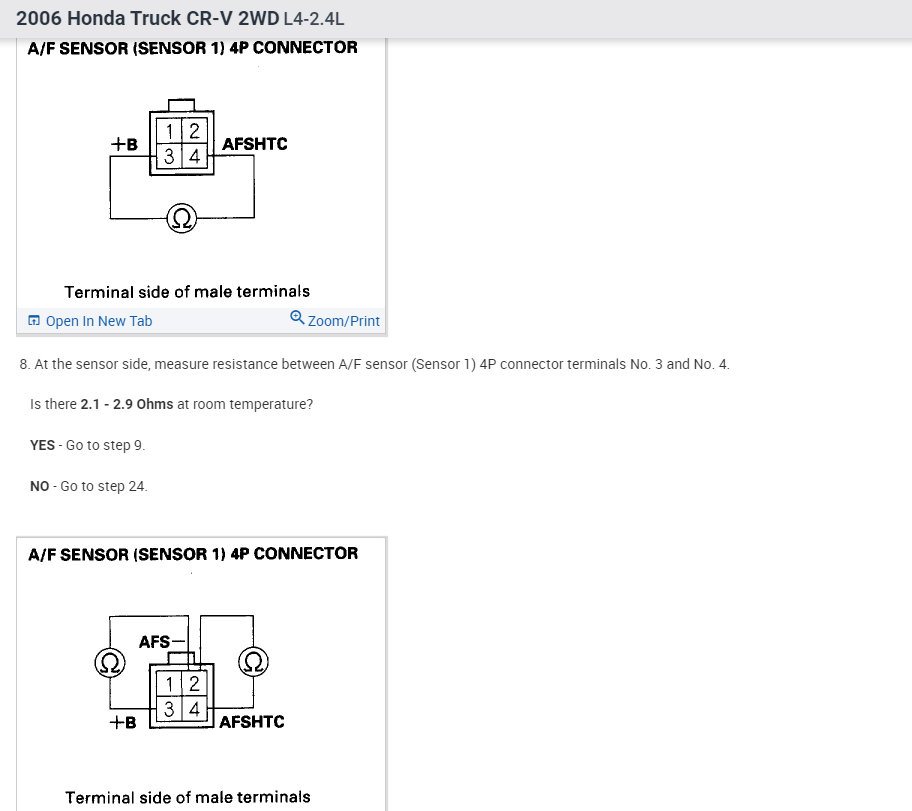

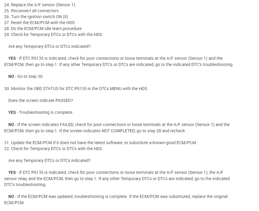

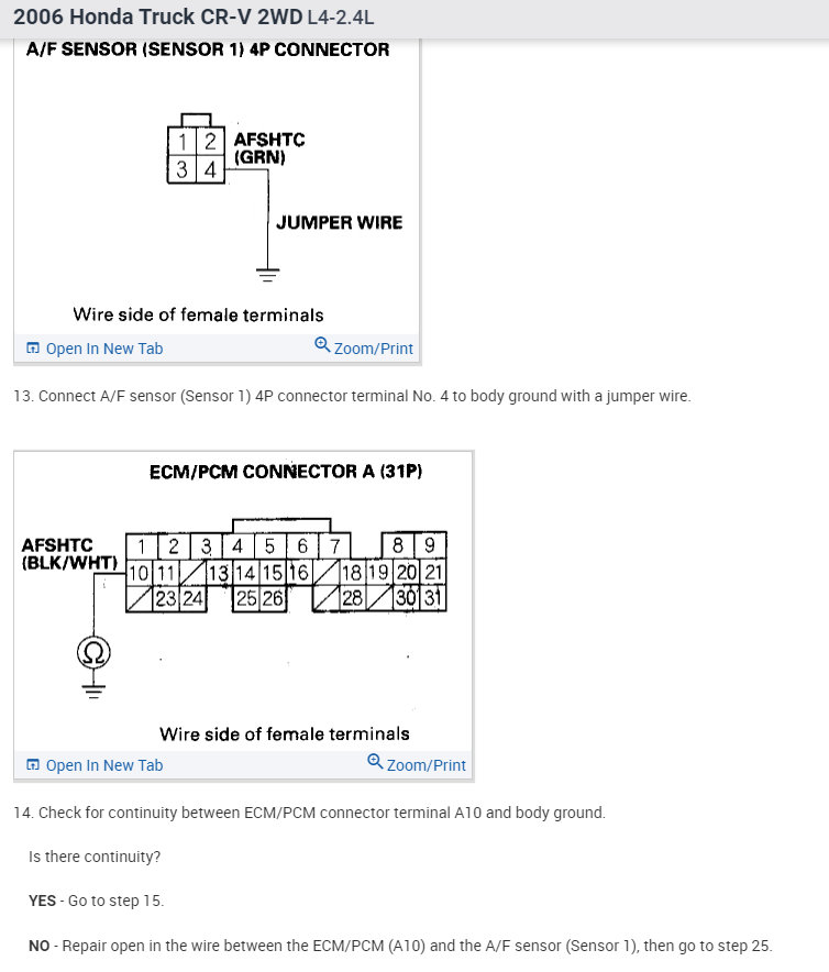

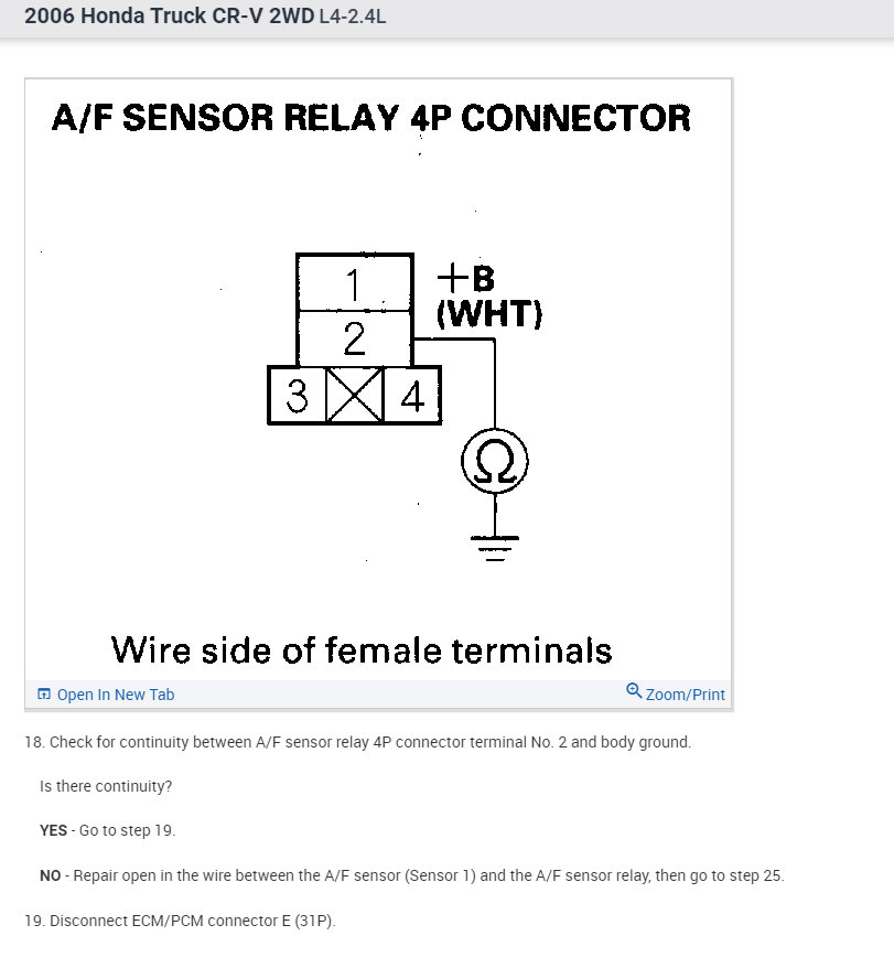

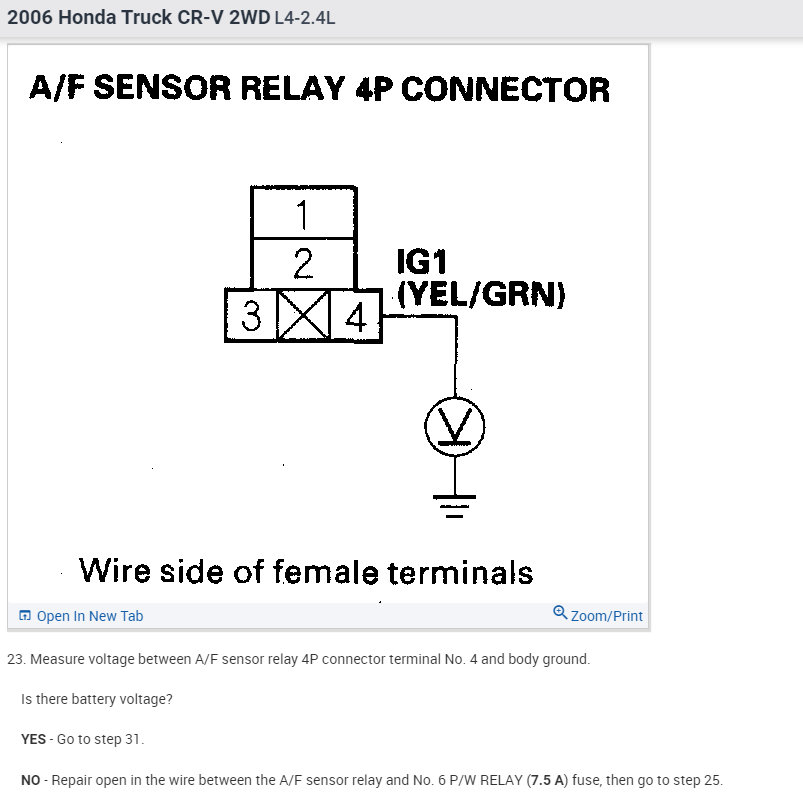

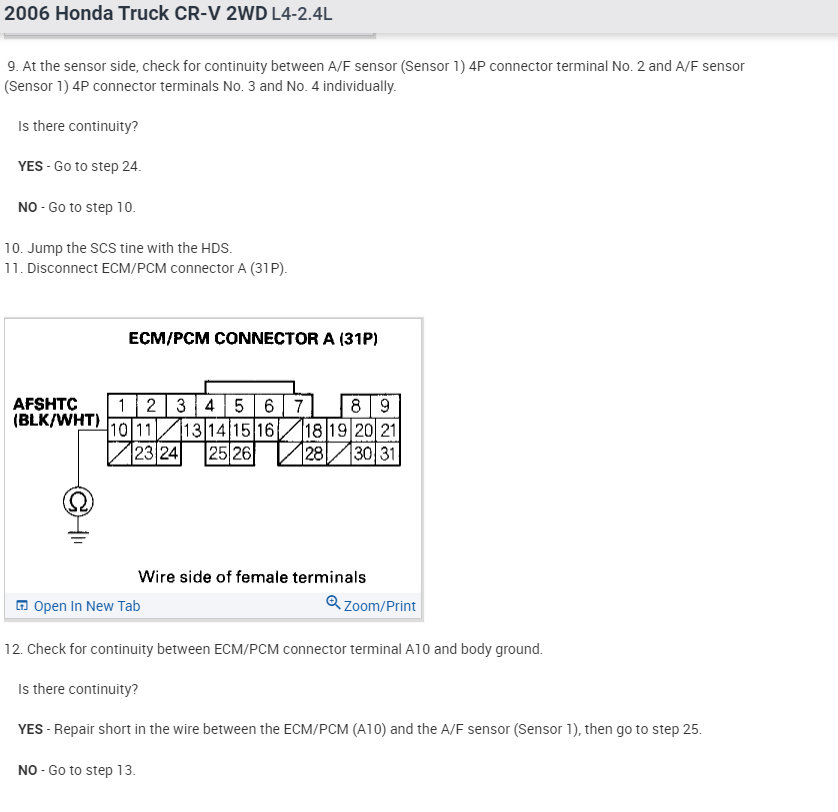

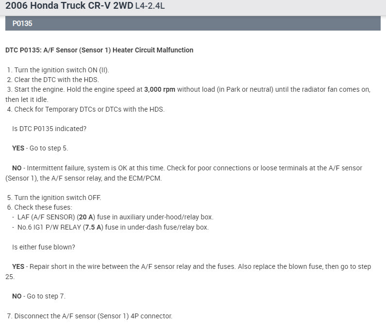

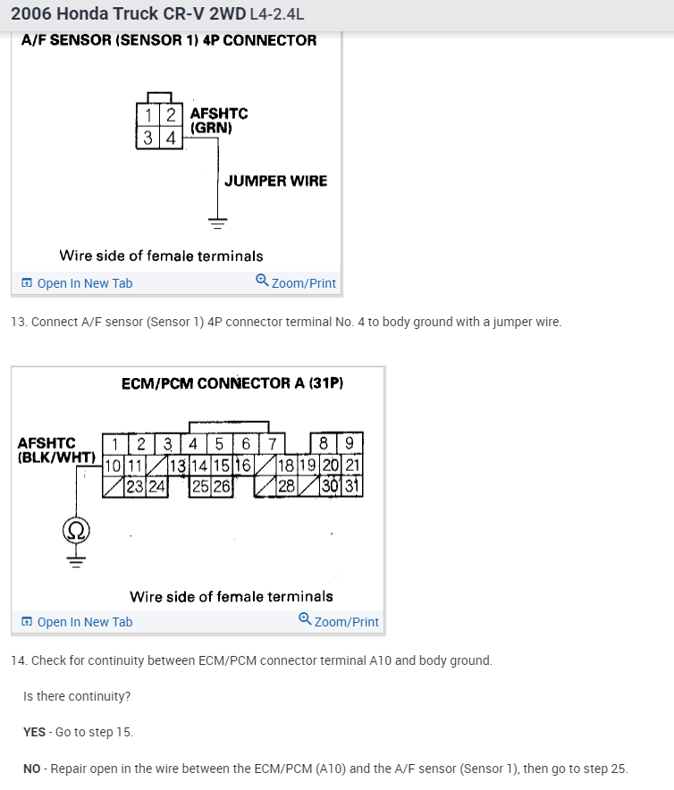

The code is pointing to the primary oxygen sensor. Now it could be due to a bad sensor or an issue with the wiring. Since the wire was ripped out it is possible that there is damage to the harness for the oxygen sensor.
So yes, it is possible the issue is due to the theft as something was damaged due to it, however it might be difficult to prove it.
Driving with an oxygen sensor code is not necessarily damaging to the vehicle. However, it can impact fuel efficiency as well as emission.
So, this will not pass emission inspection.
I have attached the diagnostics procedure below for the code P0135 below.
