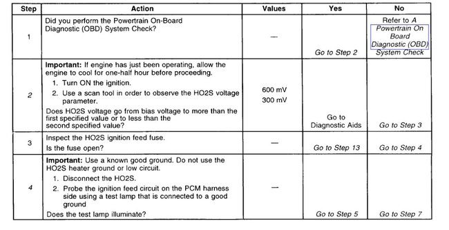

I've replaced tho sensor 2 times and still getting P0135 code. What are main causes if this happening? How can i fix it?
Mar 27, 2021 at 8:11 PM
Good morning,

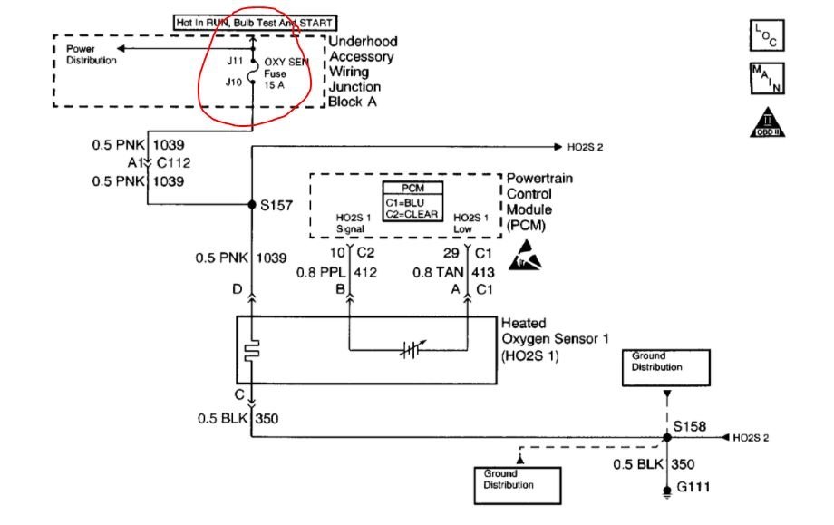

This looks to be an electrical issue with the sensor controls. I attached the flow chart for you to follow along with a wiring diagram. Make sure the fuse is good and there is the power to the heater portion of the sensor.
Let me know the results.
https://www.2carpros.com/articles/how-to-test-an-oxygen-sensor-02-sensor
CIRCUIT DESCRIPTION
Heated Oxygen Sensors (HO2S) are used in order to minimize the time that is required for closed loop fuel control operation and to allow accurate catalyst monitoring. The oxygen sensor heater greatly decreases the amount of time required for fuel control sensor HO2S 1 to become active. The oxygen sensor heater is required by the catalyst monitor sensor HO2S 2 in order to maintain a sufficiently high temperature. This allows accurate exhaust oxygen content readings further from the engine.
The Powertrain Control Module (PCM) will run the heater test only after a cold start, determined by the engine coolant temperature and the intake air temperature at the time of startup, and only once during an ignition cycle. When the engine is started the PCM will monitor the HO2S voltage. When the HO2S voltage indicates a sufficiently active sensor, the PCM determines how much time has elapsed since startup. If the PCM determines that too much time was required for HO2S 1 to become active, DTC P0135 will set. The time it should take the HO2S to reach operating temperature is based on the engine coolant temperature at startup and the average mass air flow since startup. Higher average airflow or higher startup engine coolant temperature means shorter time to HO2S activity.

TEST DESCRIPTION
The numbers below refer to the step numbers on the diagnostic table.

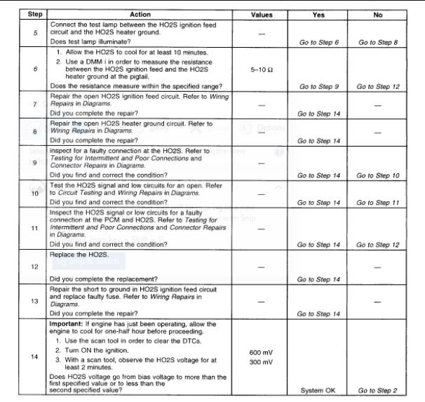

2. The HO2S should be allowed to cool before performing this test. If the HO2S heater is functioning, the signal voltage will gradually increase or decrease as the sensor element warms. If the heater is not functioning, the HO2S signal will remain near the 450-mv bias voltage.
4. This step ensures that the ignition feed circuit to the HO2S is not open or shorted. The test lamp should be connected to a good ground, in case the HO2S low or HO2S heater ground circuit is faulty.
5. This step tests the HO2S heater ground circuit.
6. This step inspects for an open or shorted HO2S heater element. The heater element resistance will vary according to HO2S temperature. A hot HO2S heater element will measure much more resistance than a HO2S heater element that is at ambient temperature. It is important to allow the HO2S to cool before measuring the HO2S heater element resistance.
