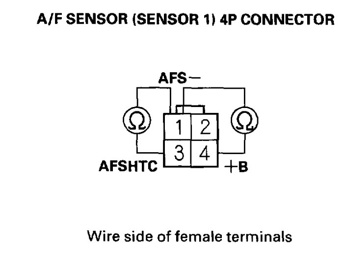

I just bought the car listed above Ex model. I used an OBD to read codes P0135 and P0498. I have not replaced any parts. What should be the first step for troubleshooting?
Thanks, Devin

Hi Devin,
Here is complete trouble shooting:
DTC P0135: A/F Sensor (Sensor 1) Heater Circuit Malfunction
NOTE: Before you troubleshoot, record all freeze data and any on-board snapshot, and review the general troubleshooting information.

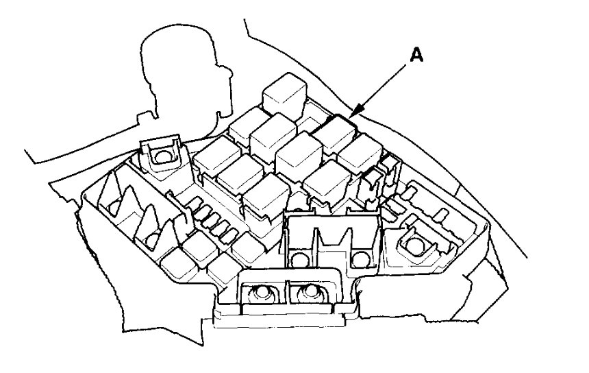

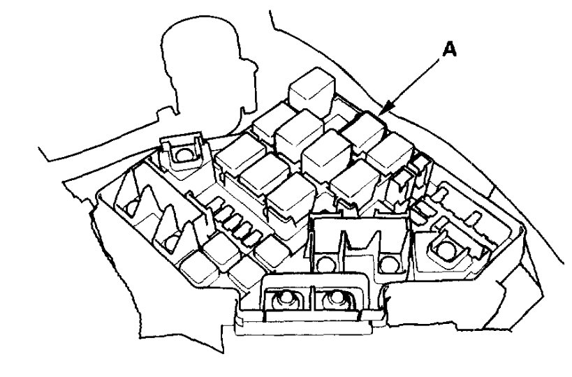

7. Test the PGM-FI subrelay (E) (A) in the under-hood fuse/relay box.(check picture 1)
Is the PGM-FI subrelay (E) okay?
Yes - Go to step 8.
No - Replace the PGM-FI subrelay (E), then go to step 23.

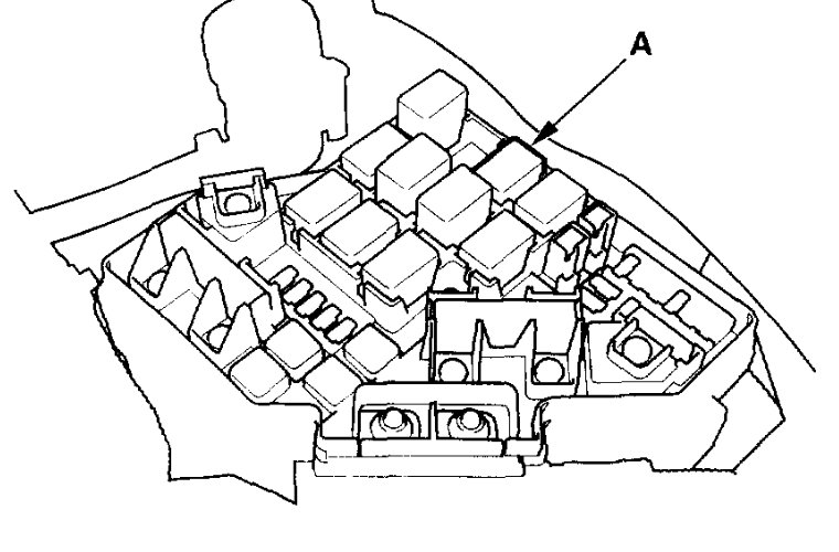

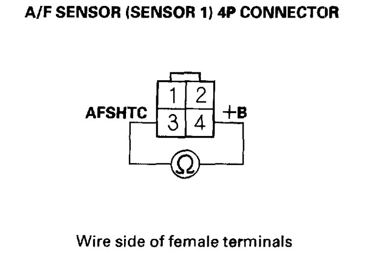

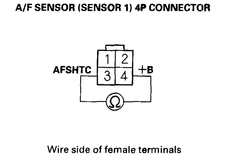

8. Disconnect the A/F sensor (Sensor 1) 4P connector.
9. At the sensor side, measure resistance between A/F sensor (Sensor 1) 4P connector terminals number. 3 and No. 4.(check picture 2)
Is there 1.9 - 2.5 Ohm, at room temperature?
Yes - Go to step 10.
NOo - Go to step 22.

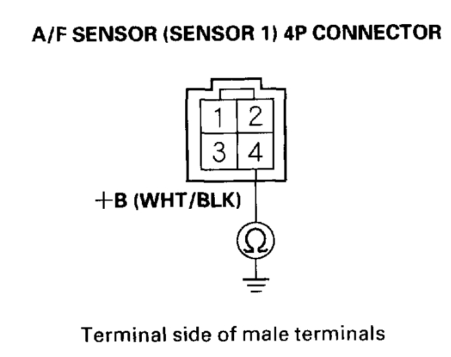

10. At the sensor side, check for continuity between A/F sensor (Sensor 1) 4P connector terminals No. 1 and No. 3, and between terminals number. 1 and No. 4 individually.(check picture 3)
Is there continuity?
Yes - Go to step 22.
No - Go to step 11.

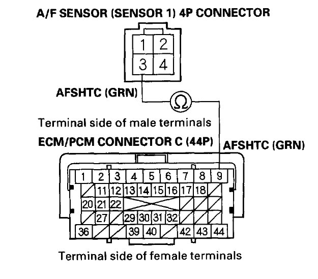

12. Disconnect ECM/PCM connector C (44P).
13. Check for continuity between A/F sensor (Sensor 1) 4P connector terminal No. 3 and ECM/PCM connector terminal C9.(check picture 4)
Yes - Go to step 14.
No - Repair open in the wire between the ECM/PCM (C9) and the A/F sensor (Sensor 1), then go to step 23.

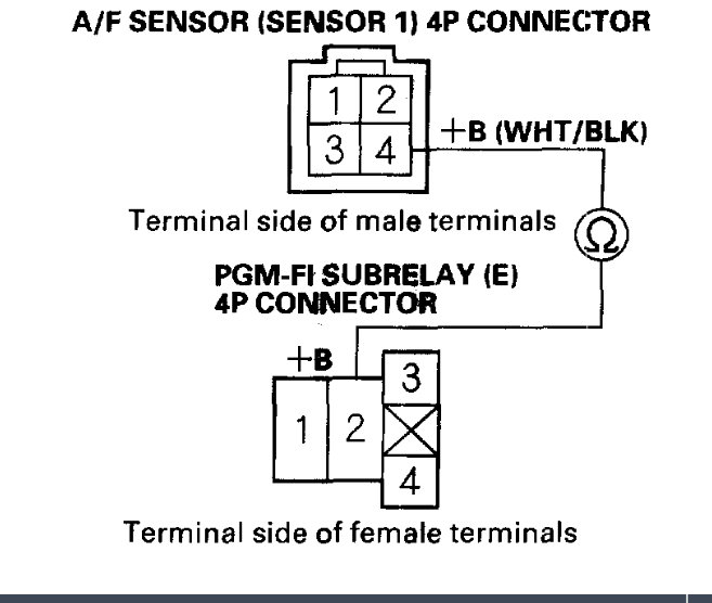

14. Remove the PGM-FI subrelay (E) (A) from the under-hood fuse/relay box.(check picture 5)
15. Check for continuity between A/F sensor (Sensor 1) 4P connector terminal No. 4 and PGM-FI subrelay (E) 4P connector terminal No. 2.(check picture 6)
Yes - Go to step 16.
No - Repair open in the wire between the A/F sensor (Sensor 1) and the PGM-FI subrelay (E), then go to step 23.

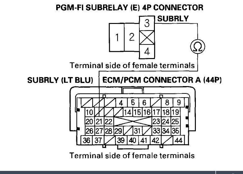

16. Disconnect ECM/PCM connector A (44P).
17. Check for continuity between PGM-FI subrelay (E) 4P connector terminal No. 3 and ECM/PCM connector terminal A21.(check pic7)
Yes - Go to step 29.
No - Repair open in the wire between the ECM/PCM (A21) and the PGM-FI subrelay (E), then go to step 23.

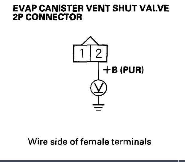

7. Disconnect the EVAP canister vent shut valve 2P connector.
8. Turn the ignition switch ON (II).
9. Measure voltage between EVAP canister vent shut valve 2P connector terminal No. 2 and body ground.(check pic10)
Is there battery voltage?
NO - Repair open in the wire between the EVAP canister vent shut valve and the PGM-FI subrelay (E),then go to step 18.

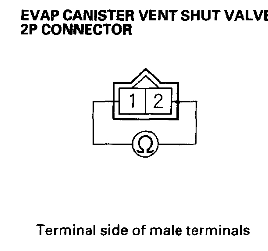

11. Measure resistance between EVAP canister vent shut valve 2P connector terminals No. 1 and No. 2.(check pic 11)
Is there about 25 - 30 Ohm at room temperature?
Yes - Go to step 12.
NO - Go to step 17.

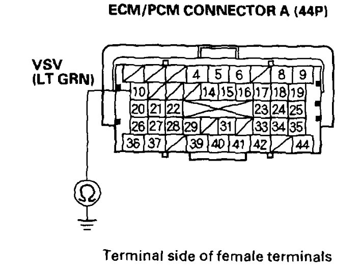

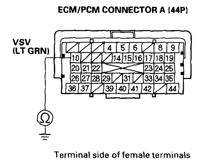

12. Jump the SCS line with the HDS.
13. Disconnect ECM/PCM connector A (44P).
14. Check for continuity between ECM/PCM connector terminal A10 and body ground.(check pic12)
Yes - Repair short in the wire between the EVAP canister vent shut valve and the ECM/PCM (A10), then go to step 18.
NO - Go to step 15.

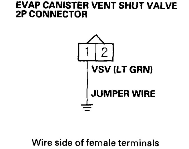

15. Connect EVAP canister vent shut valve 2P connector terminal No. 1 to body ground with a jumper wire.(check pic 13)
16. Check for continuity between ECM/PCM connector terminal A10 and body ground.(check pic 14)
Yes - Go to step 24.
NO - Repair open in the wire between the EVAP canister vent shut valve and the ECM/PCM (A10), then go to step 18.
