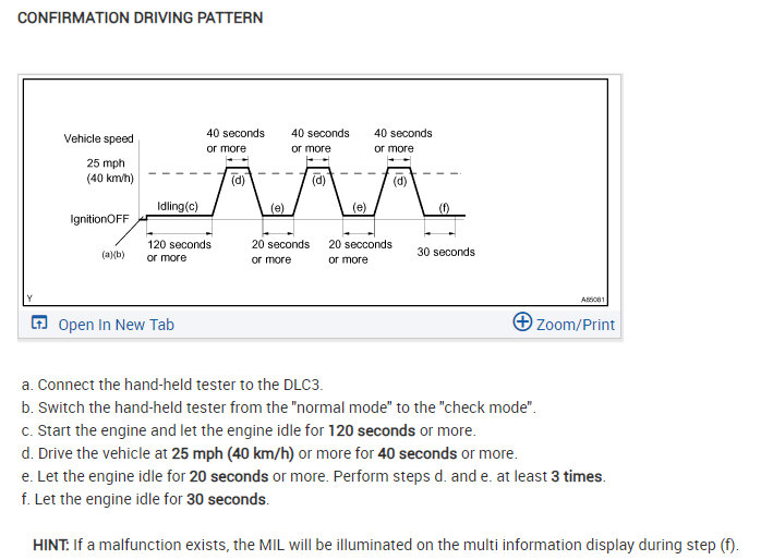

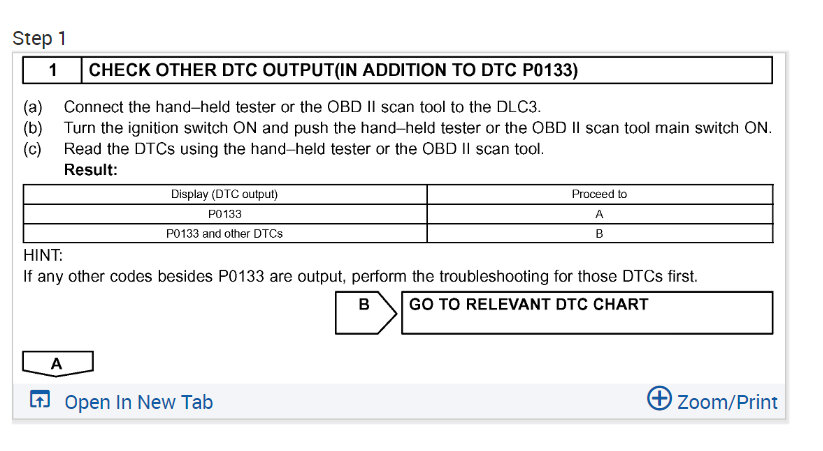

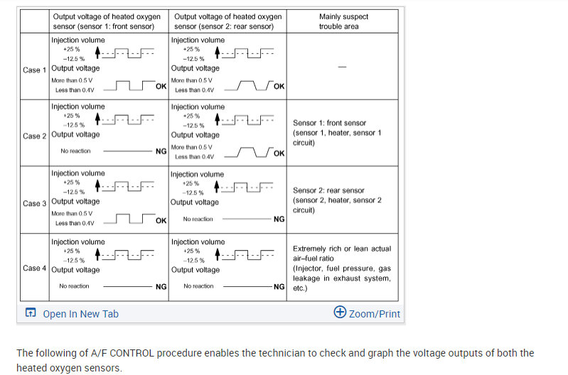

I have a p0133 code. O2 sensor bank1 sensor 1 slow response. What are the causes. where to start diagnosing?
Thank you
Apr 16, 2024 at 7:37 AM
  • 110,241 POSTS

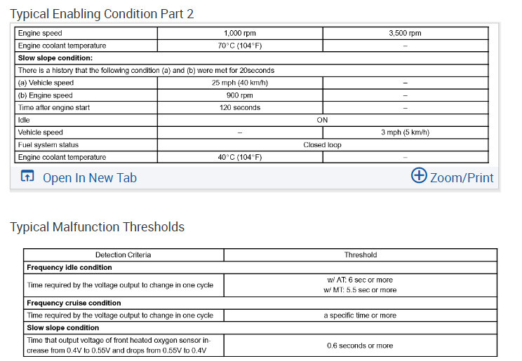

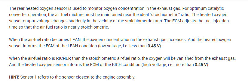

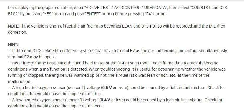

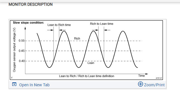

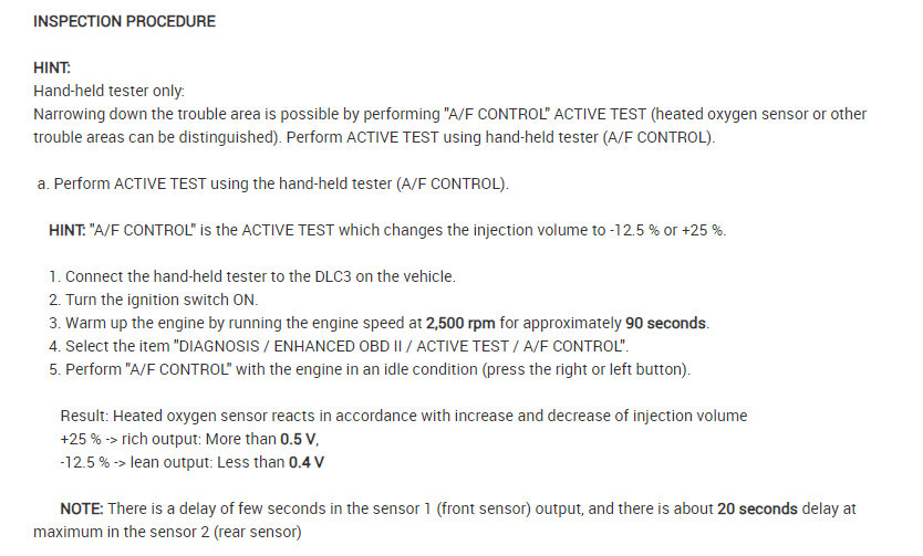

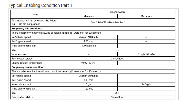

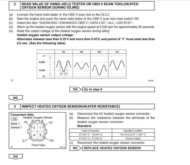

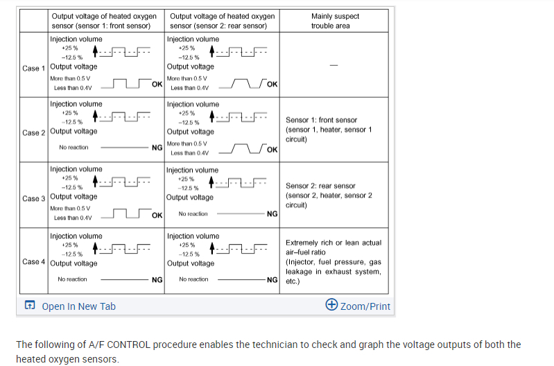

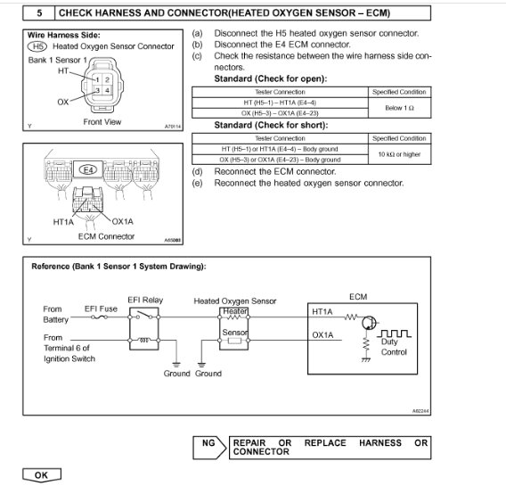

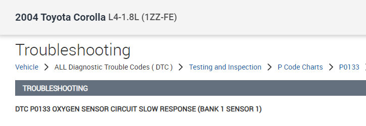

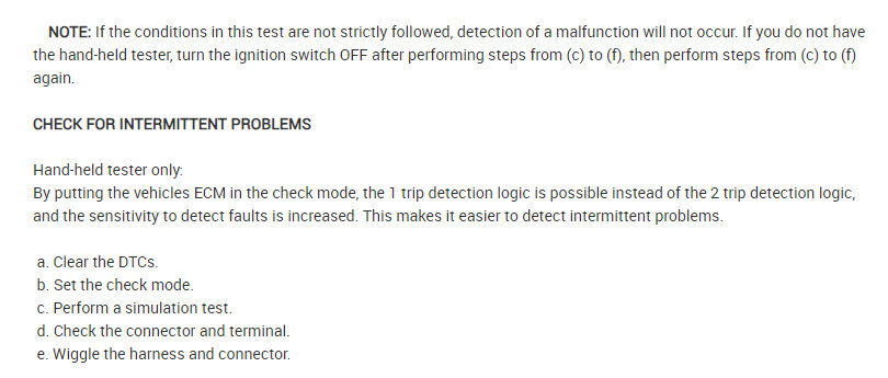

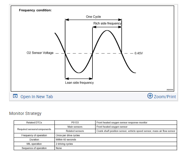

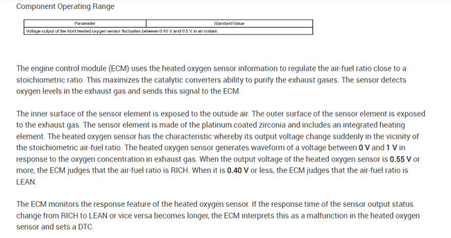

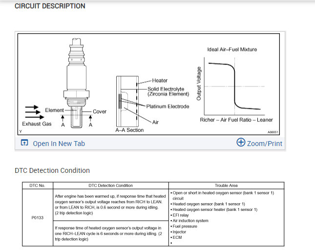

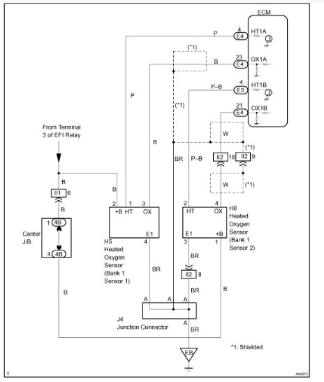

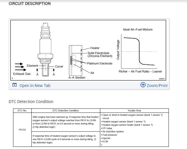

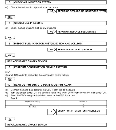

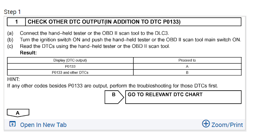

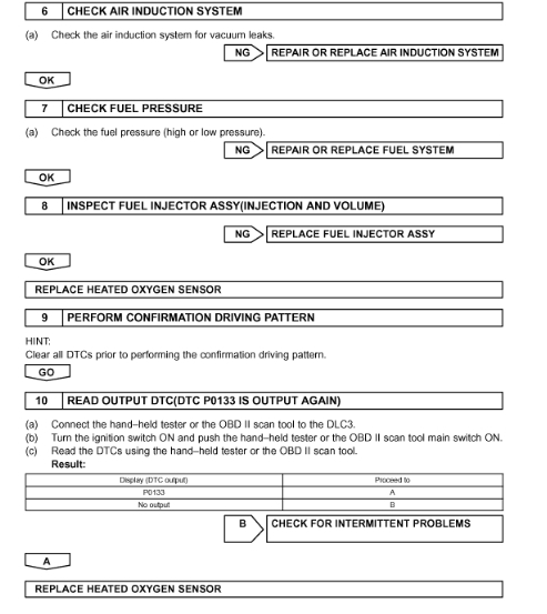

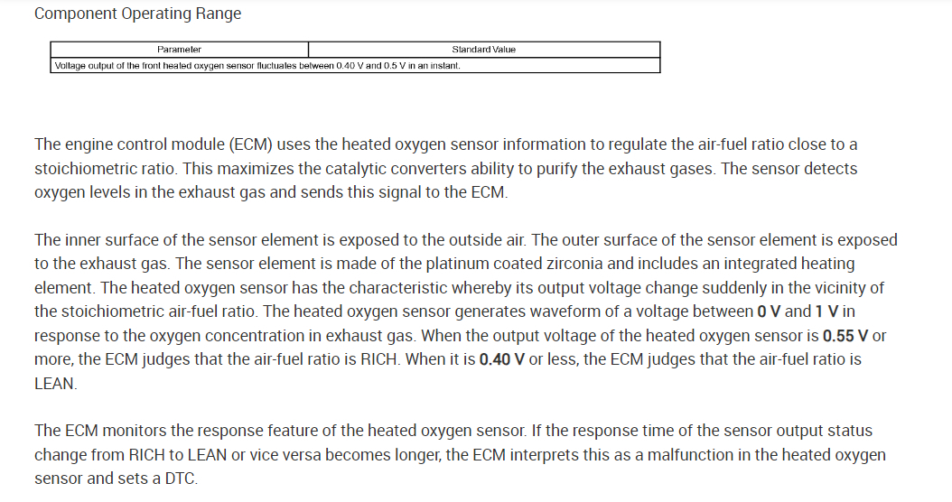

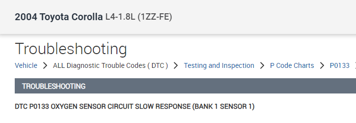

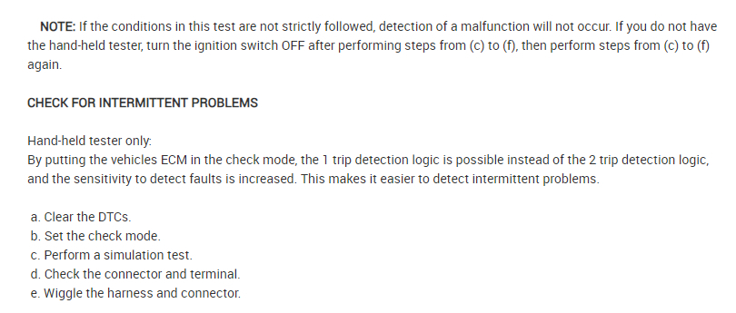

The code indicates a slow response from the sensor. In most cases, the sensor itself is faulty and needs to be replaced.
However, I attached information below for you. It explains how the circuit works and the diagnostics specific to this code.
Let me know if this helps.

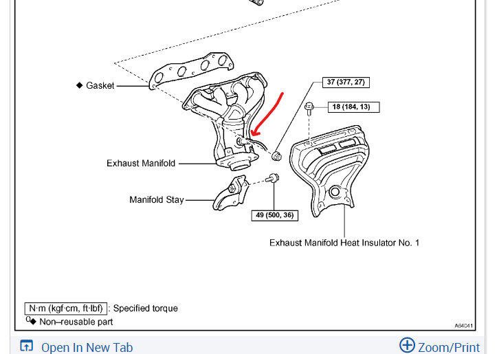

Here is the location of the bank 1 sensor 1 which could be telling you the primary catalytic converter might be going bad, clogged. Check out the images (below). Please let us know what happens.

The code is intermittent does this change in diagnosis?
Apr 17, 2024 at 12:36 PM
  • 55,402 POSTS
Did you swap the sensor out? If so and the codes is still there I would still check the condition of the catalytic converter. The oxygen sensor is not switching because the exhaust cannot flow correctly.
