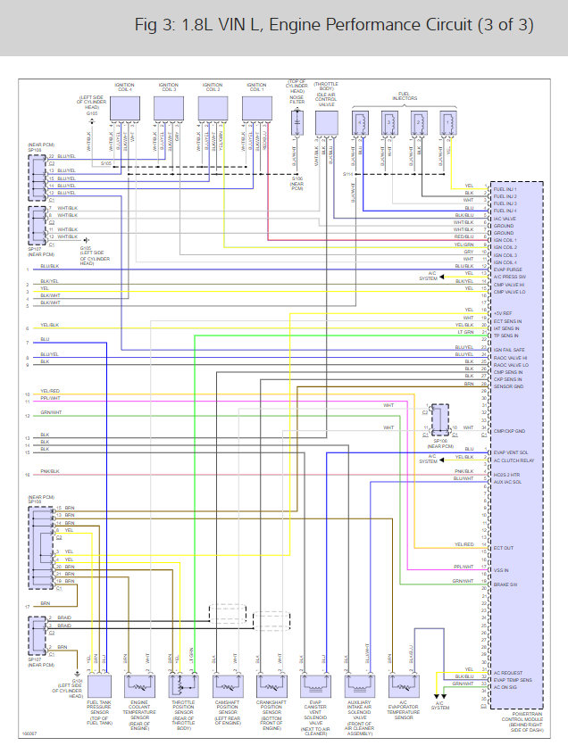

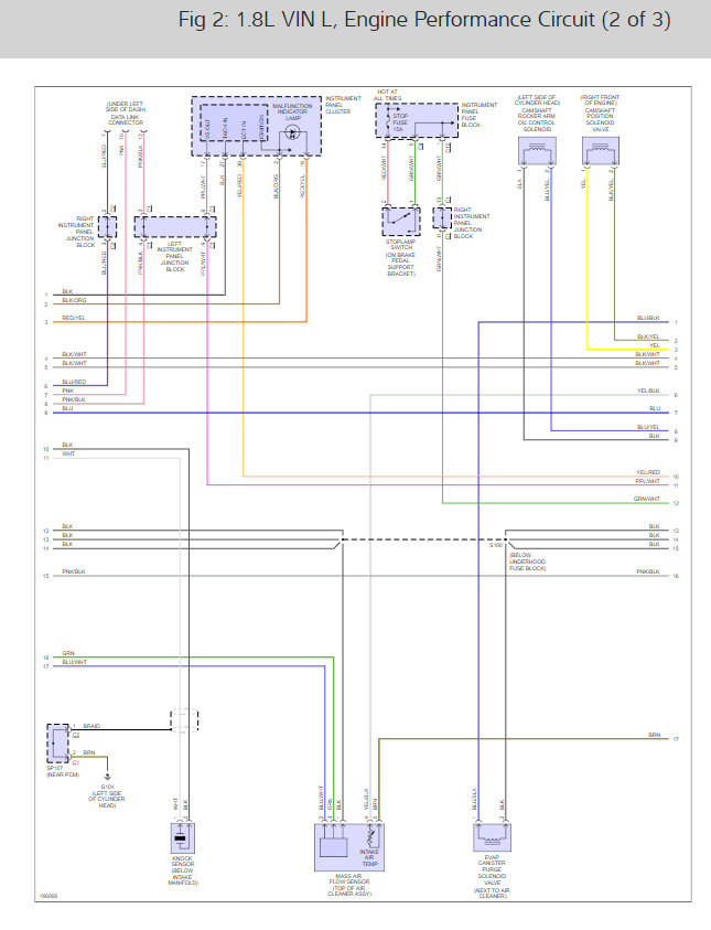

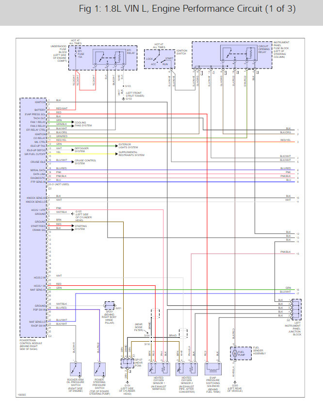

Did you replace all of the 02 sensors are just the one? Sometimes when a new sensor is put in with remaining old sensors they do not read right because the response time is different from the new to old sensors. Let check the wiring though to make sure we are not chasing our tail.
Check out the engine and oxygen sensor wiring diagrams (below). Please let us know what happens.
