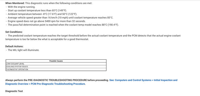

Check engine light came on. Got P0128 code at AutoZone. Noticed the cover to the breather was not clamped down and not even in correct place to cover as designed. Could this be the reason?
Feb 1, 2020 at 4:03 AM
SCGRANTURISMO
  • 4,897 POSTS

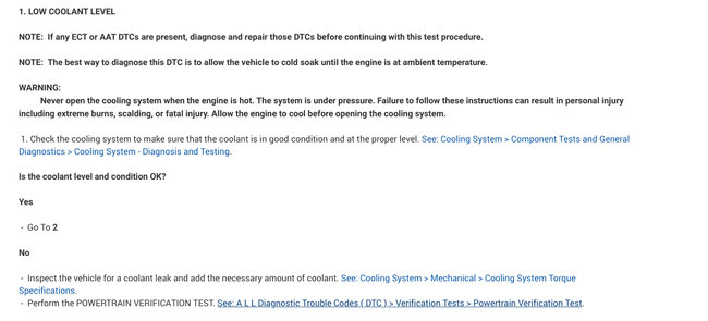

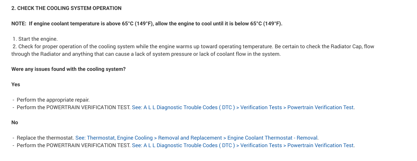

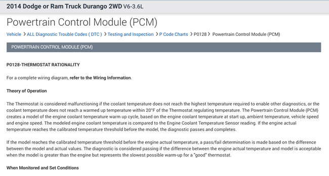

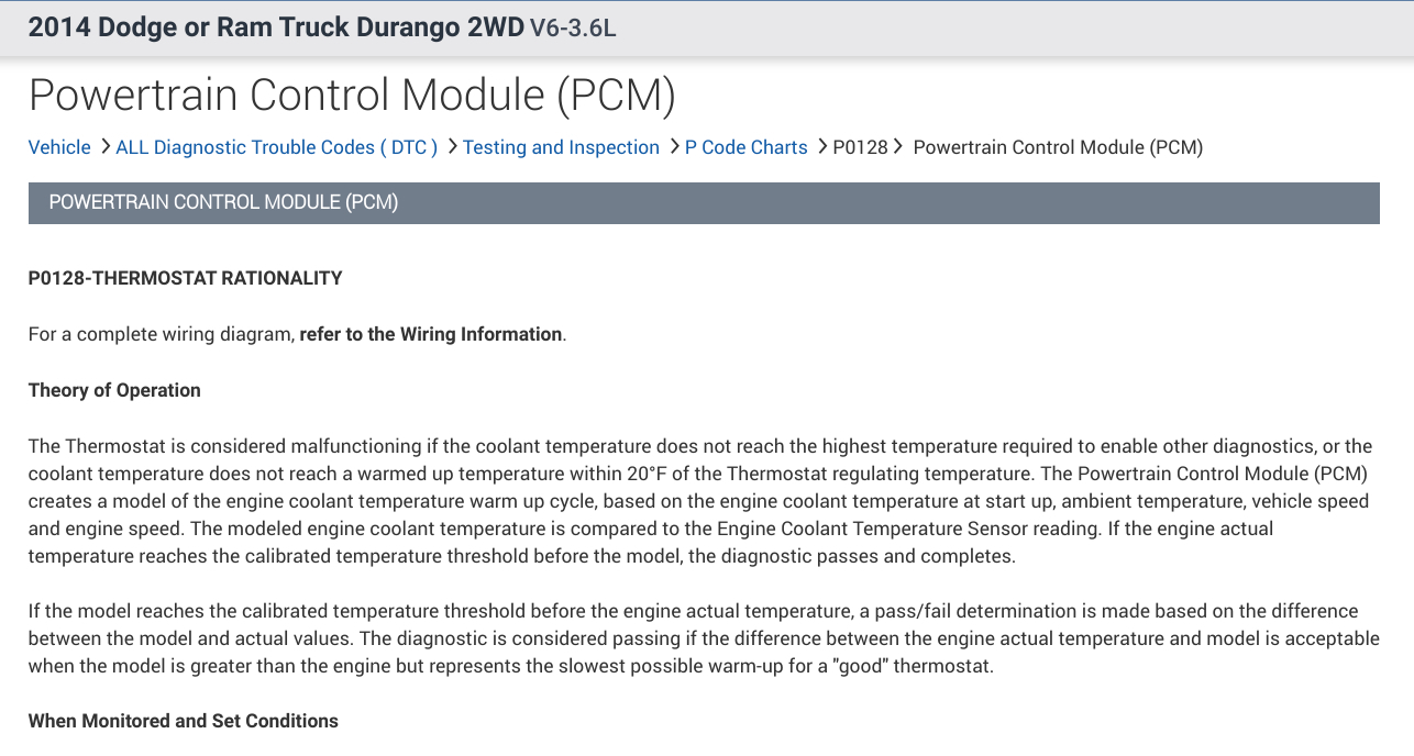

No. Direct Trouble Code[DTC] P0128 is dealing with your vehicle's cooling system. In the diagrams down below I have included the diagnostic troubleshooting guide for DTC P0128 from the vehicle manufacturer. Please go through this guide and get back to us with what you are able to find out.
