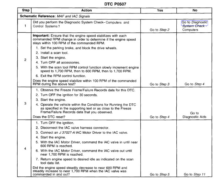

I posted the description below that has some diagnostic aids to check. I also attached a flow chart. It could still be the throttle body as well.

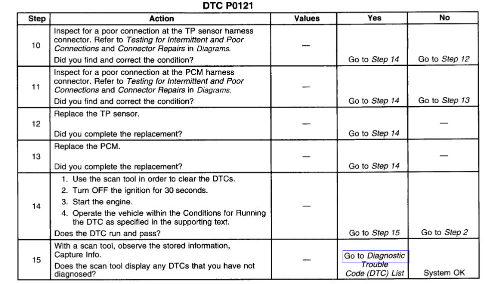

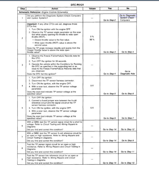

I also posted the flow chart for the TPS as well.

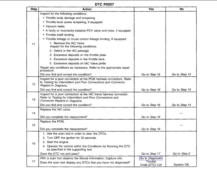

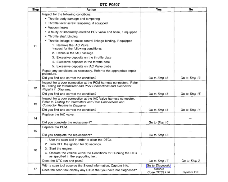

This could be a bad throttle body. The bore for the idle air control may be carboned up holding it wide open.
CIRCUIT DESCRIPTION

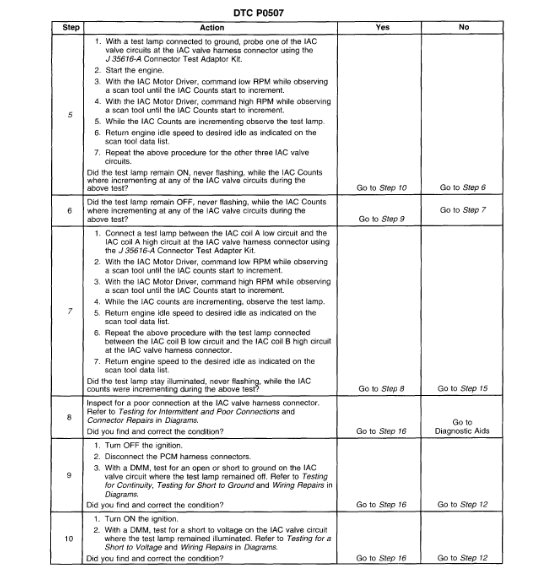

The Idle Air Control (IAC) valve is located in the throttle body. The IAC valve consists of a movable pintle, driven by a gear attached to an electric motor called a stepper motor. The IAC valve motor is a 2-phase bi-polar permanent magnet stepper motor that is capable of highly accurate rotation, or movement, every time the polarity of a winding is changed. This change in polarity can be seen when observing a test lamp connected between ground or B+ and an IAC valve circuit while the Powertrain Control Module (PCM) is attempting to change engine RPM. The test lamp will flash on or off each time the polarity is changed. The PCM does not use a physical sensor to determine IAC pintle position, but uses a predicted number of counts, one count represents one change in polarity which equals one step of the stepper motor. The PCM counts the steps that have been commanded in order to determine the IAC pintle position. The PCM uses the IAC valve to control engine idle speed by changing the pintle position in the idle air passage of the throttle body. This varies the air flow around the throttle plate when the throttle is closed. In order to determine the desired position of the IAC pintle at idle or during deceleration, the PCM refers to the following inputs:

Excessive deposits in the IAC passage or on the IAC pintle
Excessive deposits in the throttle bore or on the throttle plate

Thanks for the response maybe you can give me an explanation on what I did this morning I took my new IAC valve out and I adjusted my old valve to the furthest poin t pindel out and the car idled normal I put my new one back in and the rpm's was at 1,500 to 2,000. So I disconnected the IAC valve while the car was running when I observed the IAC valve it was still seated at the furthest point away from throttle body. So I removed the new one and with the old one I twisted in the pidel until it was seated at furthest point away from throttle body reconnected it for a minute to see if the PCM would command it to move out when I disconnected it while the car was running I saw that it had not moved from the seated position and the idle was high. So I twisted the old IAC back out to its furthest point close to the throttle body and connected it the idle is normal. I am thinking the PCM is not commanding the IAC not sure.
Sunday, October 6th, 2019 AT 10:14 AM
  • 52,797 POSTS
I agree. The PCM commands the pindle retracted when you start and then extends it when the engine starts.
Do you have a scan tool to see if the PCM is commanding the valve? You can make it move in and out with bi directional commands with a scan tool.

Do you have a scan tool that can read the voltage signal from the TPS?
Sunday, October 6th, 2019 AT 12:39 PM
YAIYR
  • 7 POSTS
My scan tool shows the TPS at o in idle and increases as I step on the accelerator. The scan tool is basic.
Sunday, October 6th, 2019 AT 12:49 PM
  • 52,797 POSTS
Okay, good.
I attached diagnostic aids for you to view.
