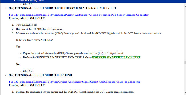

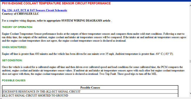

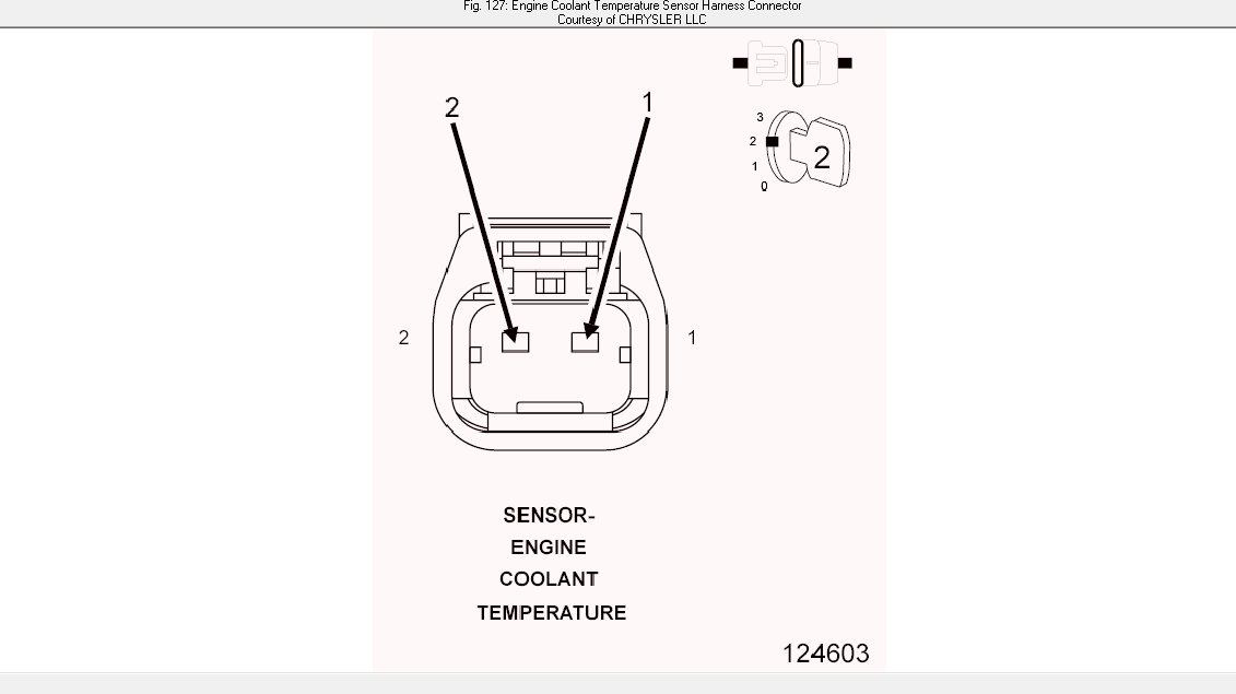

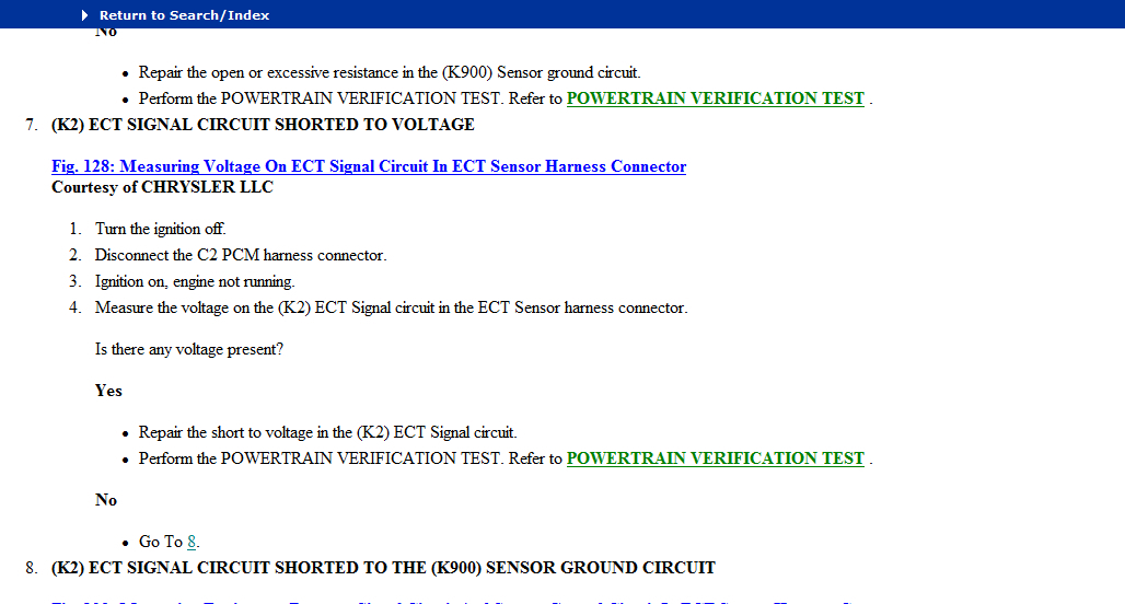

Vehicle won't start. Ect light and check engine light came on. Code is p0116. It just turns over and over but won't fire. If I put my foot on the gas it turns over better. As soon as it's about to start it just shuts off.
Feb 7, 2021 at 10:41 PM
SEVAG P
  • 405 POSTS
hello,

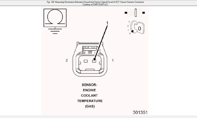

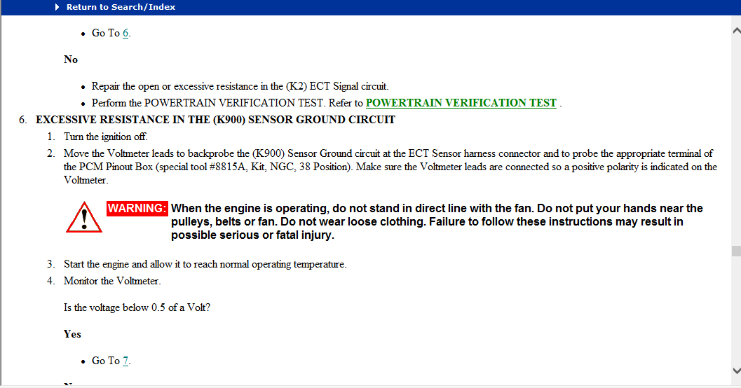

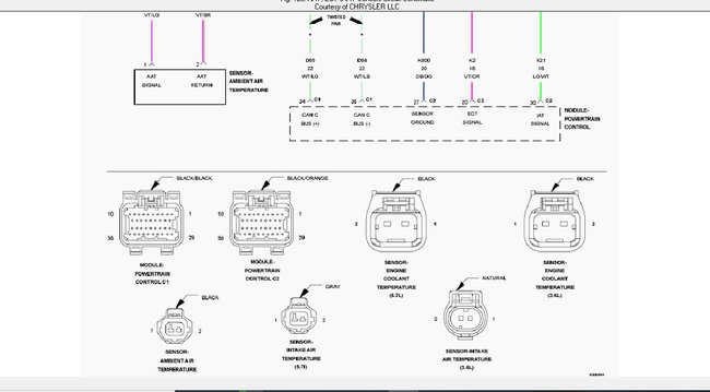

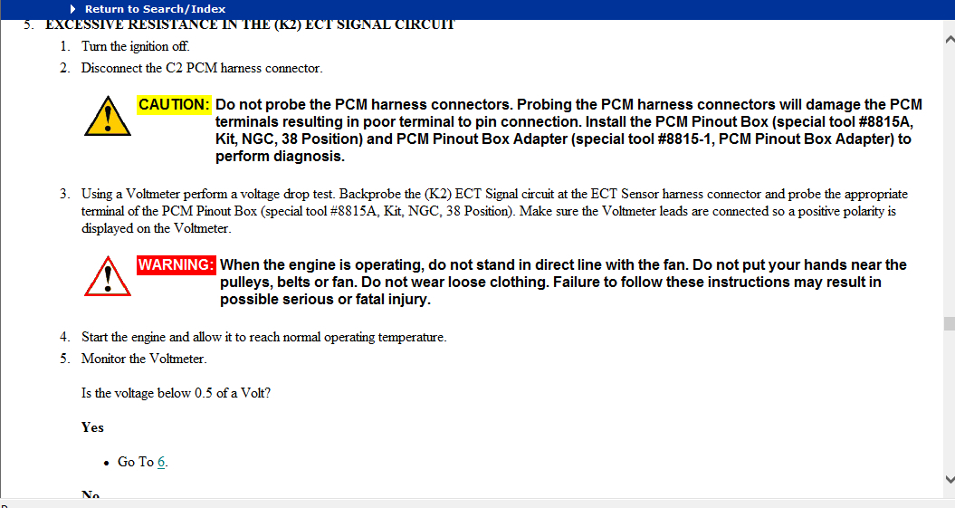

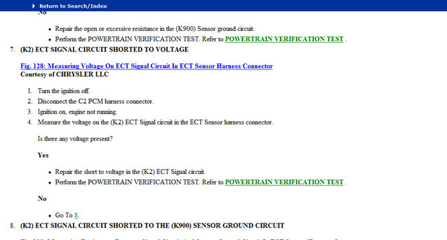

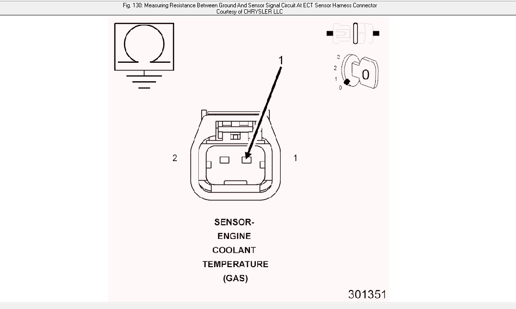

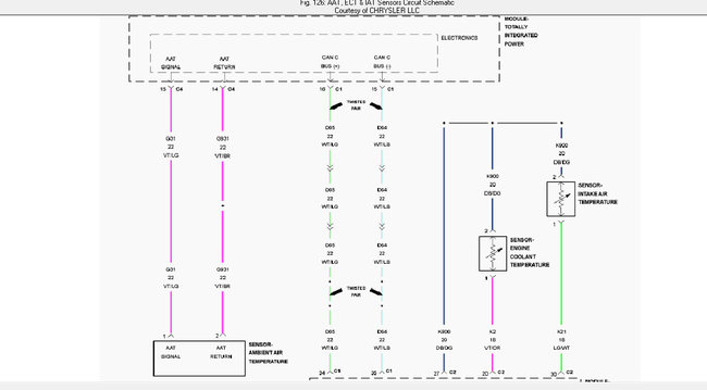

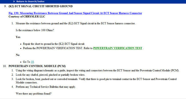

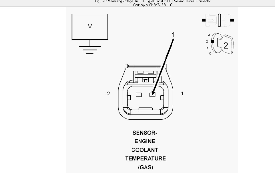

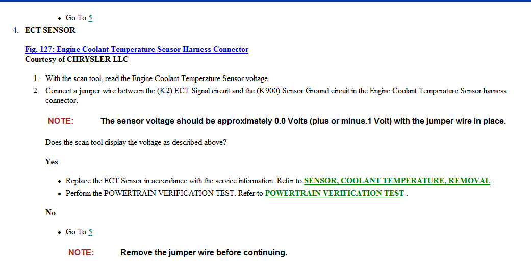

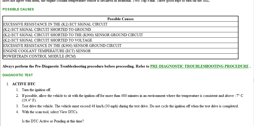

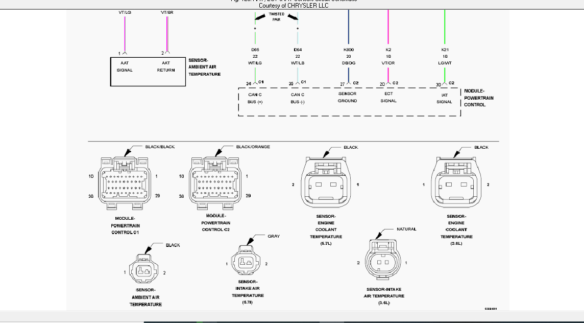

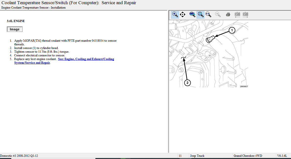

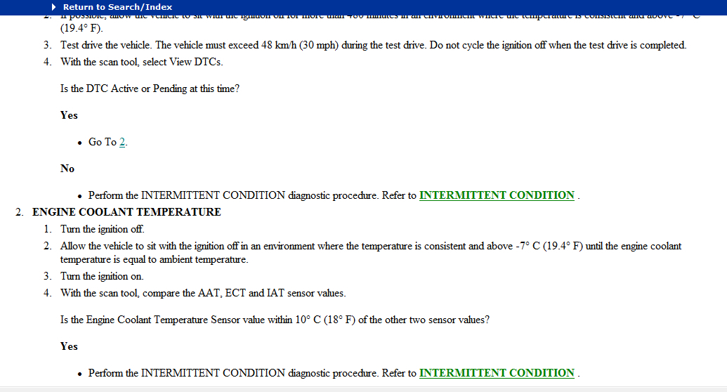

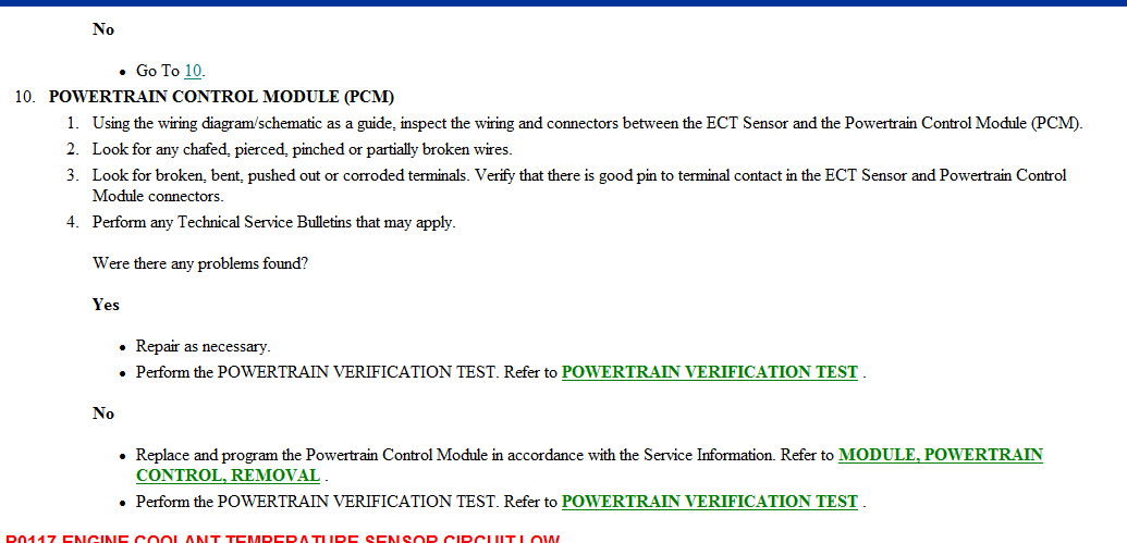

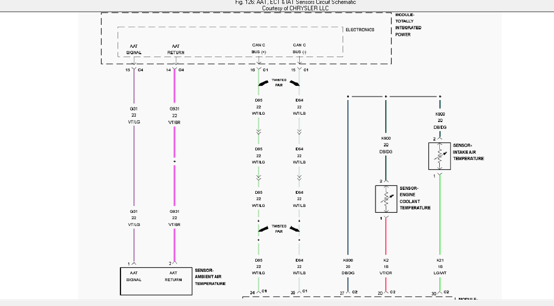

Fault code p0116 is related to engine temperature sensor, possible causes are the sensor connector or the harness, sensor can be defected, last possible cause is engine control unit.
does your scan tool can read live data???
check our link below temperature sensor symptoms
https://www.2carpros.com/articles/symptoms-of-a-bad-coolant-temperature-sensor

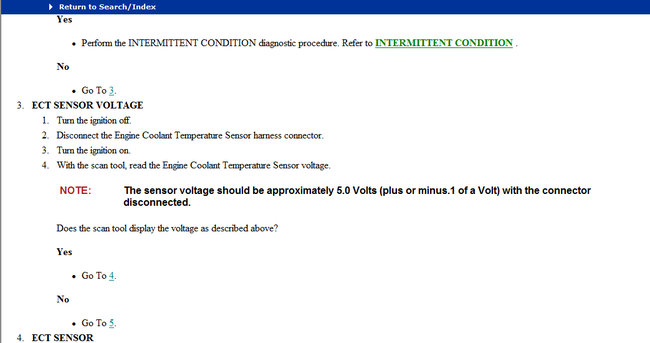

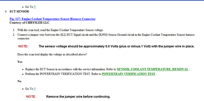

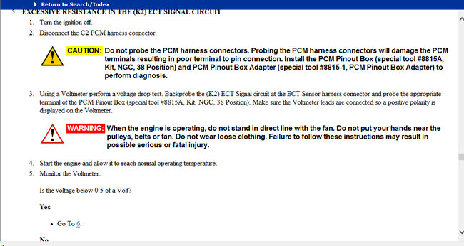

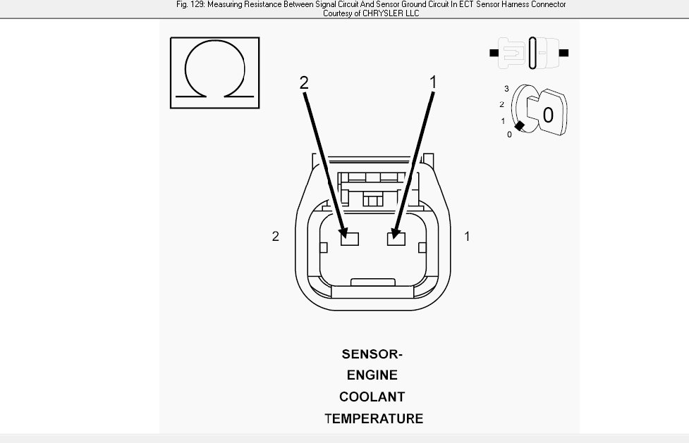

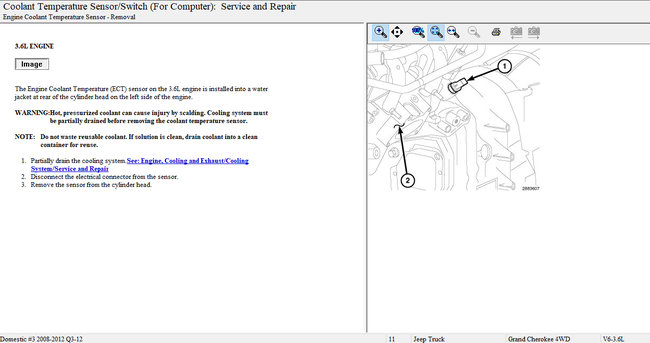

Check the diagrams below how to remove and reinstall engine coolant sensor and test procedure and wiring diagram.
let us know what happens with you.
