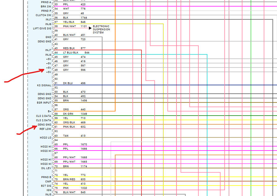

If codes are cleared, truck will start perfect.. Idle for maybe 30-45 seconds then cole out.. I replaced the maf, map, map pigtail, intake manifold gaskets, and tps... Still same issue...

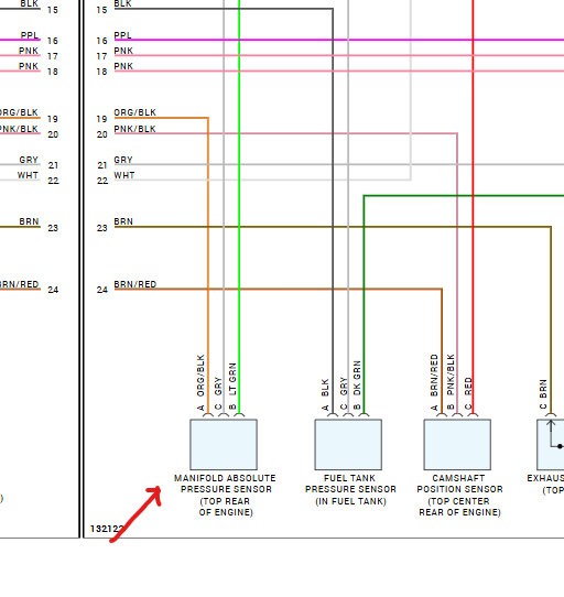

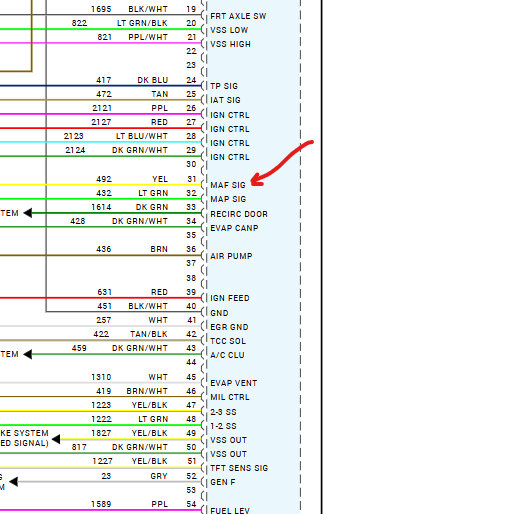

Did it have this code before installing the new MAP sensor or did it happen after? If it was after you have a defective sensor and I would get another one. If it was before lets check the wiring, here is a guide to help with the wiring diagrams below to help with the test.
Check out the images (below). Let us know how it goes

5v good, ground good, signal .3 ohms...
Mar 18, 2026 at 5:11 AM
  • 55,649 POSTS
Yep, I would get another sensor, it can be failing when in operation.
