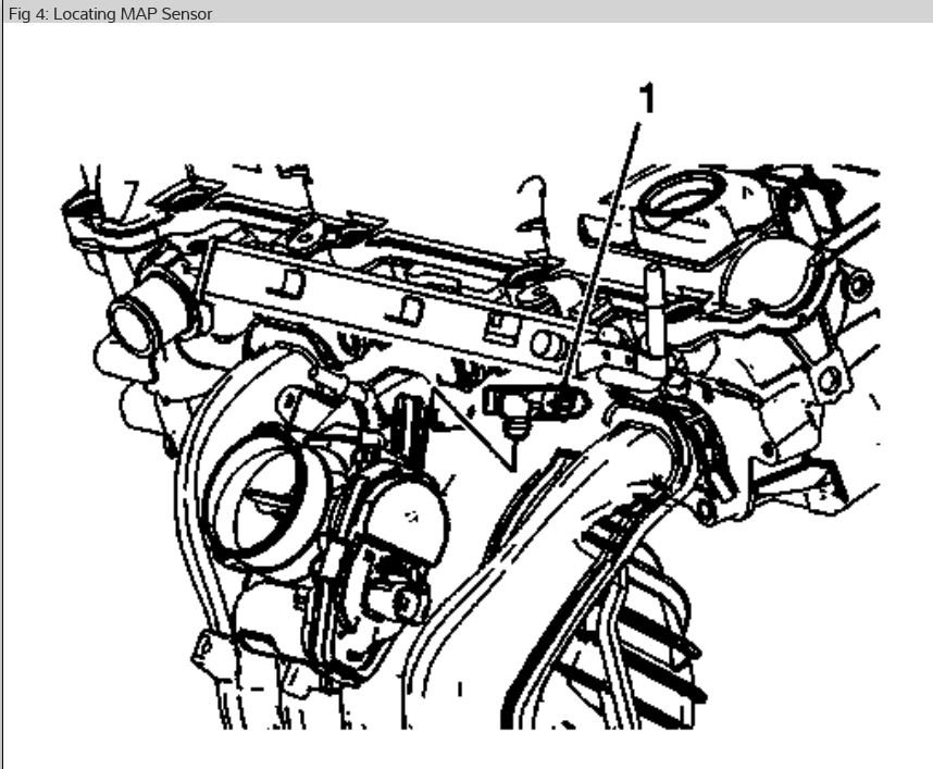

When I start the car cold the RPM fluctuates and stalls. I got p0107 for the code. Could I have a diagram showing the location of the sensor that is defective? Thank you

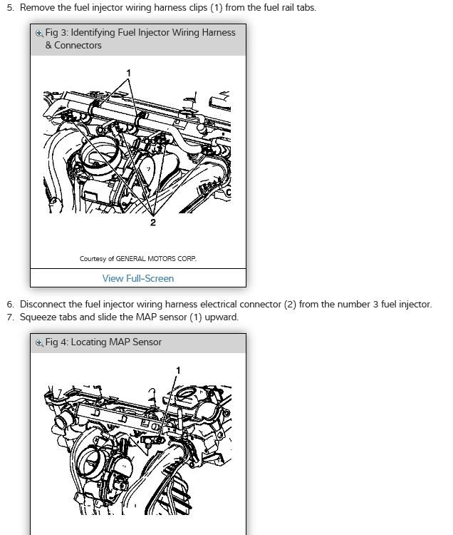

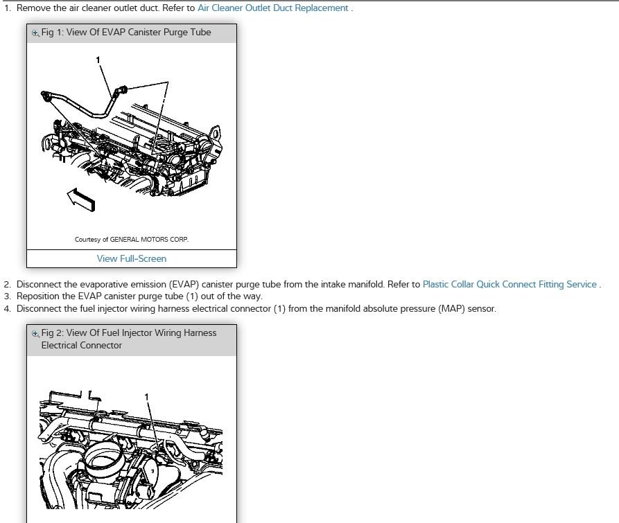

Code P0107 refers to Manifold Absolute Pressure (MAP) Sensor Circuit Low Voltage and here is where that map sensor is located.
And how to remove it. Check out the diagrams (Below). Please let us know if you need anything else to get the problem fixed.
