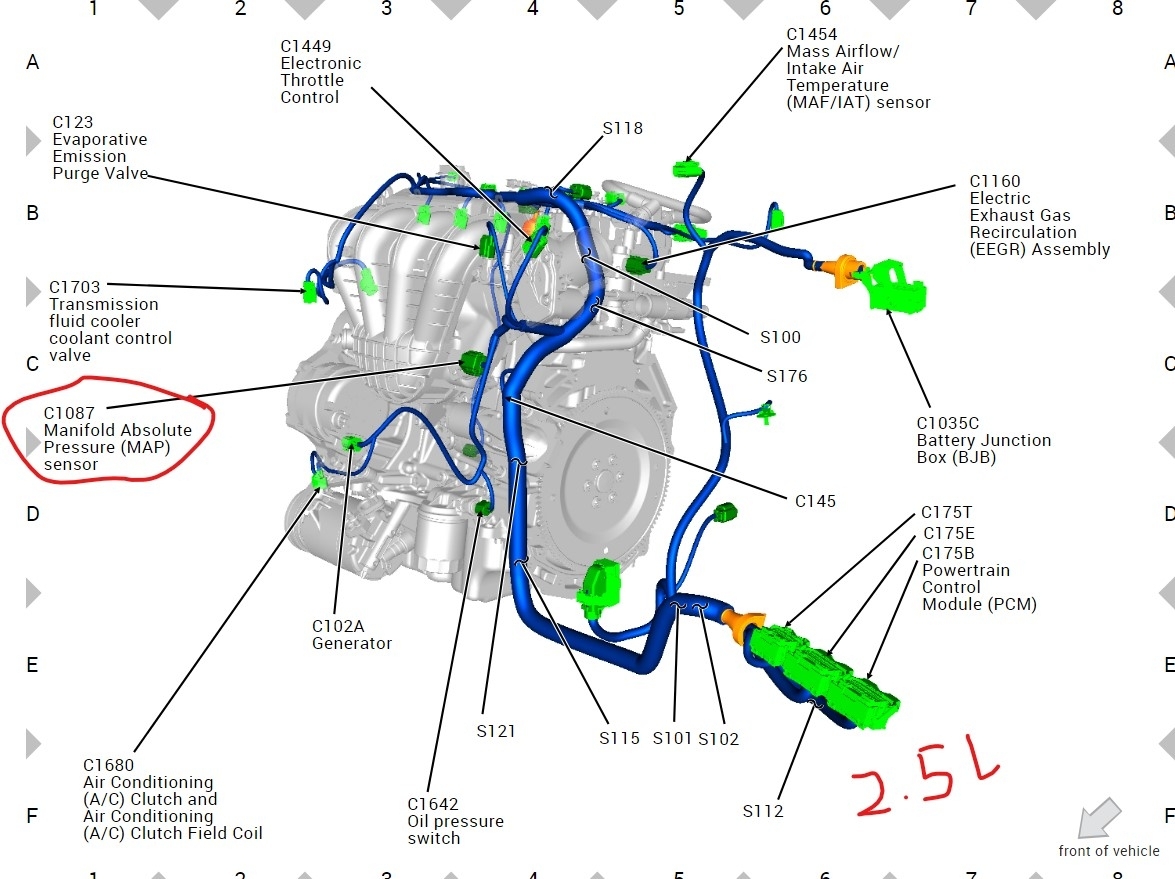

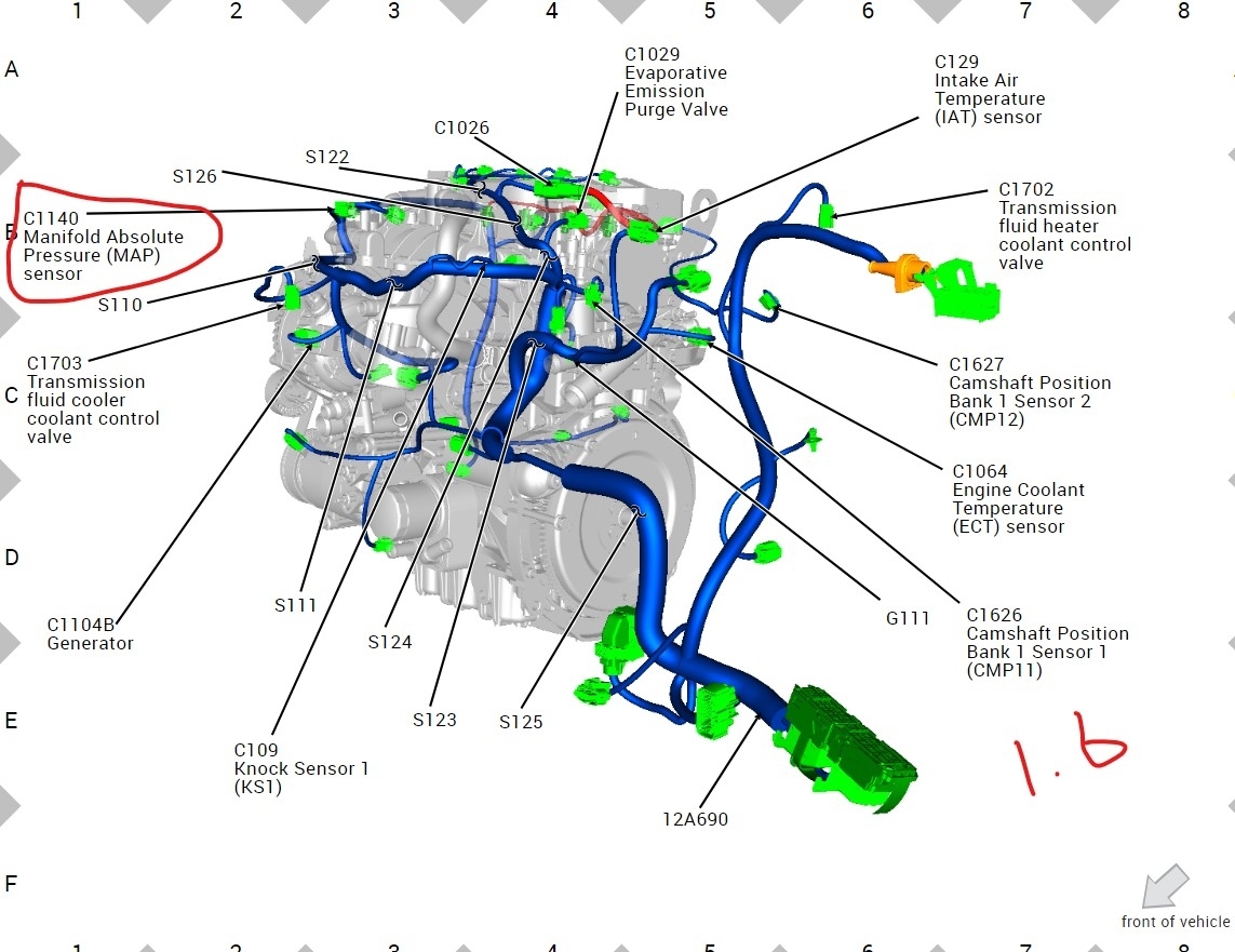

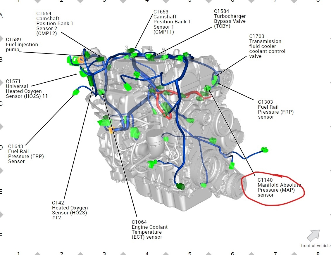

I have a p0106 code on the vehicle listed above but can't seem to find a diagram for where that sensor is located.
May 24, 2024 at 10:29 PM
STEVE W.
  • 15,418 POSTS
Is your Escape all-wheel drive or front wheel? Which engine do you have in it? The MAP sensor can be in different locations depending on those items. Attached are the common ones for the 1.6 the 2.0 and the 2.5-liter engines. Hope one of them is helpful.
