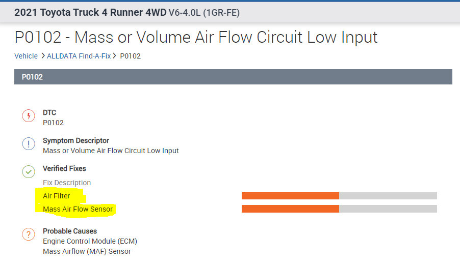

Hello, I recently purchased an Innova 6100P ODB2 reader and decided to try it out on my vehicle listed above. To my surprise it gave me a P0102 permanent code. Odd since it only has 12,900 miles, no dash lights, engine runs great city and highway. Can get 18.5 MPG freeway. Idles fine. All the monitors show green with a “completed” status on my ODB2 scanner. I watched a few YouTube videos and most of the fixit suggestions were to clean the MAF. I bought MAF spray cleaner and cleaned the MAF as instructed. Let it dry thoroughly. The permanent code will not go away. I’ve seen videos about performing a “drive cycle” to get rid of the code however, it’s confusing on which drive cycle I should perform. I don’t need to smog my 4Runner for several more years, but this code really bugs me. I’m not sure if there’s something really wrong or not. I “baby” my 4Runner and it has low mileage as I am retired and don’t drive that much. I’m in California. I’m leaning towards running a drive cycle but which one and why if my monitors are all green? Thanks in advance!

Because this vehicle is new, it needs to be checked at the dealership. The code you have indicates a low voltage issue from the MAF. When this DTC is set, the ECM enters fail-safe mode. During fail-safe mode, the ignition timing is calculated by the ECM according to the engine speed and throttle valve position. The ECM continues operating in fail-safe mode until a pass condition is detected. I believe that is where you are getting the drive cycle info. Keep in mind, when the ECM continues in a fail-safe mode, it will run fine. However, it isn't running as efficiently as it should. Make sure this is resolved before the warranty has expired.

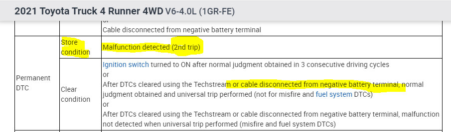

As far as a permanent code, in this case, the code is set when there are two consecutive drive cycles when the problem is present. If you disconnect the battery (neg first) then the positive, tie the two cables together with a zip tie, and allow it to remain that way for approximately 15 minutes, it should clear the code. However, if the problem is still present, the same thing will happen after the second trip

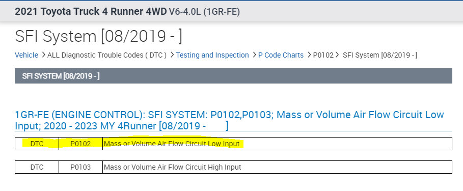

See pics below Note: Pic 1 describes the code, pic 2 shows the most common repairs (yours is too new for an air filter but there could be a wiring or sensor-related issue) and pic 3 explains how it is set and how you can try to clear it.
