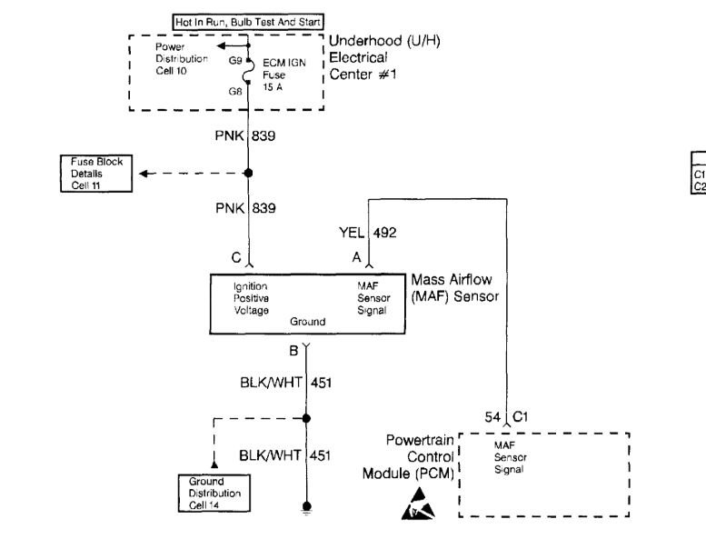

Just test drove her again and got the error code:
PO102
Mass of Volume Air Flow A
Circuit Low
I replaced the MAF a few days ago. So I removed the new plastic one and replaced it with the original aluminum one (that's clean as a whistle) and there was no change in the error code. Plus, I then tested it with my multi-meter, here are the results:
1) With the harness disconnected and the engine/ignition off:
All three wires (red, black and yellow) ohm-ed out as ground.
2) With the key in the ignition and it turned to run position without the engine on:
The power wire (red) had almost 13 volts, the ground (black) wire was grounded, and the signal wire had about 6 volts.
3) With the engine running and the harness attached:
I tested the Hertz with my test bench set to 20 Hertz and the signal wire (yellow) had a fairly consistent 2.14 hertz at idle (engine warm) and when the engine revved it smoothly went to just above 14 hertz and then evenly went back down to 2.14 when the idle was slowly released.
​​​​​​​So it seems the original MAF is working within specifications? So why is this code thrown?

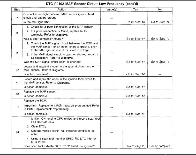

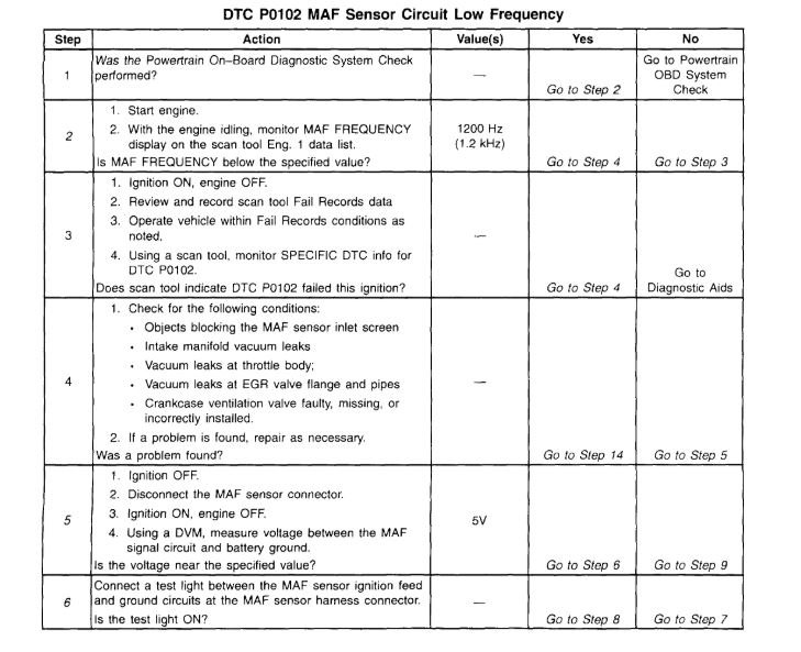

Good afternoon,
I attached a flow chart for you to follow.
Follow the steps and let me know what you find.

2. This step verifies that the problem is present at idle.
5. A voltage reading of less than 4 or over 6 volts at the MAF sensor signal circuit indicates a fault in the wiring or a poor connection.
6. Verifies that ignition feed voltage and a good ground are available at the MAF sensor.

Did you follow the flow chart and what were your results?

I think I'm tracking with you on my Foxwell having a (g/s) reading for the MAF. It seems it was in the 4-5 during idle and was at the 40-50 range when it was bogging down, but when it cleared and accelerated as expected, it was well into the high 60's and into the 70's. Is this something that assists? Both the original GM MAF and the new replacement AC Delco MAF are performing the exact same way.
Mar 10, 2020 at 5:59 PM
Did you replace the connector to the sensor? It is very common for the connector to be faulty.
If all that is good, then a good chance the ECM is the issue.

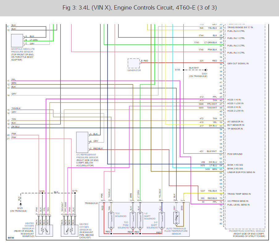

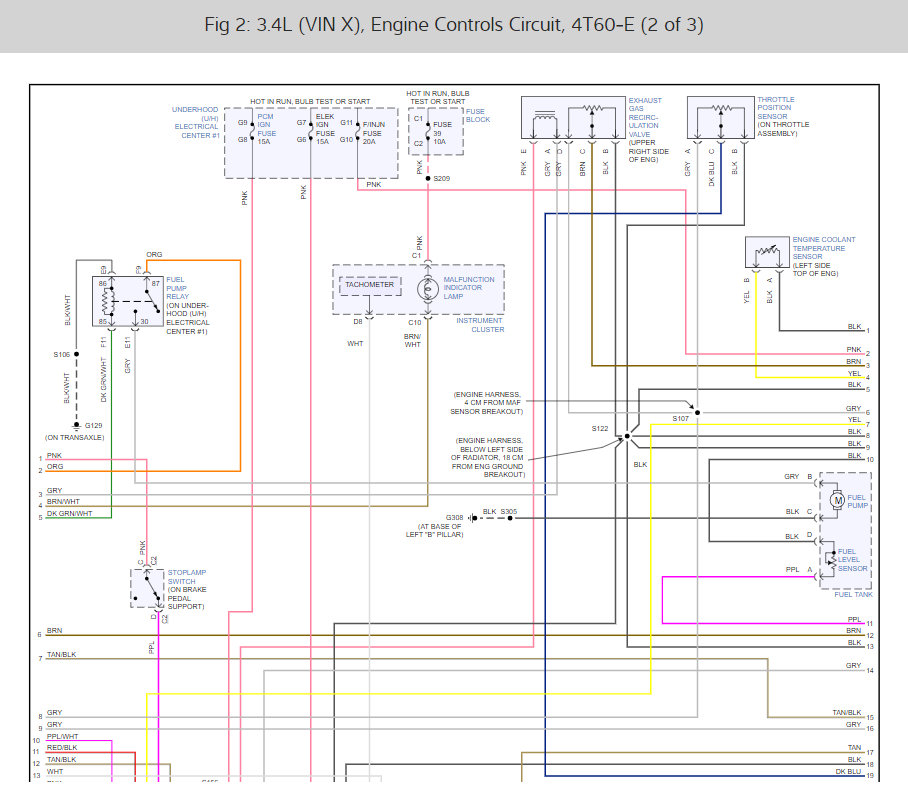

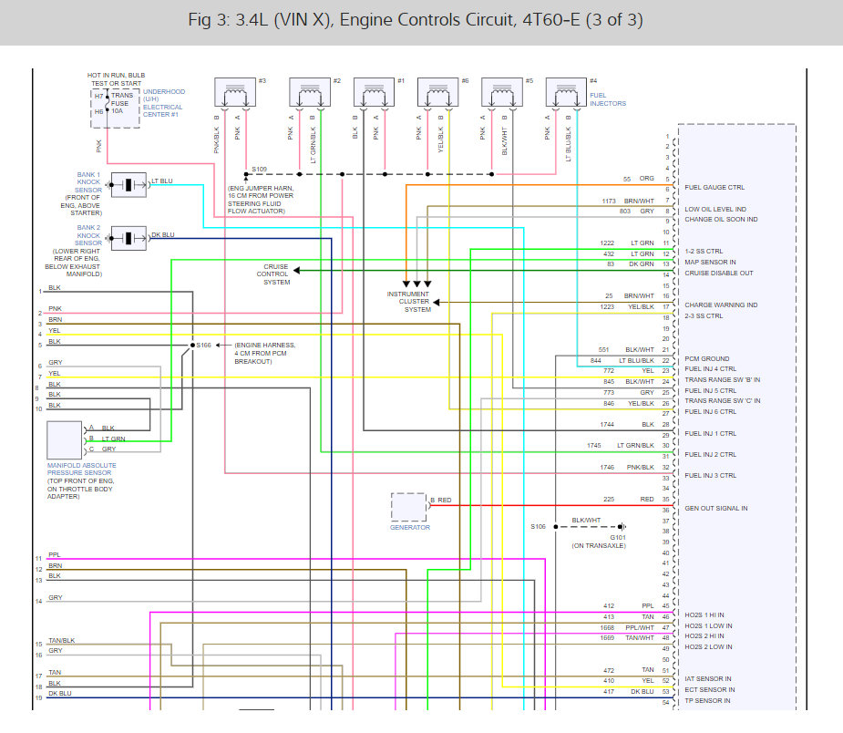

Lets check the connection between the PCM and MAF. here is a guide and the wiring diagrams so you can see how the system works and which wires to check:
Mar 12, 2020 at 10:33 AM
CLANOFWOLVES
  • 33 POSTS
Thanks for the advice!
I did ohm out the yellow signal wire from the MAF harness to the PCM harness pin and I got no tone and about 1.87 on the resistance. I then ran a same gauge yellow wire along the existing plastic conduit (wire bundle cover) and skinned back the existing wire just short of each harness and wrapped the new wire for good contact. I then checked the connector to connector and had tone and something like .002. I then put everything back together and drove it.
She went up hills fine but there was a slight hesitation here and there, so I plugged in my Foxwell and saw the MAF (g/s) stayed steady at 1.95 no matter my acceleration. I then thought the old wire still in the circuit might be the issue, or the original MAF sensor that I put back on was bad (I thought not as the new MAF sensor threw the same readings, but it could have been the wire). So I returned home to cut out the old wire and see how she ran back to the auto parts store to get a new MAF.
I cut the old yellow sensor wire free at both ends and wrapped the ends good. Got it to start her and she wouldn't start.
She just spun the starter.
Foxwell was connected and stated there was no error code.
So I checked a few of the fuses, they were good. I'll need to start at fuel pressure, and so one to find out what happened between leaving the old sensor wire and taking it out.
Am I missing something simple???
Frustration sets in. I need a breather for an hour or so before I get back into it.
Thanks guys!

I checked the wire/solder and it all shows connectivity, and I checked the other pins around the MAF sensor input wire at the lower large PCM plug in case my manipulation of the wires to get to the yellow MAF sensor wire caused any damage.

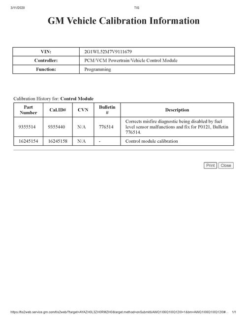

Finished (though I had to go to a shop with a Tech 2 and basically rent it with the mechanic).
Everything is factory spec, and it idles and revs without issue. No trouble codes. Everything is within spec. when we looked over all the info in his Tech 2 readings.

Yes, it was the most updated. The last update was:
