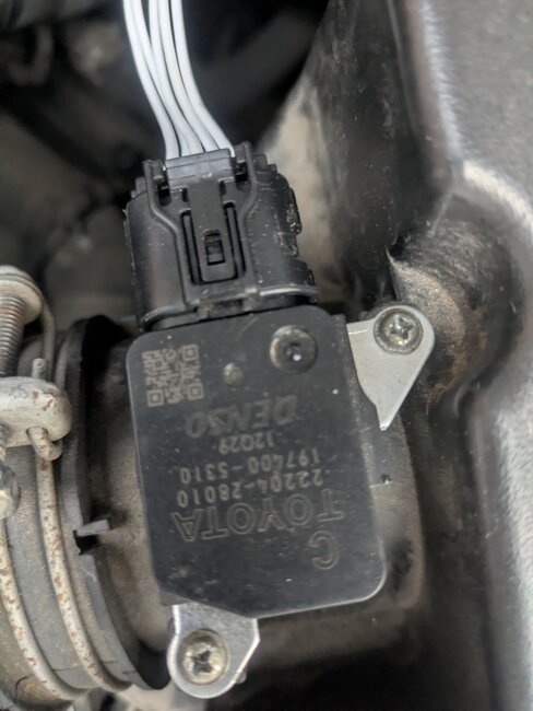

They said that they checked the Mass air flow sensor and it was good. The Mass airflow sensor is a Toyota Denso. See the photos
Aug 11, 2026 at 7:20 PM
  • 110,241 POSTS
That is where I would start. You can get cleaner for the sensor to try cleaning it.
Here is a link that explains how. Keep in mind, they indicated the power supply is where it should be. The more I think about it, that wouldn't likely be the case if there was an issue with the PCM. That is why I'm suggesting starting at the sensor itself.
https://2carpros.com/articles/mass-air-flow-service/
Aug 11, 2026 at 7:36 PM

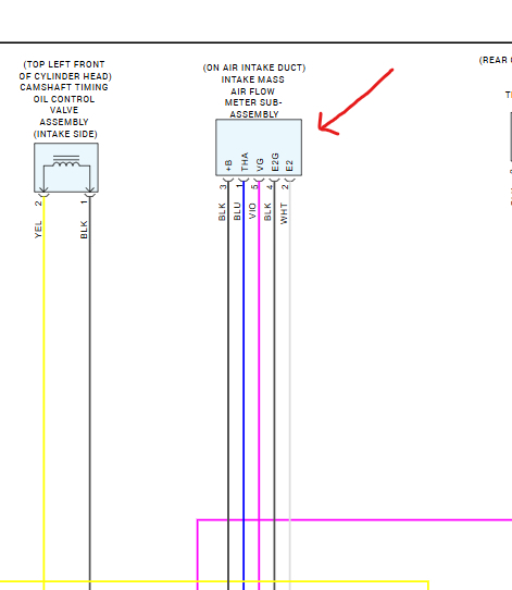

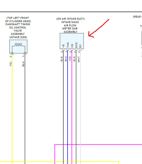

Yes, I would replace the MAF sensor, cleaning it when it is too far gone does not help. After you have replaced the part, clear the codes and drive the car. Also I noticed the new MAF pigtail so it might be wired incorrectly. Here is the wiring diagrams so we can double check it.
Aug 14, 2026 at 10:56 AM
  • 55,399 POSTS
Here is the diagram
Aug 14, 2026 at 10:59 AM
