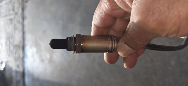

Need help. What else is causing this code? I changed my sensors again this time with ntk top and bottom. My wires are not damaged on both sensors they look good, and my car drive good. What else can I change to fix before emission?

These are the sensors I have now brand new and yes, I changed all the fuses somewhere old but that department good, but this code still remains. Drove home just now from work it came back on p0036 nothing else and my car still perform as usual no major problems but I'm getting loss now maybe a wire I just don't know where to start checking.
