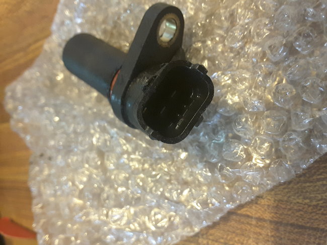

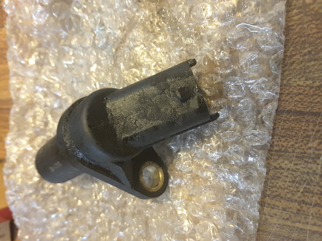

It should start right up after replacing it.CAn you post a picture of the old one you replaced?

I did notice the wires going I to the plug seemed flimsy

Did it started run before you changed it?if so put the old one back in and see if it starts?Maybe you ggot a new bad one?That happens and it will throw you off when it does happen.

Yep, it was a faulty new part, THANK YOU for being so prompt a D helpful.
