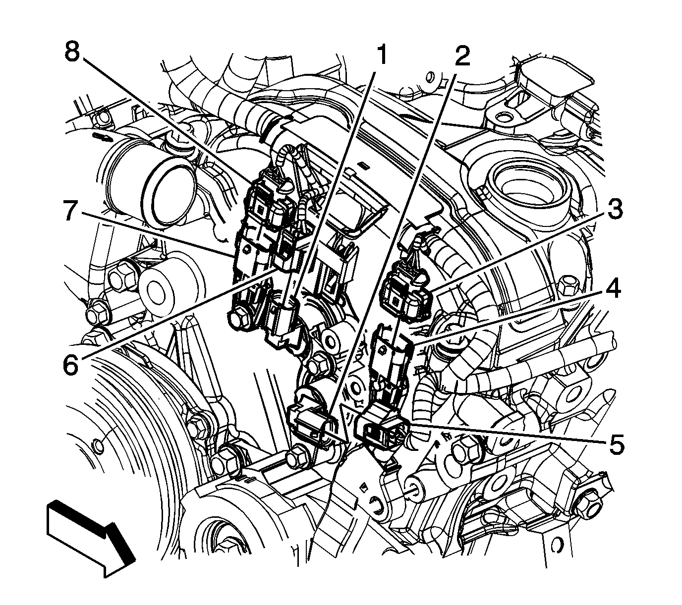

Code came up. Had all four replaced in December 2017. Could the sensors gone bad already?
Aug 21, 2018 at 9:03 AM
  • 110,244 POSTS

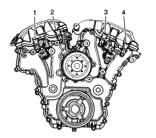

I hate to say it, but yes. The code you have indicates one of the sensors has failed. Here is the description of the code:
DTC P0018
- Crankshaft Position (CKP) - Intake Camshaft Position (CMP) Correlation Bank 2
Now, there are other things that can cause this code. A worn timing chain, a crankshaft reluctor wheel that has moved in relationship to top dead center (TDC) on the crankshaft, timing chain tensioner condition issue, or something as simple as a bad connection at the sensor.

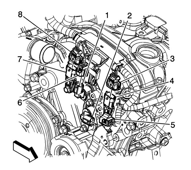

If you want to check the connection to this sensor or try to replace it, here are the directions. The first 6 pictures correlate with these directions. Check the wiring at the connection first. The last picture is of the crankshaft position sensor. I added it because these two work together. However, if the crank sensor was causing a problem, I feel the other cam sensors would be setting codes too. Regardless, if you want to check the connection and wiring, I attached the pic of its location.
Here is a link that shows how to check wiring.

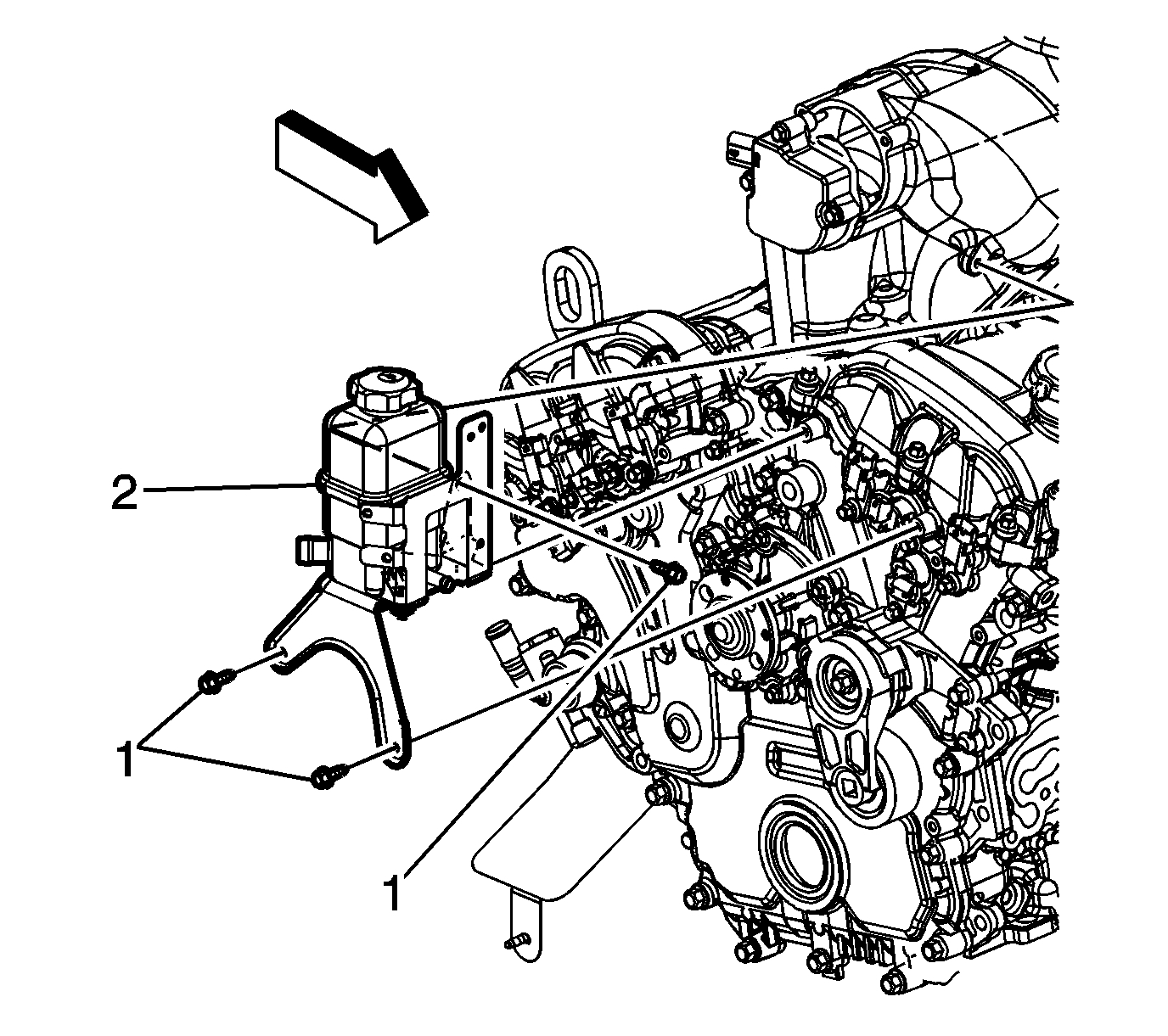

3. Remove the power steering fluid reservoir bracket bolts (1).
4. Remove and reposition the power steering fluid reservoir bracket (2) out of the way.
5. Disconnect the engine wiring harness electrical connector (8) from the bank 2 intake camshaft position (CMP) sensor (7).
6. Remove the CMP sensor bolt and sensor (3).
