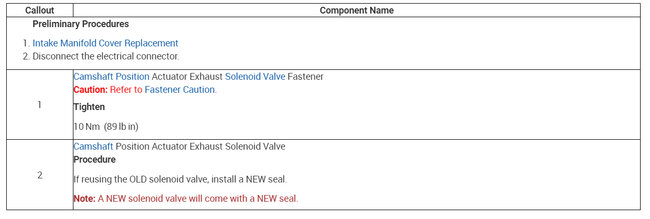

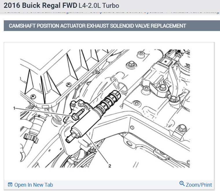

The first thing I would do is make sure the engine oil is full and clean. If so, I would swap out the exhaust camshaft oil control valve. Here is the location in the images below.
code P0017 Position Correlation (Bank 1)" error.
Check out the images (below). Please let us know how it goes.
