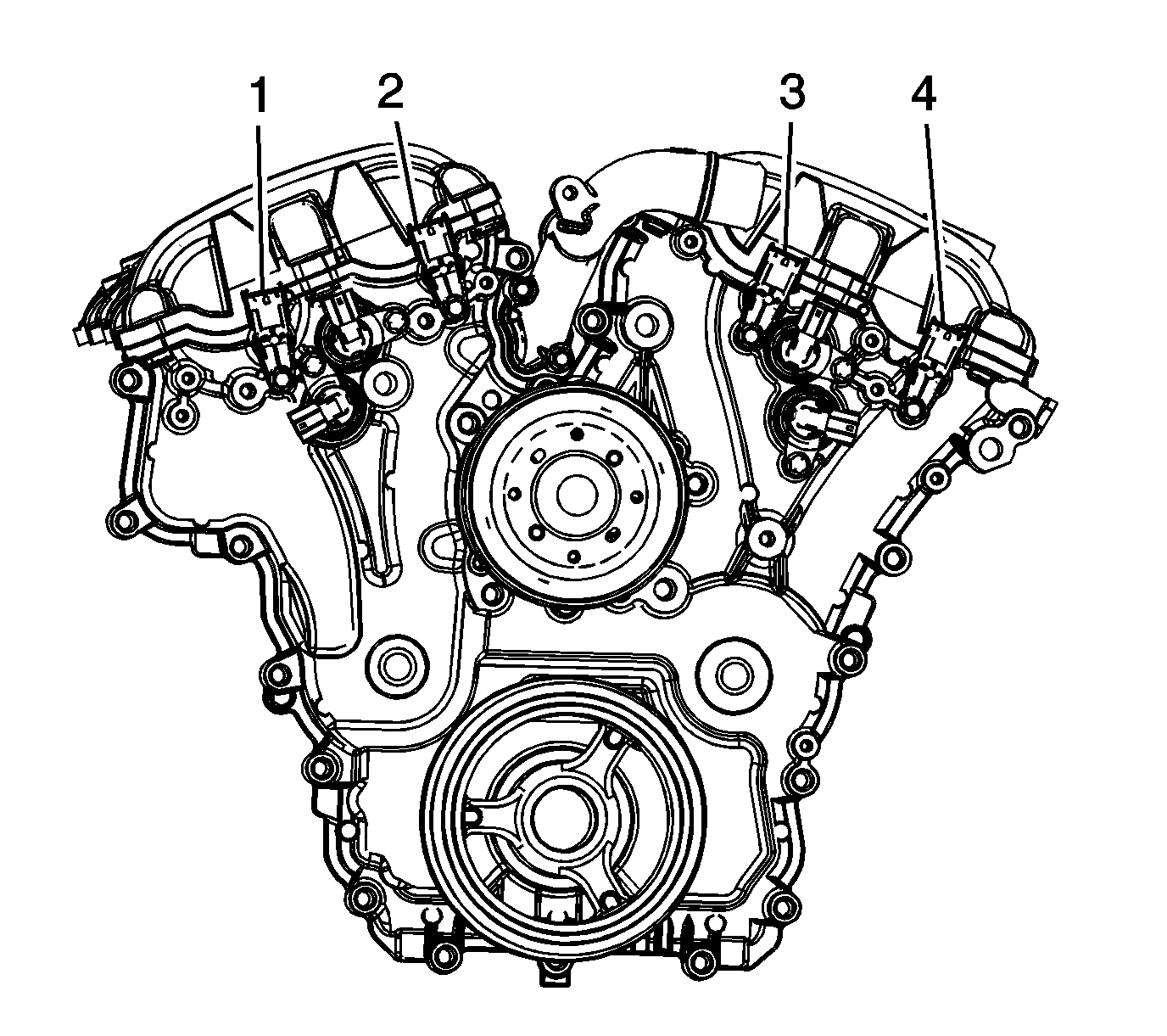

I'm getting P0017 code -Camshaft Position Correlation Bank 1 Sensor B. Where is this sensor located on the engine and how to get to it to remove and replace? Car runs great however the check engine light comes back on after clearing the codes.
Jun 27, 2019 at 2:10 AM
  • 110,240 POSTS
Welcome to 2CarPros.
Sensor B is the exhaust cam. Here are the directions for replacing bank 1 sensor B. In picture 1 (below), I highlighted the sensor you are referring to. Here are the directions for replacement. All remaining pictures correlate with the directions.
CAMSHAFT POSITION SENSOR REPLACEMENT - BANK 1 (RIGHT SIDE) EXHAUST

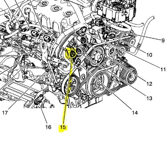

pic 2
1. Disconnect the engine wiring harness electrical connector (7) from the bank 1 exhaust camshaft position (CMP) sensor (6).

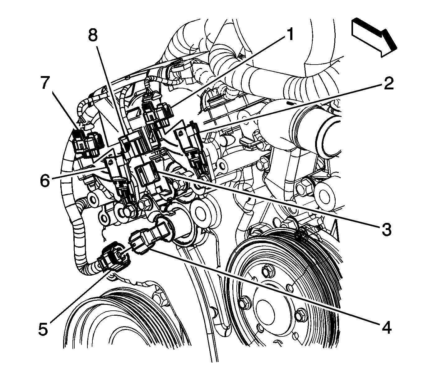

pic 3
2. Remove the CMP sensor bolt and sensor (1).
