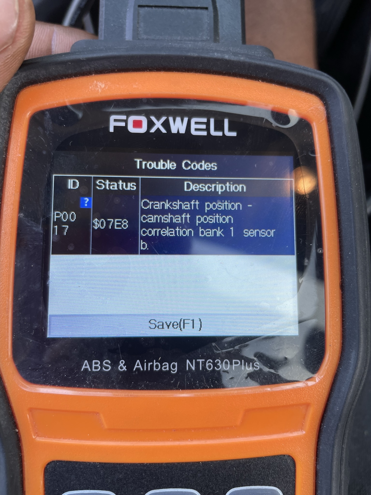

Code p0017, hard starting issue
2013 CADILLAC ATS
175,000 MILES • 2.0L • 4 CYL • 2WD • AUTOMATIC
DAMSON2021
  • 6 POSTS

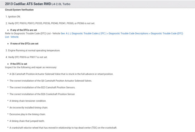

Experiencing a hard start maybe 3 or 4 times before it starts. I replaced the crankshaft and camshaft but still same thing.
Jul 5, 2022 at 9:52 AM
  • 110,194 POSTS

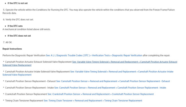

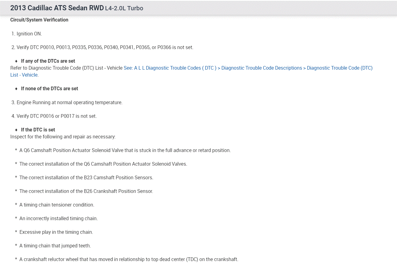

The code could be caused by a few different things. First, the actuator could be faulty, not properly installed, or there could be a wiring issue. Also, there could be an issue with the timing chain or chain tensioner allowing excessive play in the chain and throwing off timing.
Take a look below at the diagnostics related to the code and let me know if you are comfortable performing the tests.
Take care and let me know what you find.
