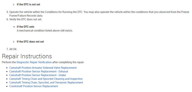

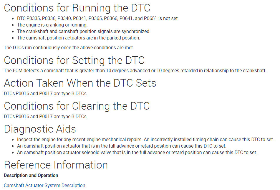

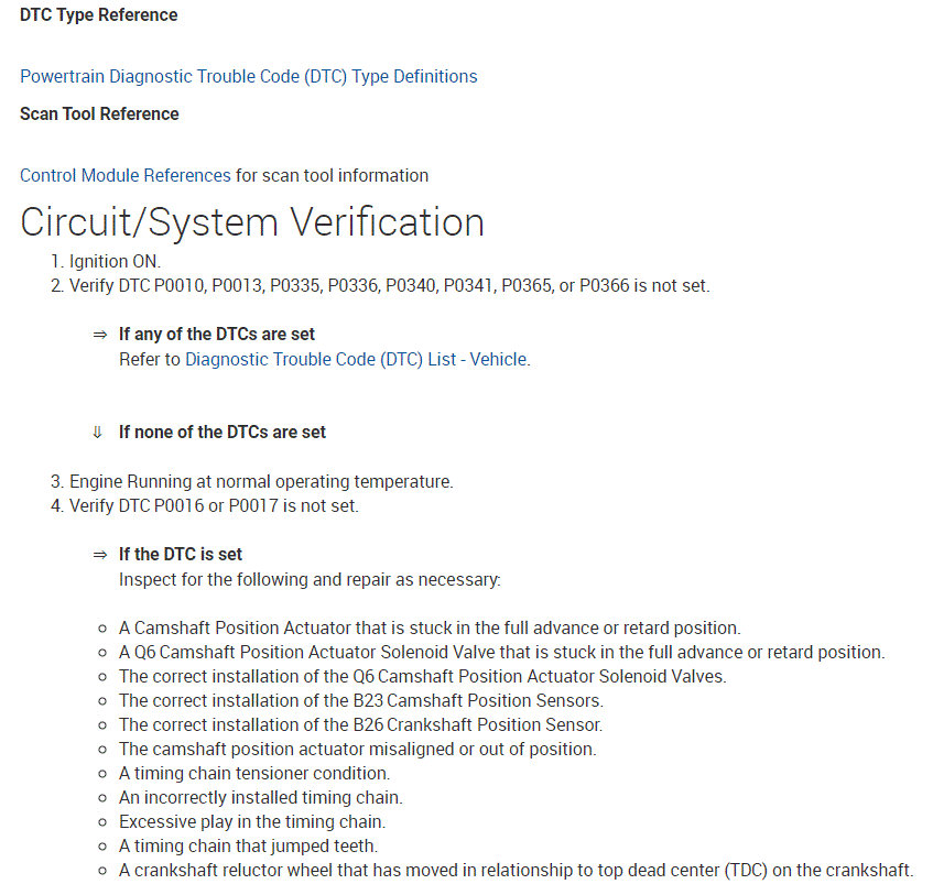

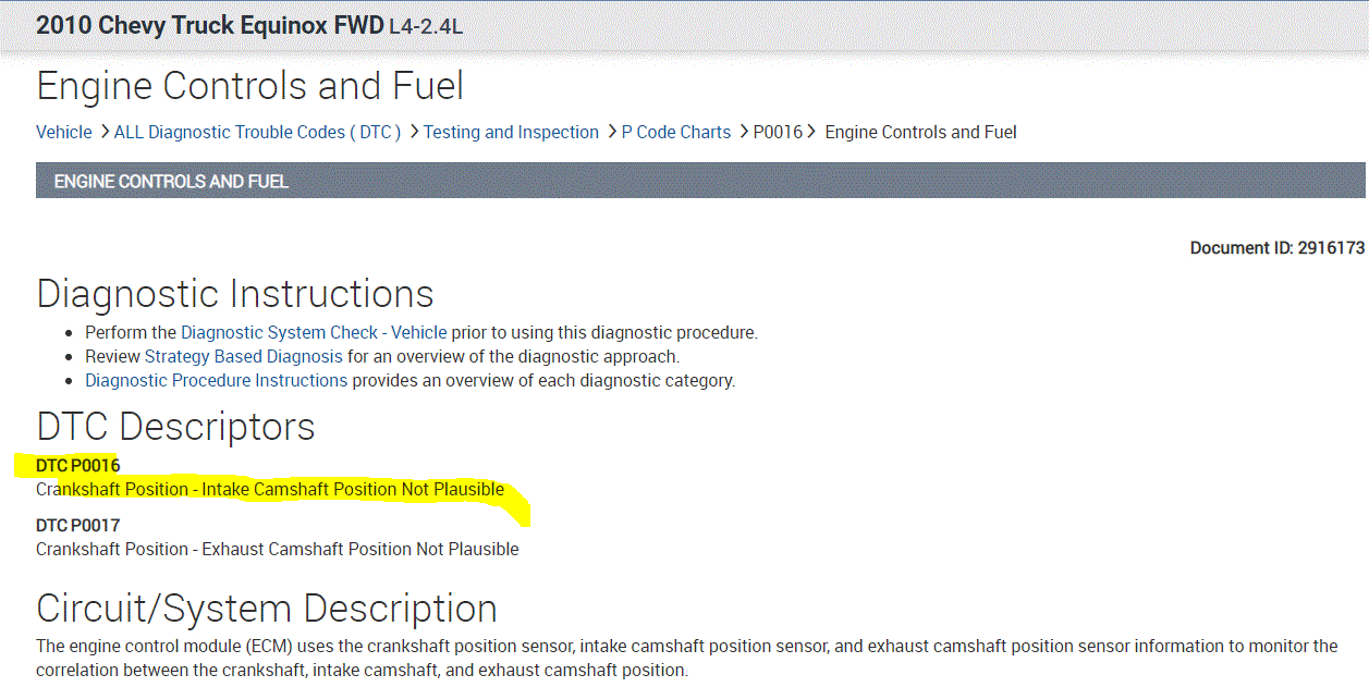

The code is related to a correlation issue between the crankshaft and the camshaft. If you are certain the timing was correct, take a look through the attached diagnostics for this code.
Take a look through the diagnostics and let me know if it is something you feel comfortable doing.
