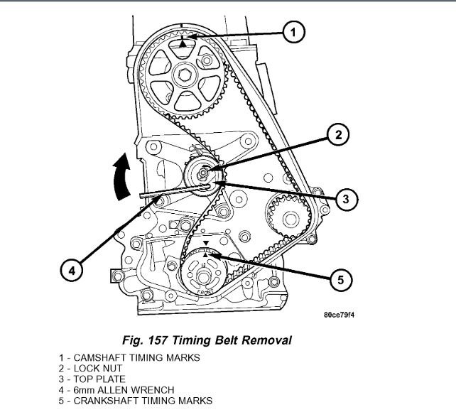

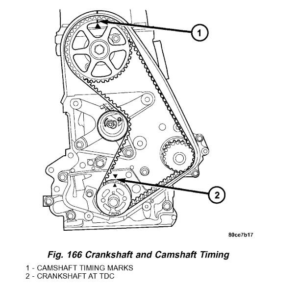

The 16 code is for cam/crank correlation which means the marks are off.
I attached the marks for you to verify. Sounds like you need to either replace the belt or adjust the tensioner.

Did you remove the front cover for the belt and verify the marks?

Yes, I have the marks are in the same place as they were when we did belt change.

I took it apart to down to the belt after it started throwing the code I thought that might be it but all is lined up and verified I guess my next step is wiring seeing if I have a wire failure somewhere. Because it makes no sense I can put old sensor in and run the car for 2 days with out it throwing the code. I put be sensor in the car and it throws the code with two different new sensors.
Jun 14, 2019 at 6:40 AM
I know it looks like I am beating you up with the timing, but it is not a sensor. You are stuck on a sensor issue.
This code indicates the cam and crank are not lined up correctly.
