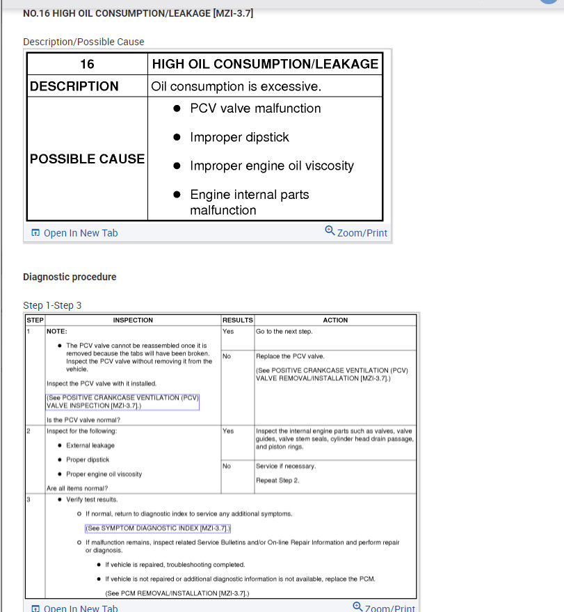

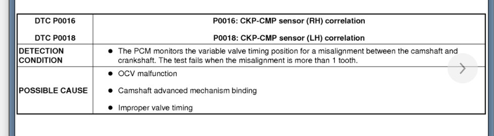

This could could be caused by low oil as the oil control valve on these engine are sensitive to oil level and viscosity. So even using the wrong oil can cause these issues.
Here is a guide that talks about this in more detail:
https://www.2carpros.com/articles/how-camshaft-variable-valve-timing-works

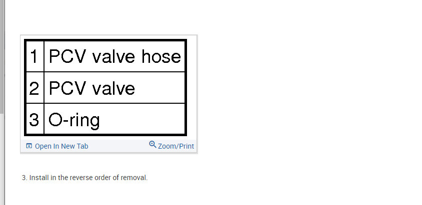

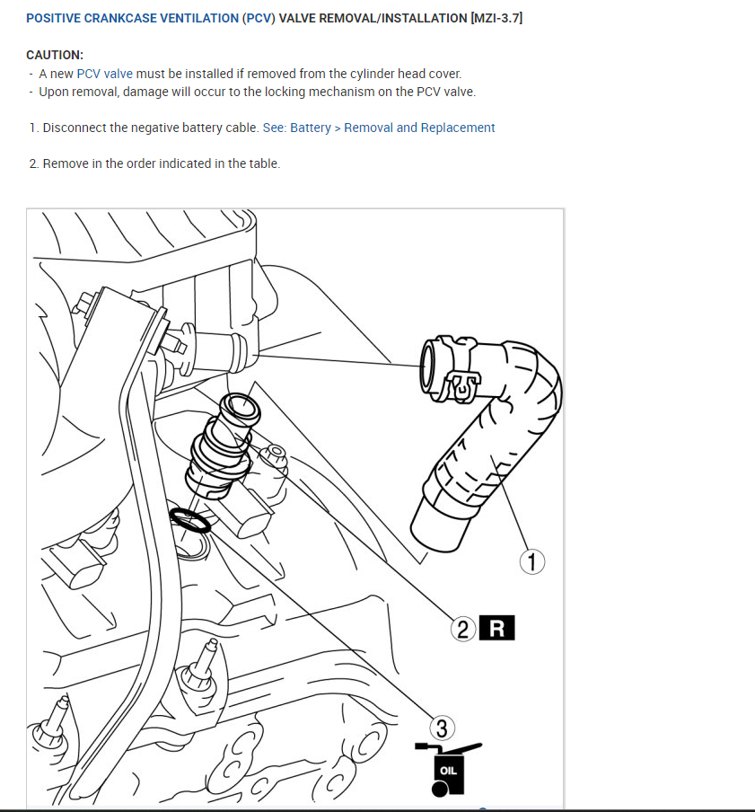

What I would do is start an oil consumption test to find out how much oil you are burning. This is the likely cause of using so much oil that it gets low this quickly.

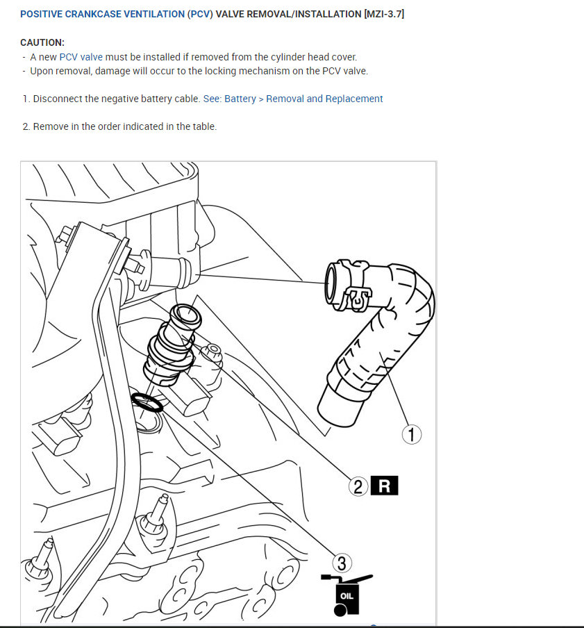

Also, I would remove and replace the PCV valve because that will cause excessive oil use as well. The process is below.
Please run through this info and let us know what you find. Thanks

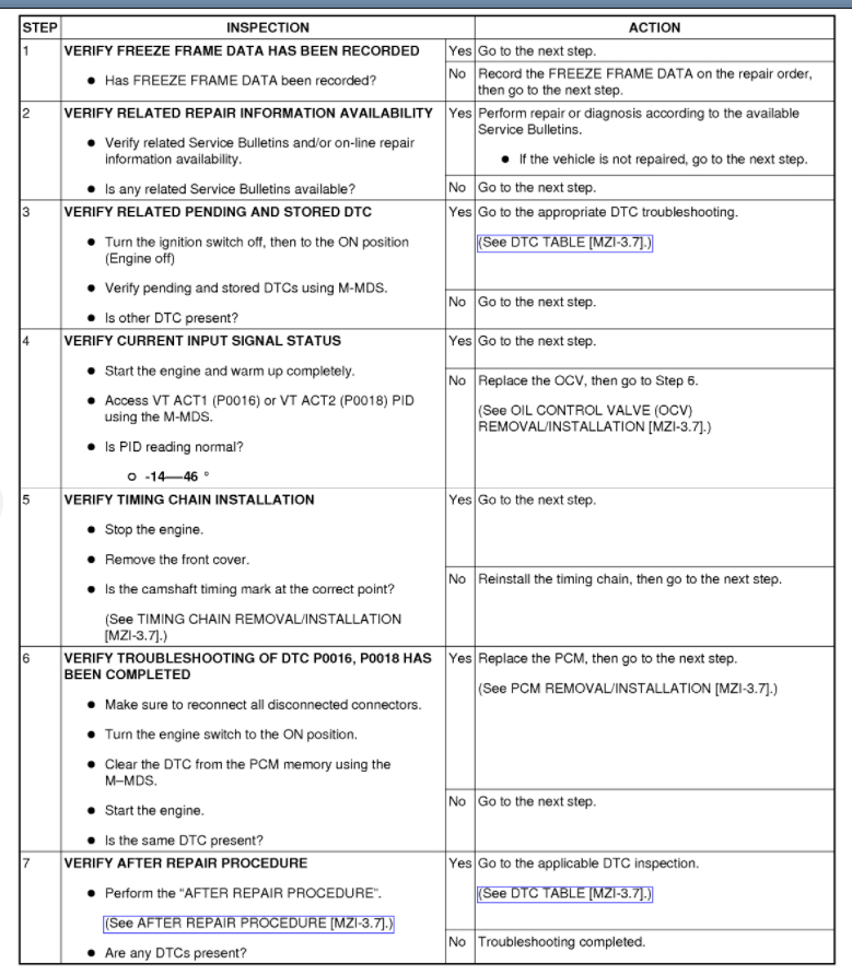

Yes. More than likely there is an issue but this is the place to start. If the oil level is correct and the code is still active then we are going to have to run through this testing.
Take a look below and let us know if you have questions on this. This requires a scan tool so it is not the easiest testing to do.

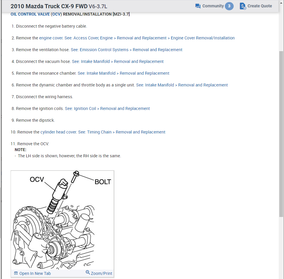

Cool, thanks. The car has 165,000 miles on it. I might just replace the oil control valve. I have a scan tool that shows engine data, but only one element at a time, and no data history.
Jul 9, 2021 at 4:16 AM

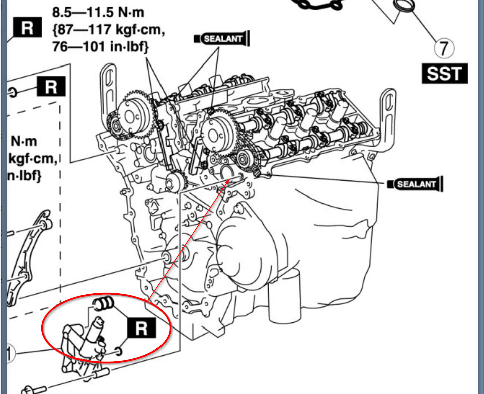

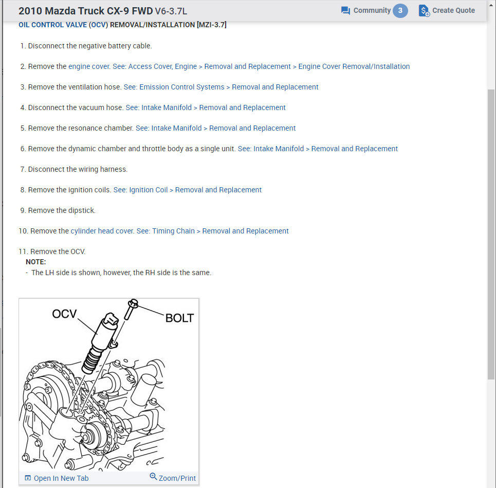

Okay. The control valve is the likely issue. Here is the process for replacing the right hand side.
Thanks
Jul 9, 2021 at 9:09 AM

Hi, replaced PCV today, was not a bad job, hard to reach, but I got it. It was clicking when I shook it, so it was not stuck, worst case is I wasted $12.00.

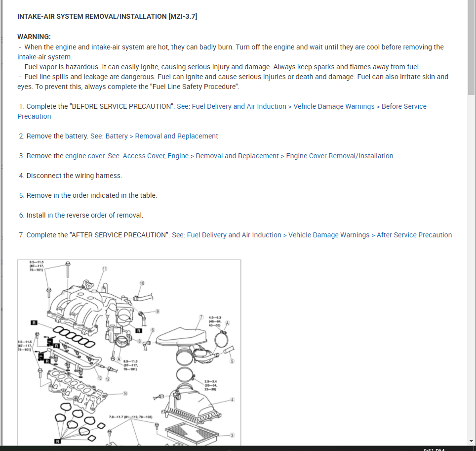

VVT valve needs to be ordered. I will go ahead and to that. It is under the head covers of the front facing block, correct? I sure hope so, getting to the rear facing bank will be a pain. I will replace the cover gasket and the gaskets for the spark plug penetrations too.
Jul 10, 2021 at 4:39 AM

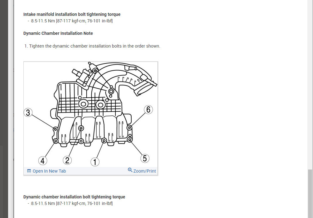

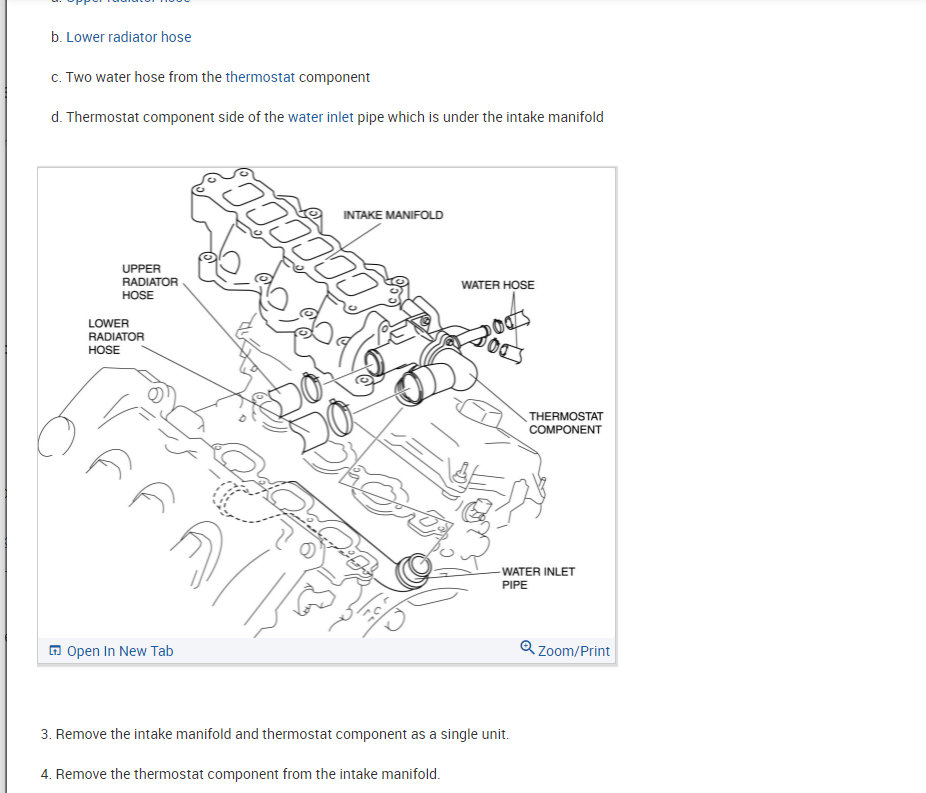

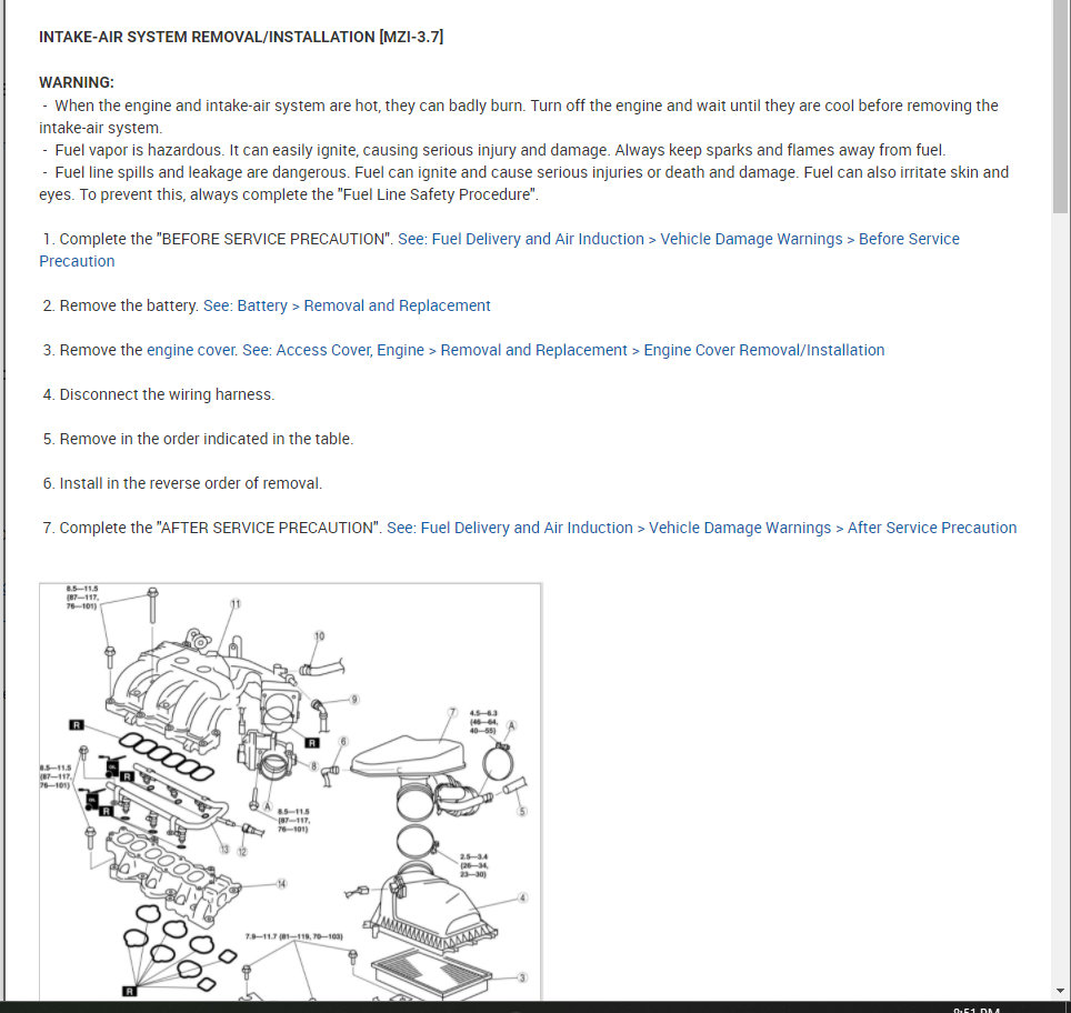

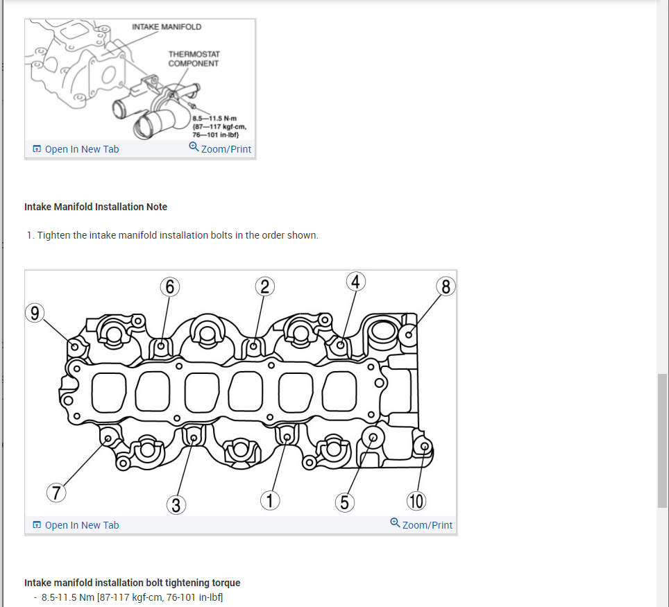

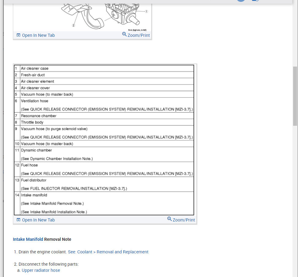

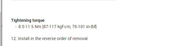

They are not on the rear. Take a look at the info below. You need to remove the intake manifold to access them so I included that process but I gave the entire process prior.
Please let us know if you have other questions. Thanks
