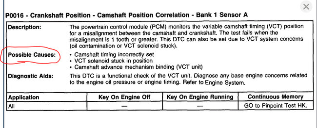

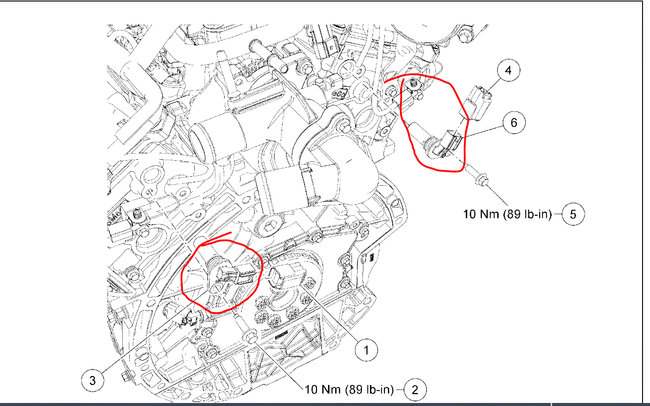

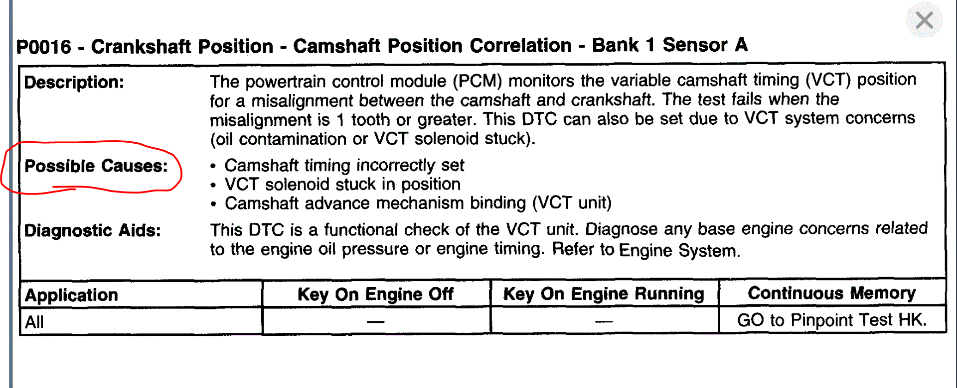

Recently threw check engine light for p0016. The cam/crank correlation. I want to check cam sensor but having trouble locating it or finding a diagram. Any help would be awesome.
Car runs smooth, doesn't seem to be driving any different at all, so i'm not thinking the timing jumped. Also no metallic bang/clicking when under the hood idle or accelerating?

They are located on the rear of the cylinder heads. See pic 1. If you look at pic 2, I provide possible causes for this code.
Let me know if this helps.

If it was the timing, wouldn't it be significantly noticeable? If there's any rough idling, it's so minor I can't notice from inside or out.
So, do you think the VCT would be more likely than the camshaft sensor itself?
Feb 12, 2020 at 1:17 PM
  • 110,240 POSTS
If the timing was off you would feel it. However, things stretch and cause timing issues while the vehicle still runs properly.
As far as the issue, I would start with the sensor. Are you sure there were no other codes?

It has to be something related to the variable camshaft system. I noted you are a beginner mechanic. I almost feel bad doing this, but I will provide a pinpoint test diagnostic procedure. It is extensive, but you may find the issue prior to going through everything.

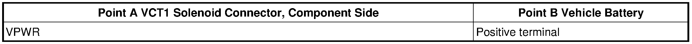

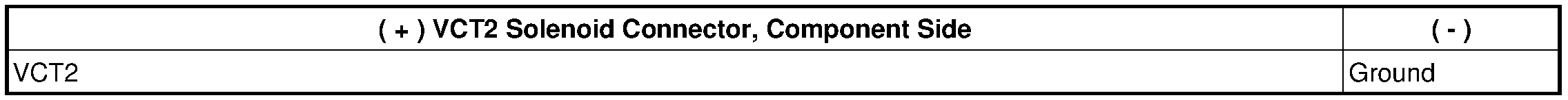

HK4 CHECK THE VCT1 SOLENOID RESISTANCE
- Ignition OFF.
- VCT1 Solenoid connector disconnected.
- Measure the resistance between:
pic 1
Is the resistance between 5 - 14 ohms?
- GO to HK5.
- INSTALL a new VCT1 solenoid.
- CLEAR the DTCs. REPEAT the self-test.

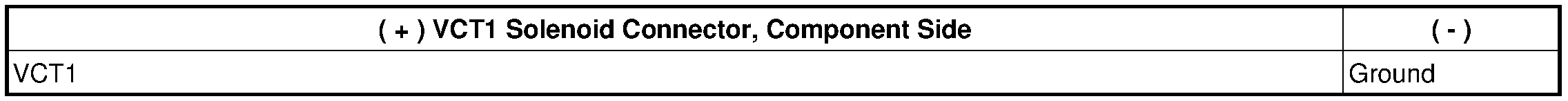

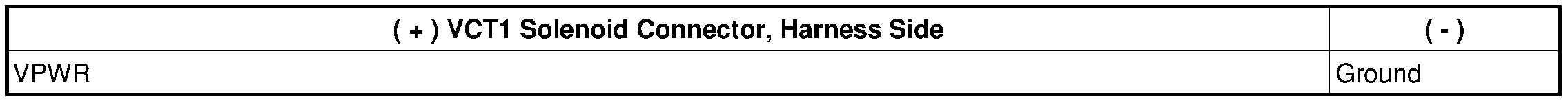

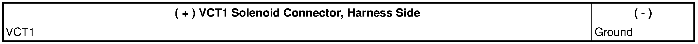

HK5 CHECK THE VCT1 SOLENOID FOR INTERNAL SHORTS
pic 2
Is the resistance greater than 10K ohms?
- GO to HK6.

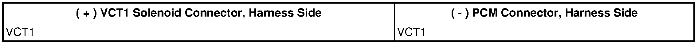

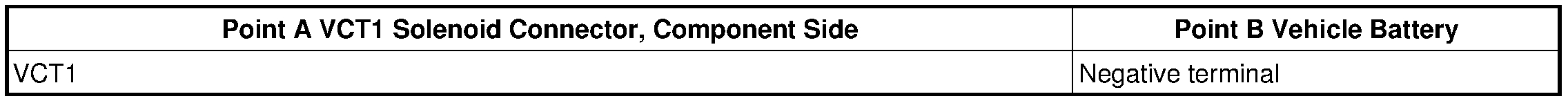

HK8 CHECK THE VCT1 CIRCUIT FOR AN OPEN IN THE HARNESS
- Ignition OFF.
pic 5
Is the resistance less than 5 ohms?
- GO to HK9.
- REPAIR the open circuit. CLEAR the DTCs. REPEAT the self-test.

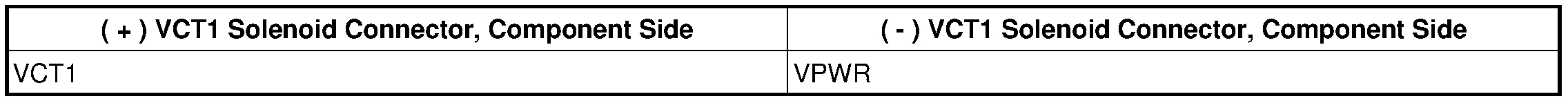

HK9 CHECK THE VCT1 CIRCUIT FOR A SHORT TO GND IN THE HARNESS
pic 6
- GO to HK20.
- REPAIR the short circuit. CLEAR the DTCs. REPEAT the self-test.

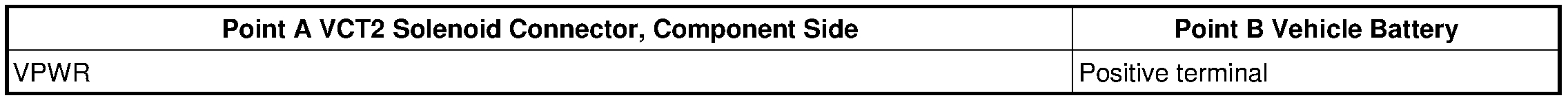

HK10 DTC P0020: CHECK THE VCT2 SOLENOID RESISTANCE
- Ignition OFF.
- VCT2 Solenoid connector disconnected.
pic 7
- GO to HK11.
- INSTALL a new VCT2 solenoid.

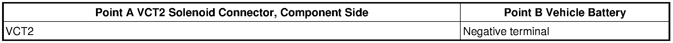

HK12 CHECK THE VPWR CIRCUIT FOR AN OPEN IN THE HARNESS
- Ignition ON, engine OFF.
- Measure the voltage between:
pic 9
Is the voltage greater than 10 V?
- GO to HK13.

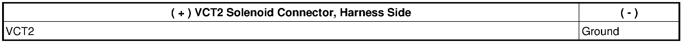

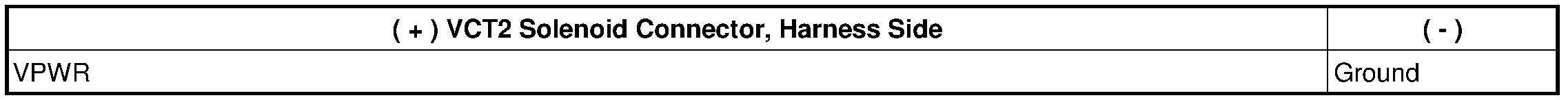

HK13 CHECK THE VCT2 CIRCUIT FOR A SHORT TO VOLTAGE IN THE HARNESS
- Ignition OFF.
- PCM connector disconnected.
pic 10
Is the voltage less than 1 V?
- GO to HK14.

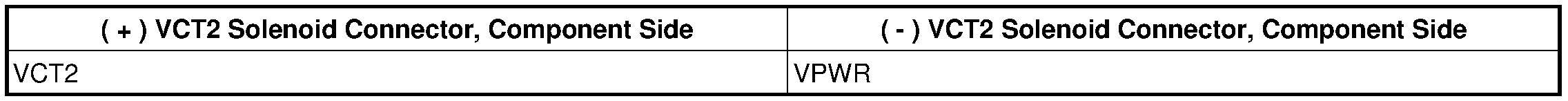

HK14 CHECK THE VCT2 CIRCUIT FOR AN OPEN IN THE HARNESS
- Ignition OFF.
pic 11
- GO to HK15.
