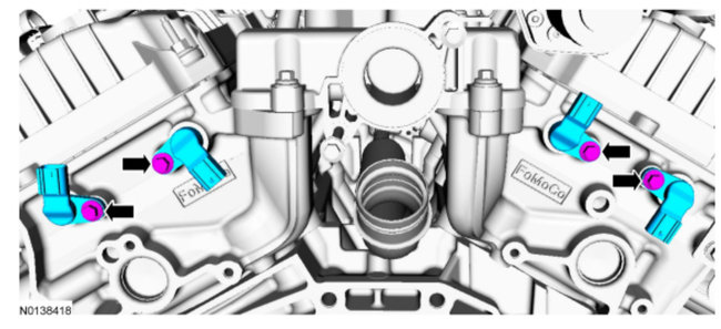

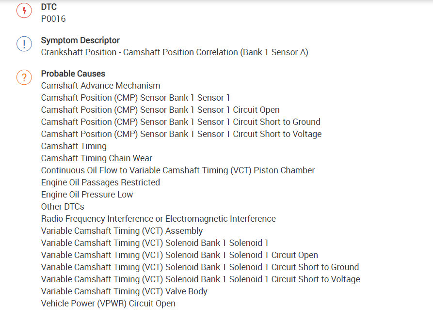

Code P0016, camshaft position sensor bank 1 location needed
2019 FORD TAURUS
66,000 MILES • 3.5L • V6 • 4WD • AUTOMATIC
AYAD MOZAFFER
Can you please help me guys find out what is this issue? Also I want to know where is the camshaft position sensor located? Bank 1
Mar 16, 2021 at 7:56 AM
Good morning,

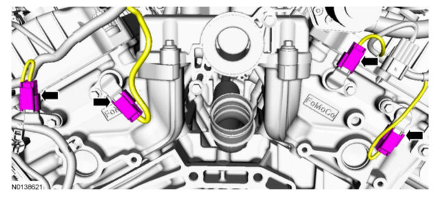

I attached diagrams for the sensors. You have 4 cam sensors, 2 for each side.
The one for the code 16 I circled in the one picture below for you.
https://www.2carpros.com/articles/camshaft-angle-sensor-replacement
They are on the back of the motor and it is tight to get to them.

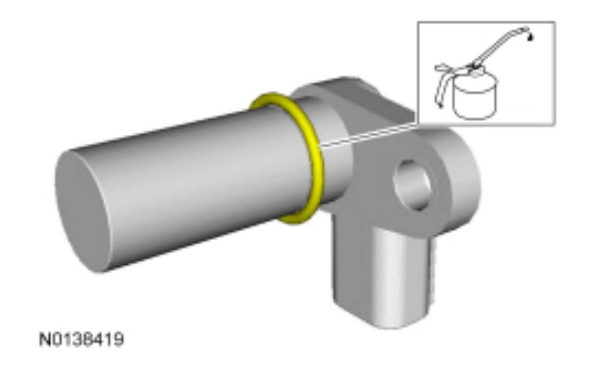

303-14 Electronic Engine Controls 2019 Taurus, Police Interceptor - Sedan
REMOVAL AND INSTALLATION
Camshaft Position (CMP) Sensor — 3.5L Ti-VCT, 3.7L Ti-VCT
Material
Item Specification
Motorcraft® SAE 5W-20 Synthetic Blend Motor Oil (US); Motorcraft® SAE 5W-20 Super Premium Motor Oil (Canada)
XO-5W20-QSP (US); CXO-5W20-LSP12 (Canada) WSS-M2C945-A
Removal
NOTE: Removal steps in this procedure may contain installation details.
Remove the Air Cleaner (ACL) outlet pipe and the ACL . For additional information, refer to Section 303-12 .
To install, tighten to 10 Nm (89 lb-in).
Installation
To install, reverse the removal procedure.
Apply the specified lubricant to the specified component.
Motorcraft® SAE 5W-20 Premium Synthetic Blend Motor Oil (US); Motorcraft® SAE 5W-20 Super Premium Motor Oil (Canada) XO-5W20-QSP (US); CXO-5W20-LSP12 (Canada).
