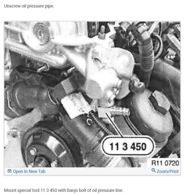

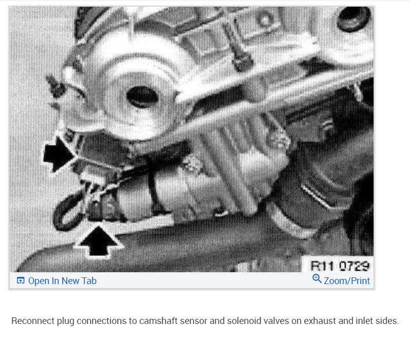

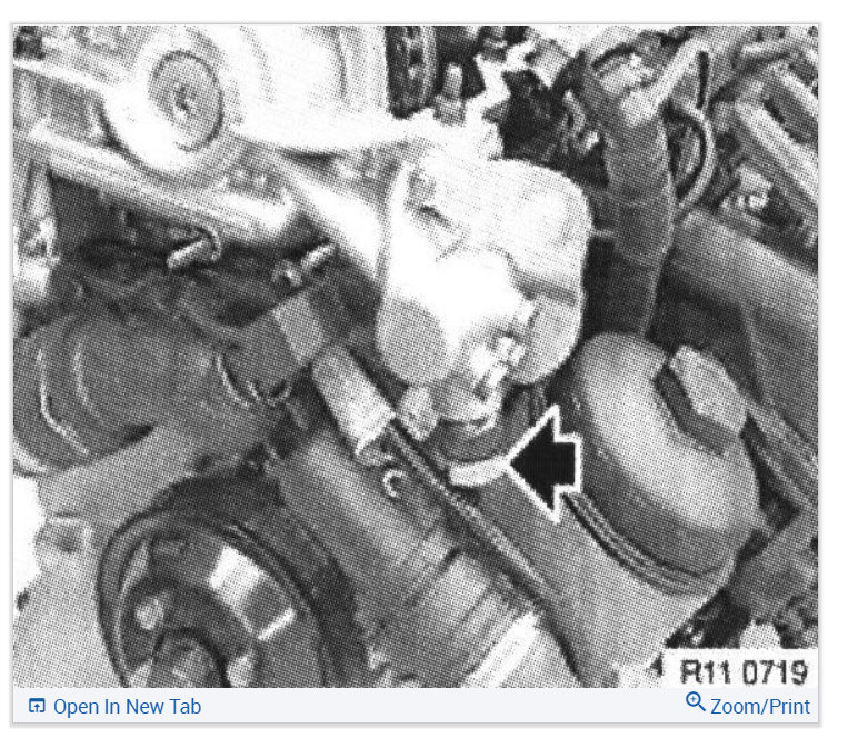

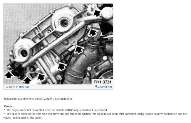

Hi, I installed new vanos solenoids and new cam sensors.
car still stalls while driving and switches when stop.
OBD states subject code.
Mar 10, 2019 at 4:29 PM
  • 55,402 POSTS

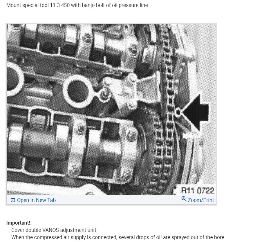

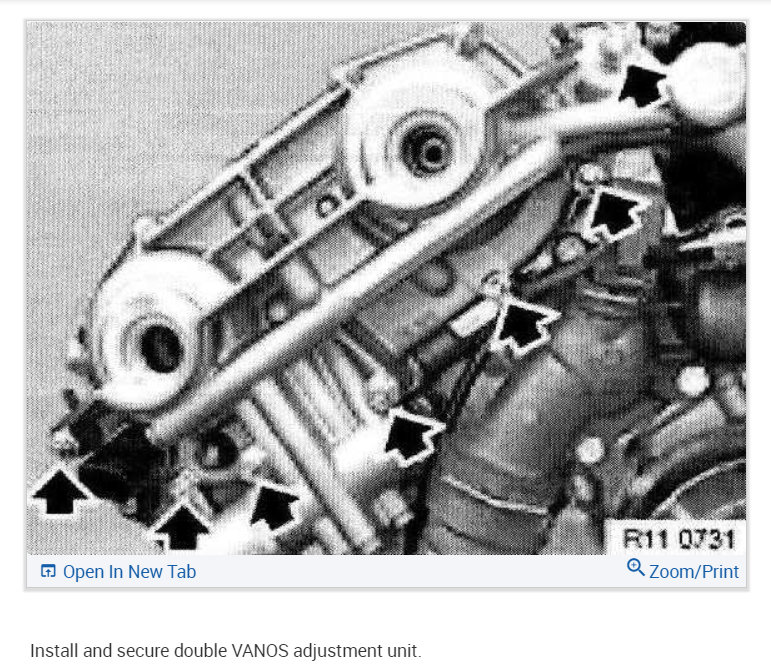

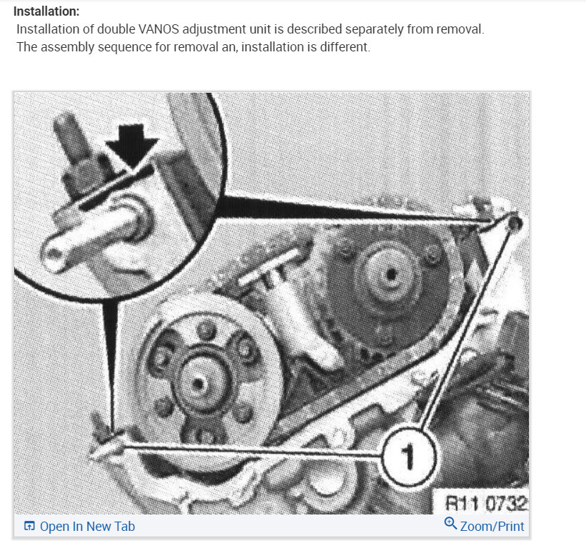

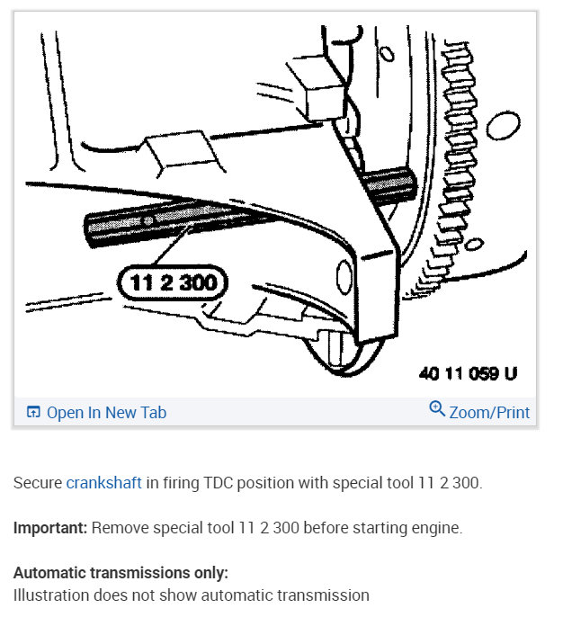

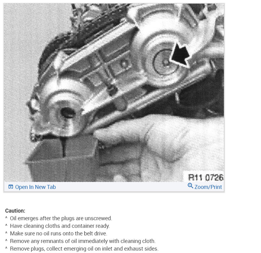

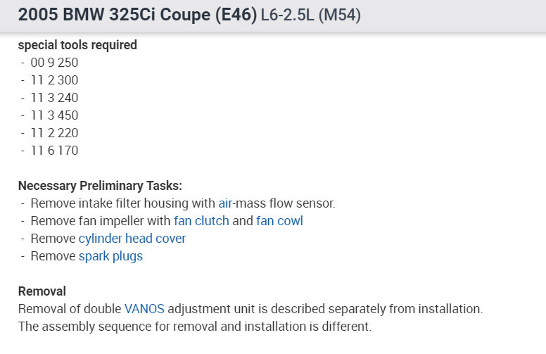

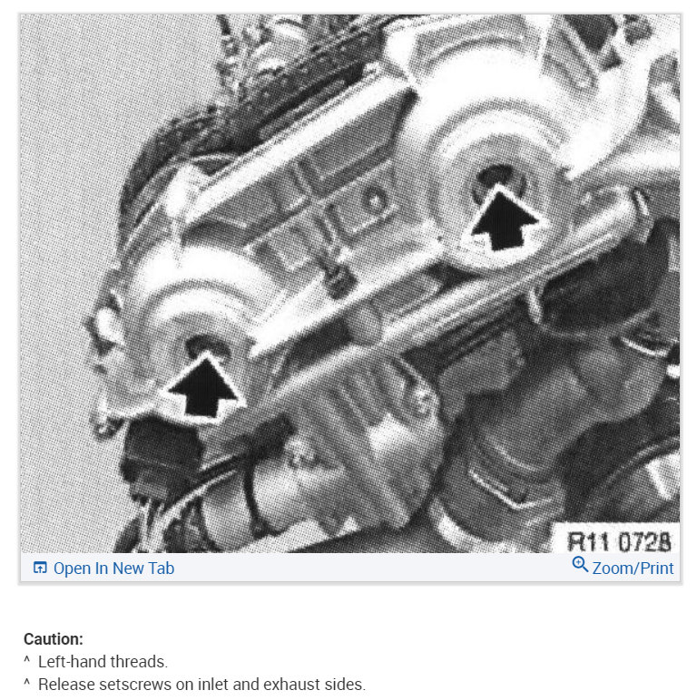

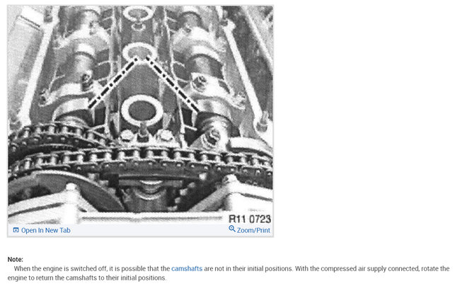

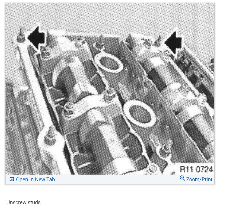

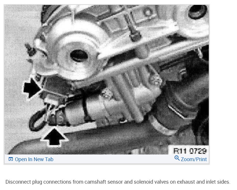

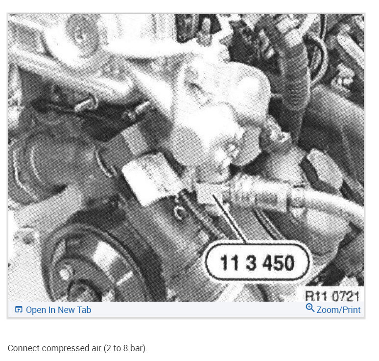

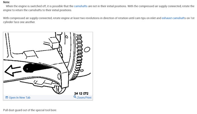

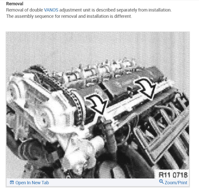

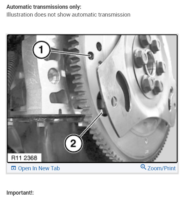

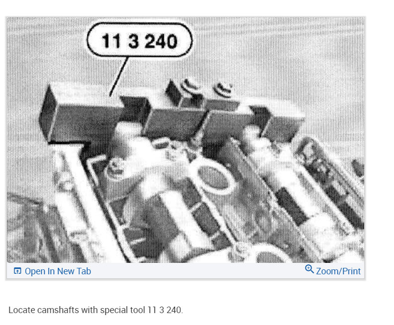

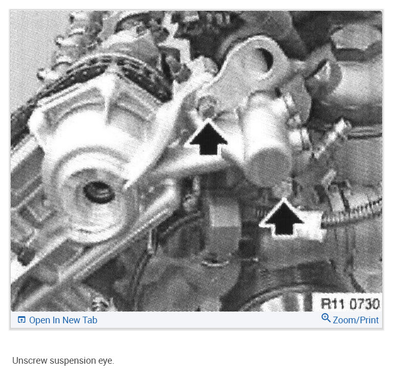

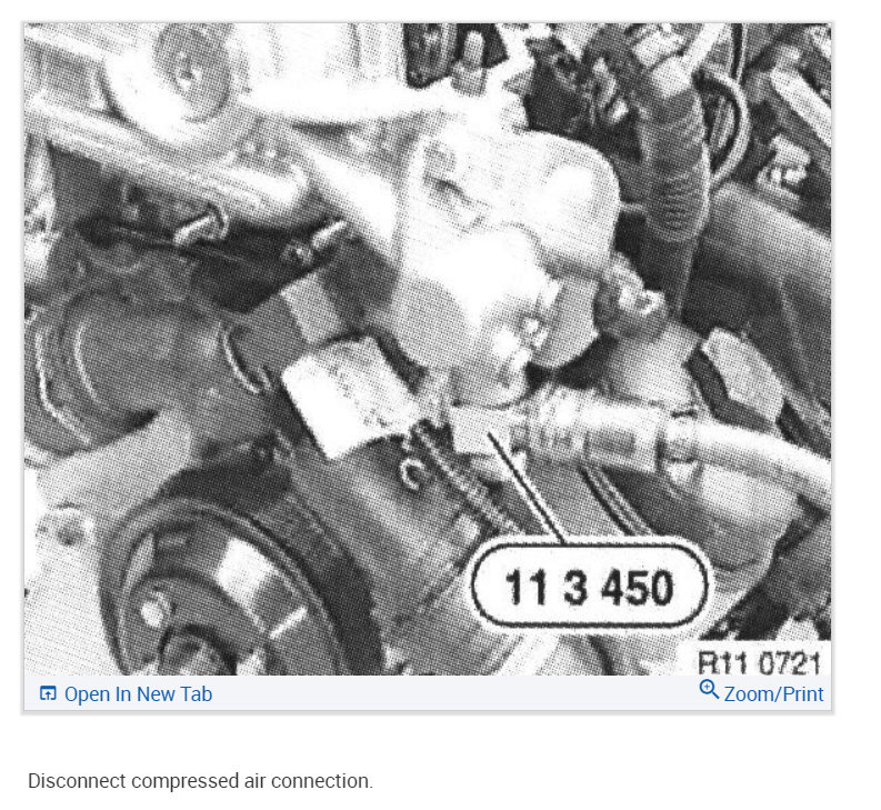

When you put the engine back together did you clear the adaptation? This code comes up when the camshaft timing is off. Did you use the alignment tools made for the job? Here are diagrams to help you see if the timing marks are on. Make sure the vanos is bottomed out. Check out the diagrams (below). Please let us know what you find. We are interested to see what it is.
