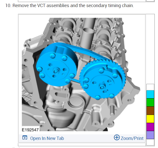

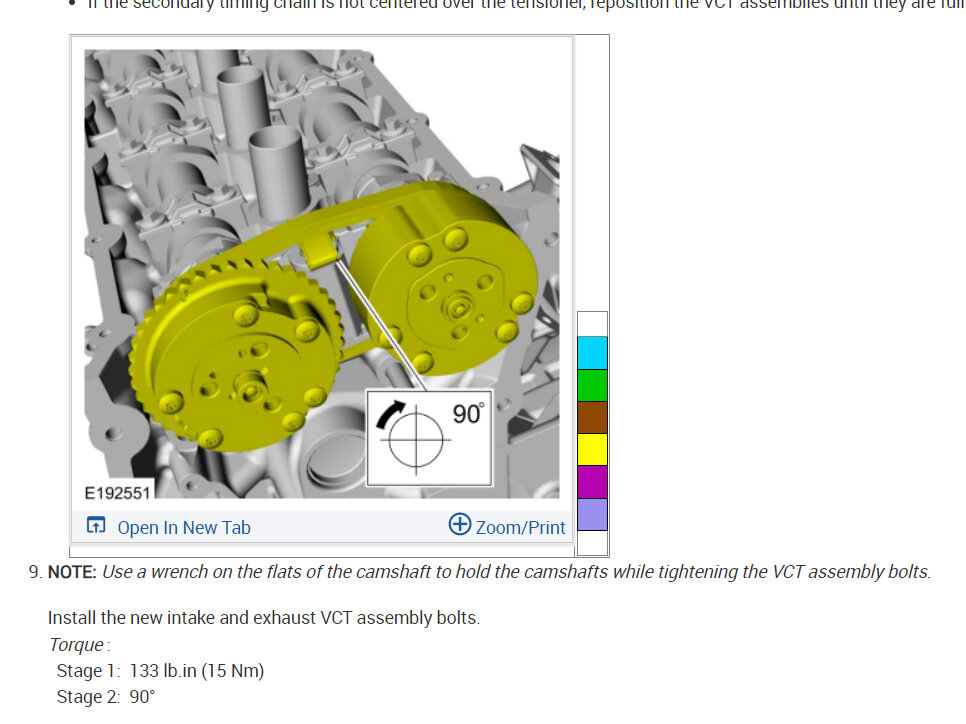

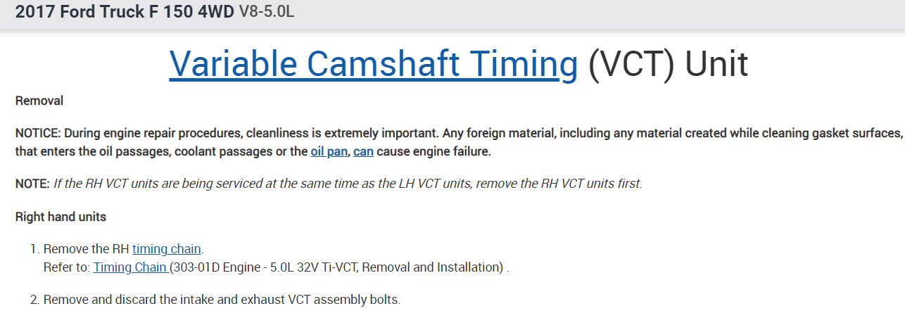

I have a P0013: Exhaust “B” Camshaft Position Actuator Circuit/Open (Bank 1) code error on my truck listed above. We have tried oil changes to see if the issue goes away but it has not. How much can I roughly expect to pay to remove/replace both banks of actuators (since I figure it best to replace both while they are in there, since I believe there are 2 banks)? I can provide the VIN if this is helpful. I just want to make sure the estimate I receive is not overly inflated. Thank you.
Jan 24, 2024 at 4:48 AM
  • 55,395 POSTS

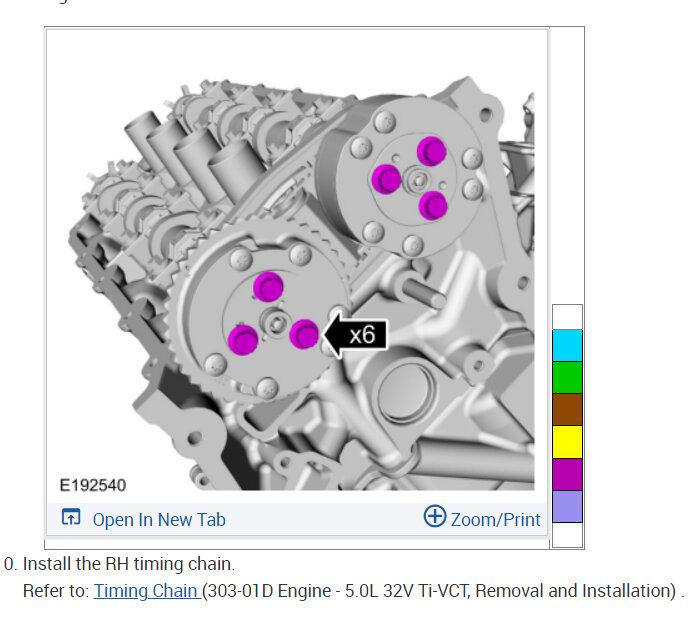

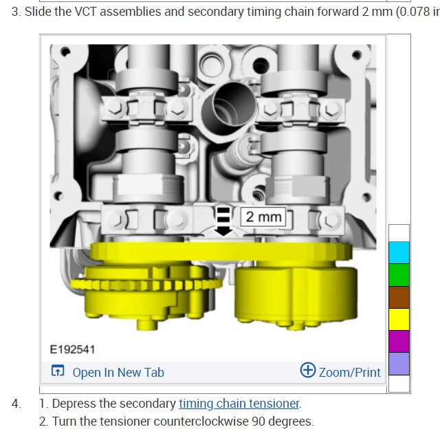

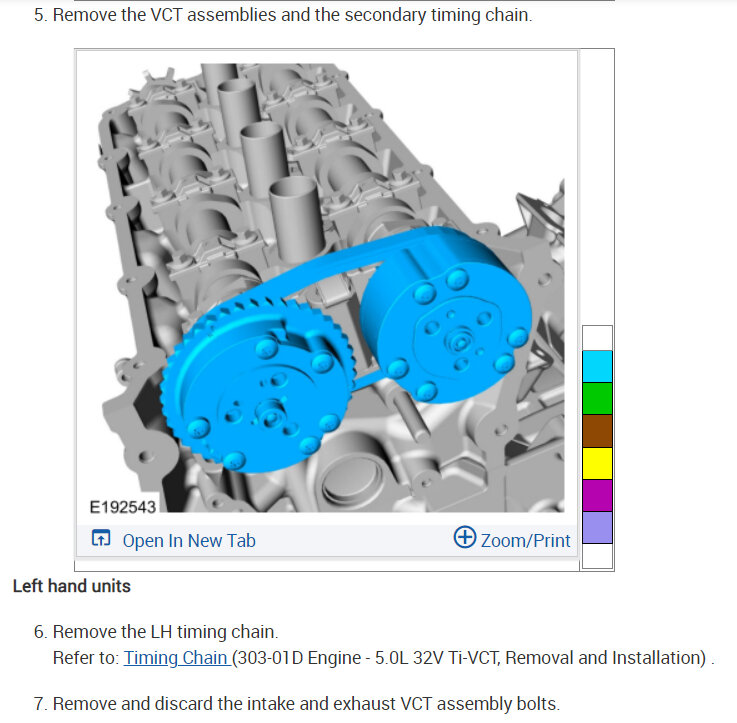

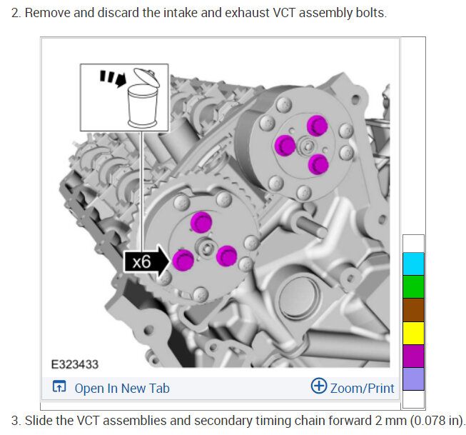

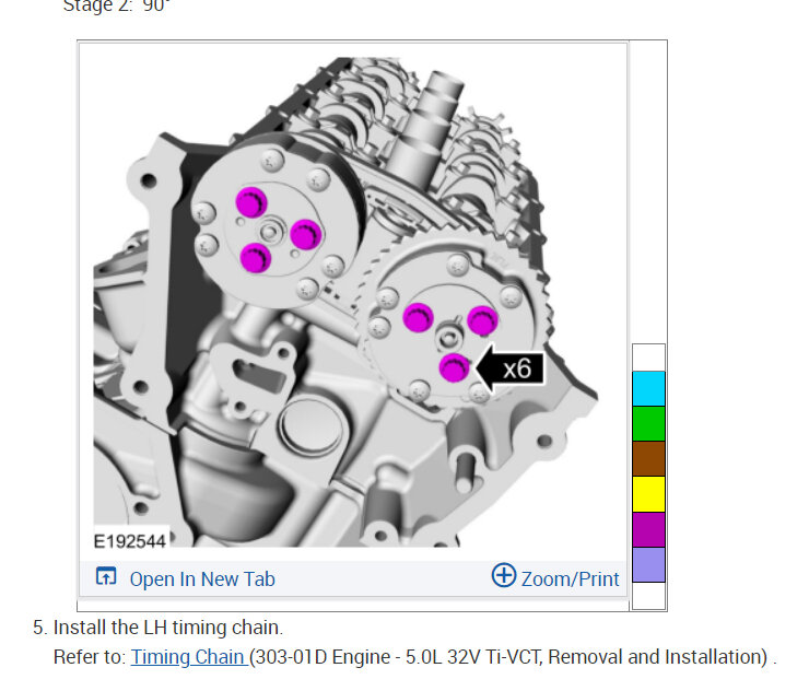

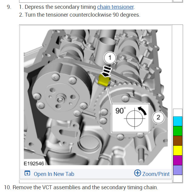

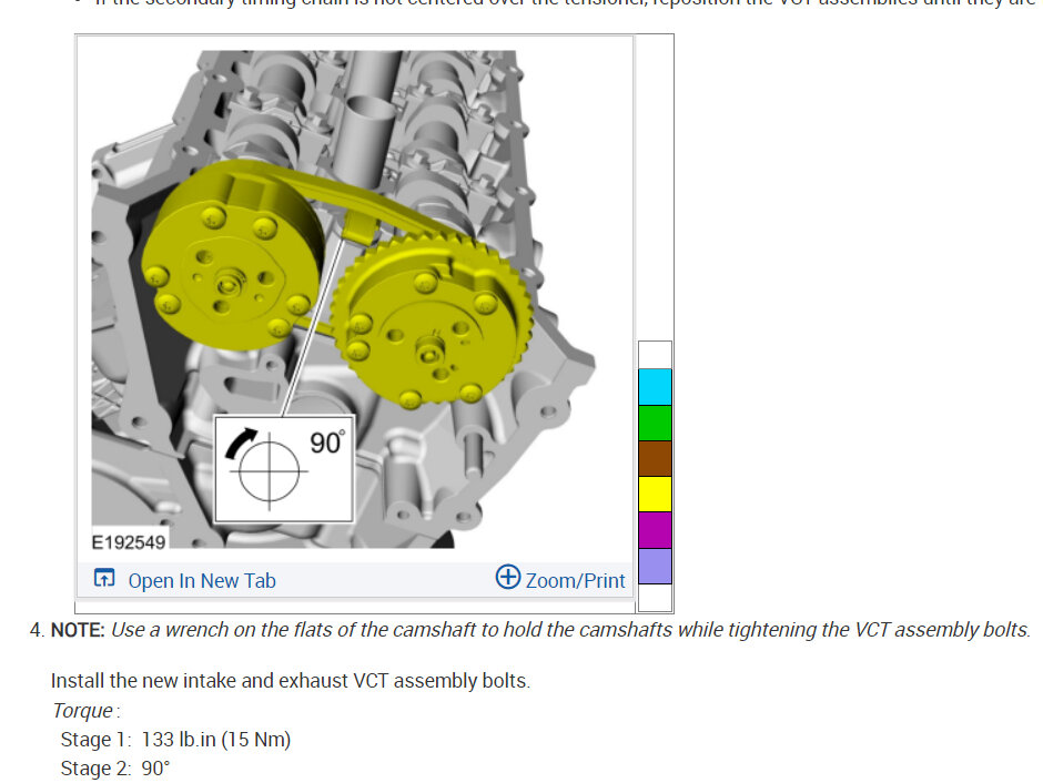

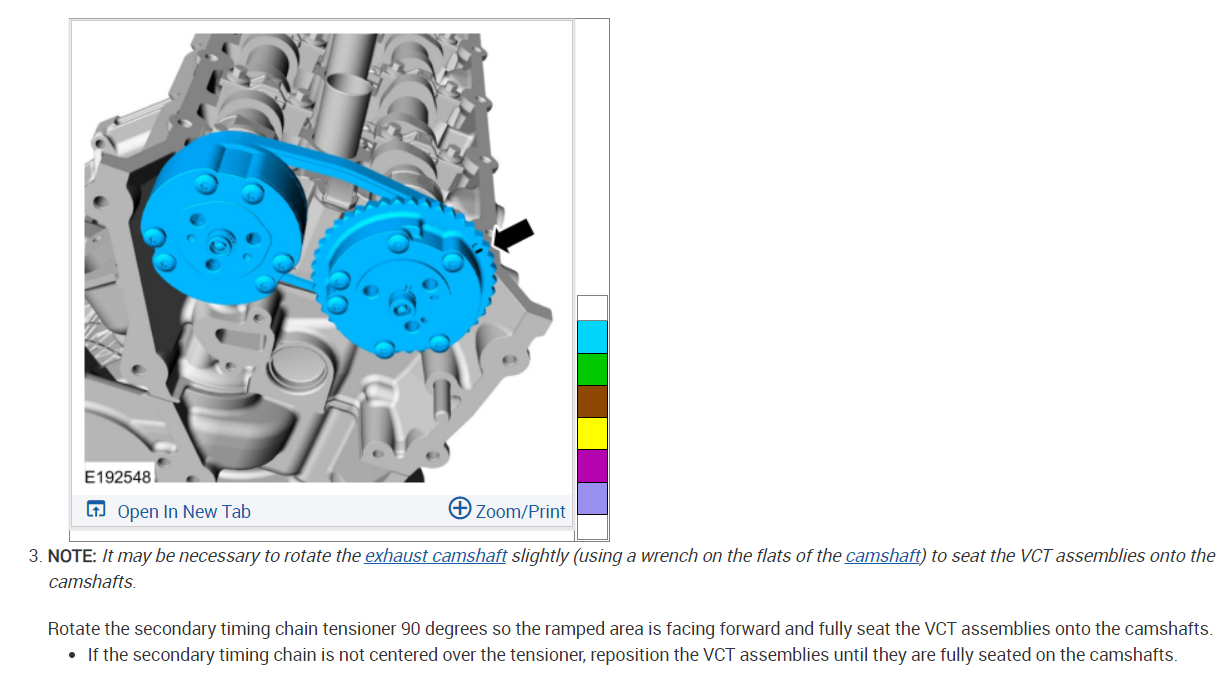

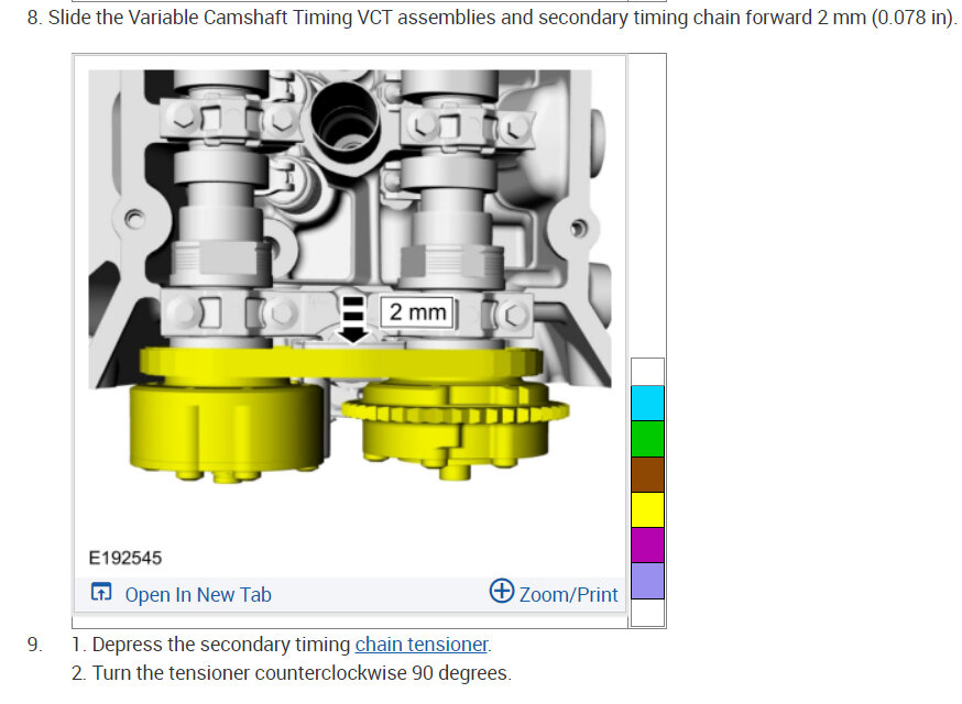

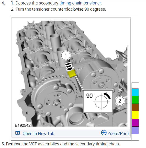

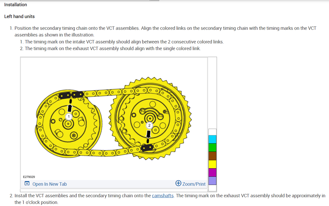

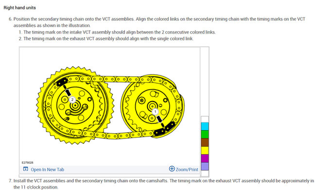

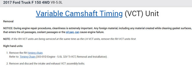

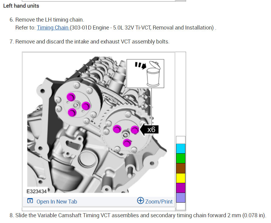

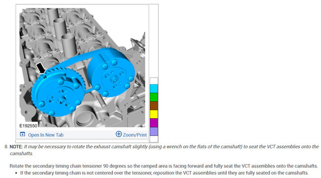

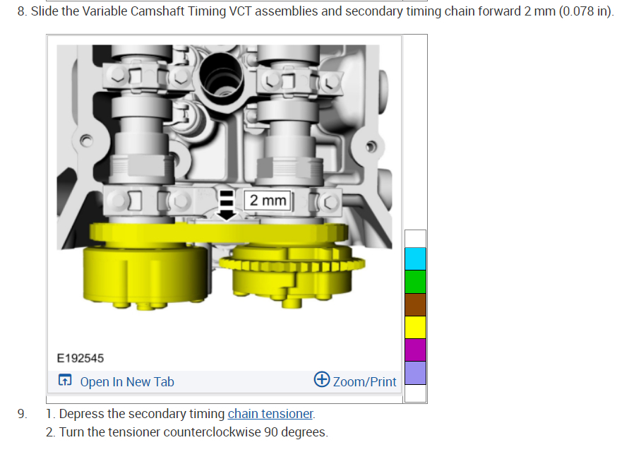

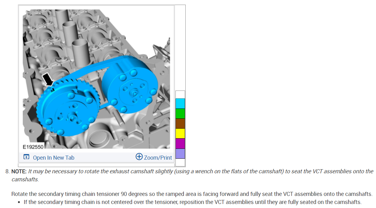

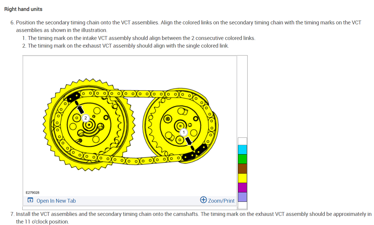

Sure, yep, these actuators have problems, but Ford does make an updated unit which I would get. Here is how the job is done and the approximate cost. Remember that oil, gaskets coolant etc., are not included. Yes, there are two banks.
23 - Exhaust FL3Z6C525A - $176.67
23 - Intake FR3Z6256B - $183.33
Left Bank 8.4 HRS@ shop rate
Right Bank 8.0 HRS@ shop rate
Both Banks 8.5 HRS@ shop rate
You might want to think about doing the guides, tensioner and chains as well. The diagrams below feature the timing marks as well. Check out the images (below). Let us know if you need anything else.
