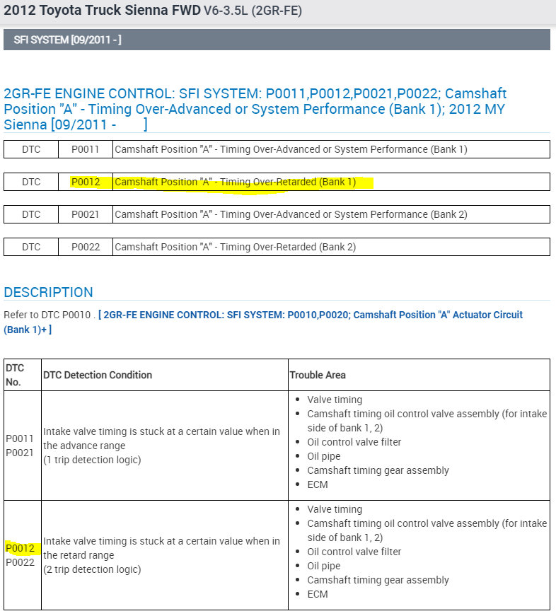

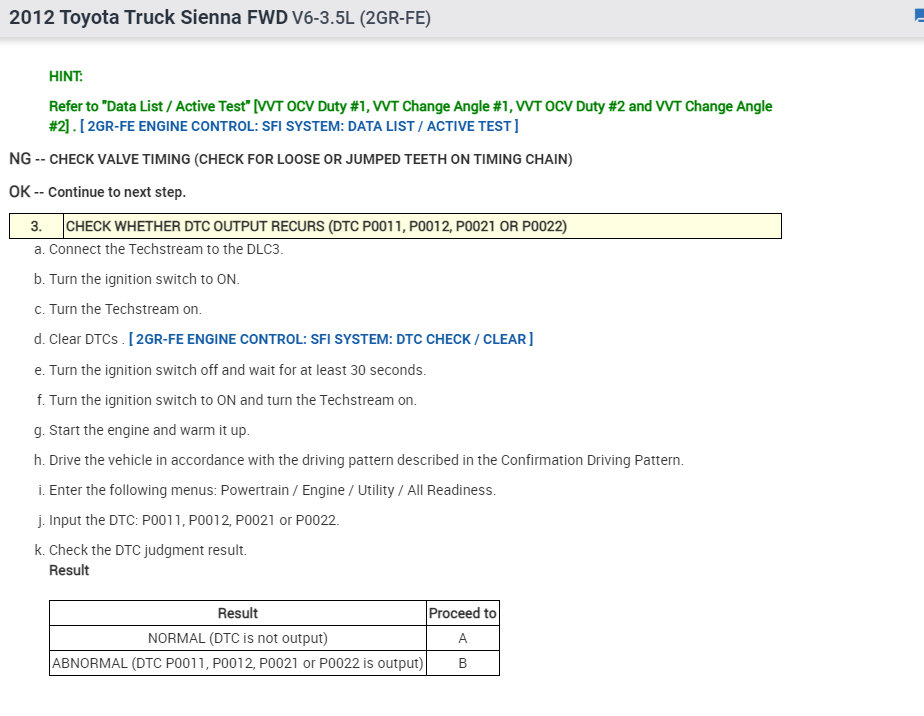

P0012 code
2012 TOYOTA SIENNA
155,000 MILES • V6 • 2WD • AUTOMATIC
DIVIDES
  • 903 POSTS

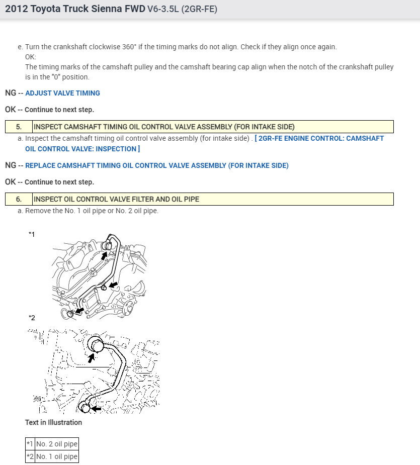

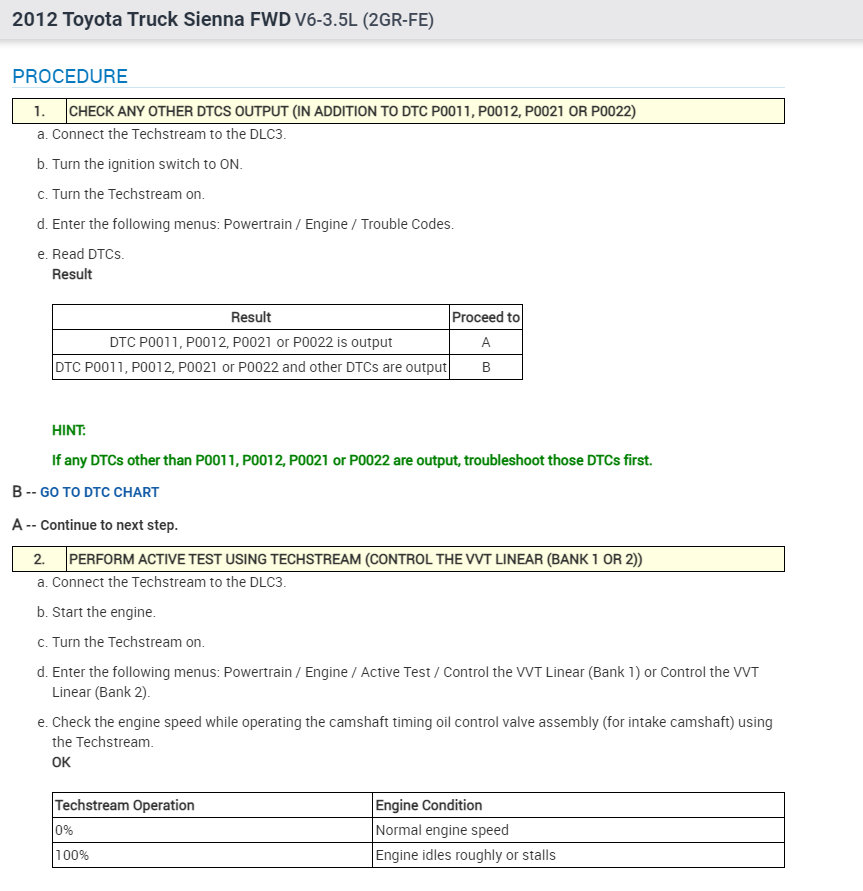

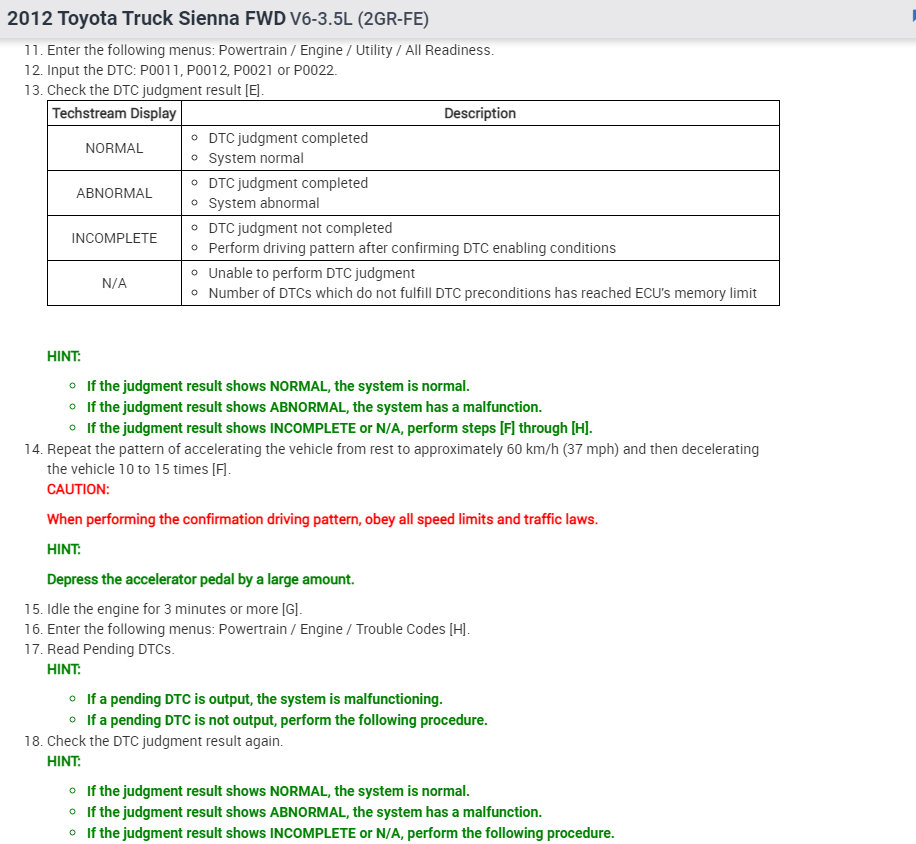

No symptoms.
Apr 26, 2022 at 1:16 PM
SQM
  • 6,383 POSTS

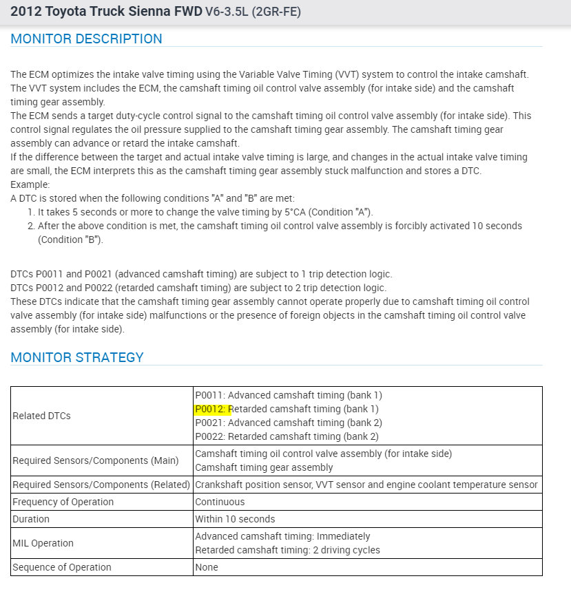

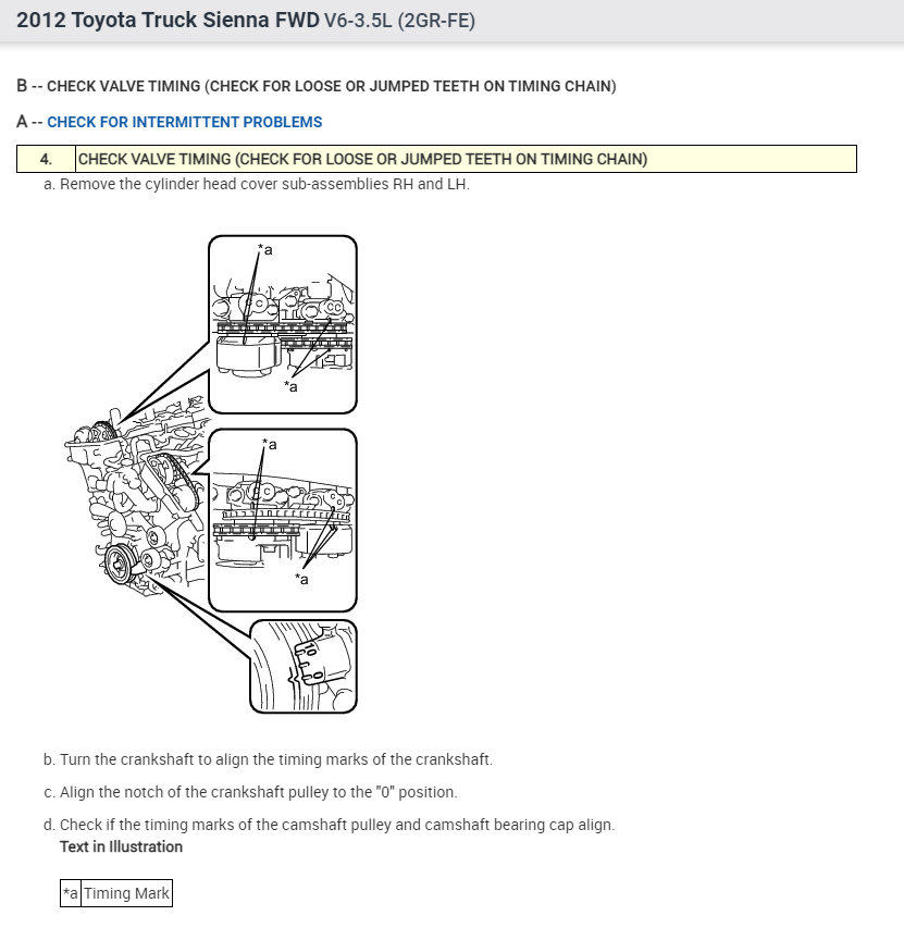

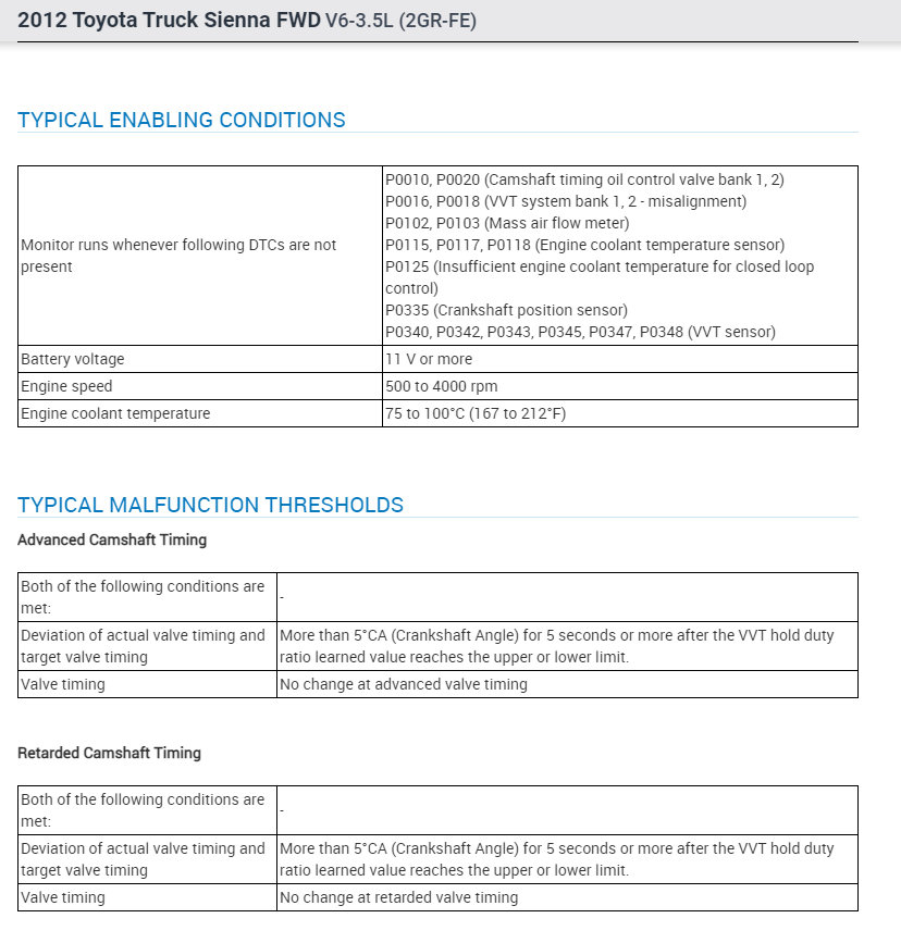

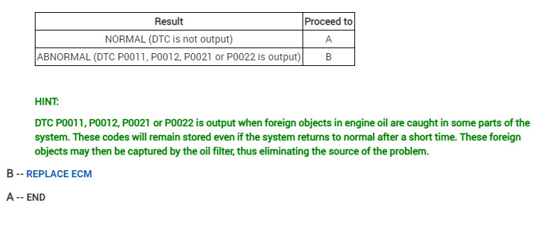

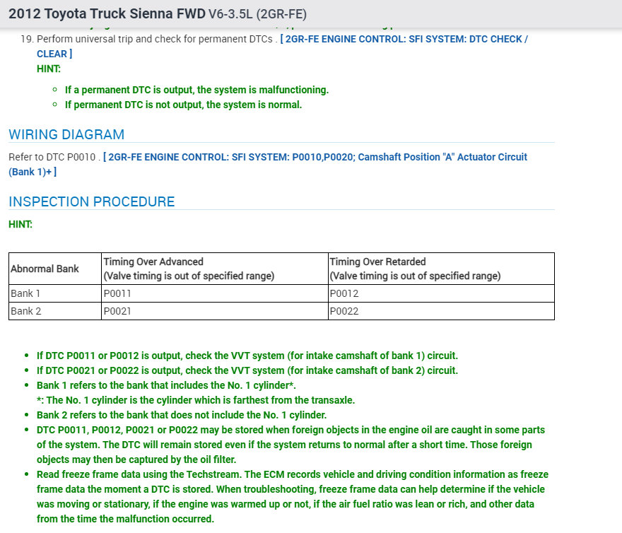

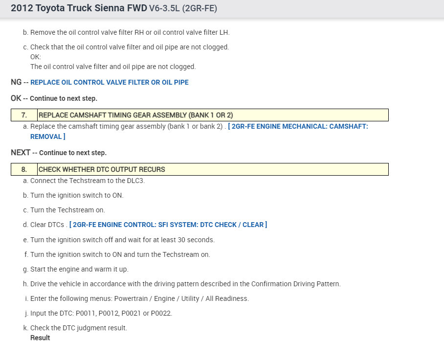

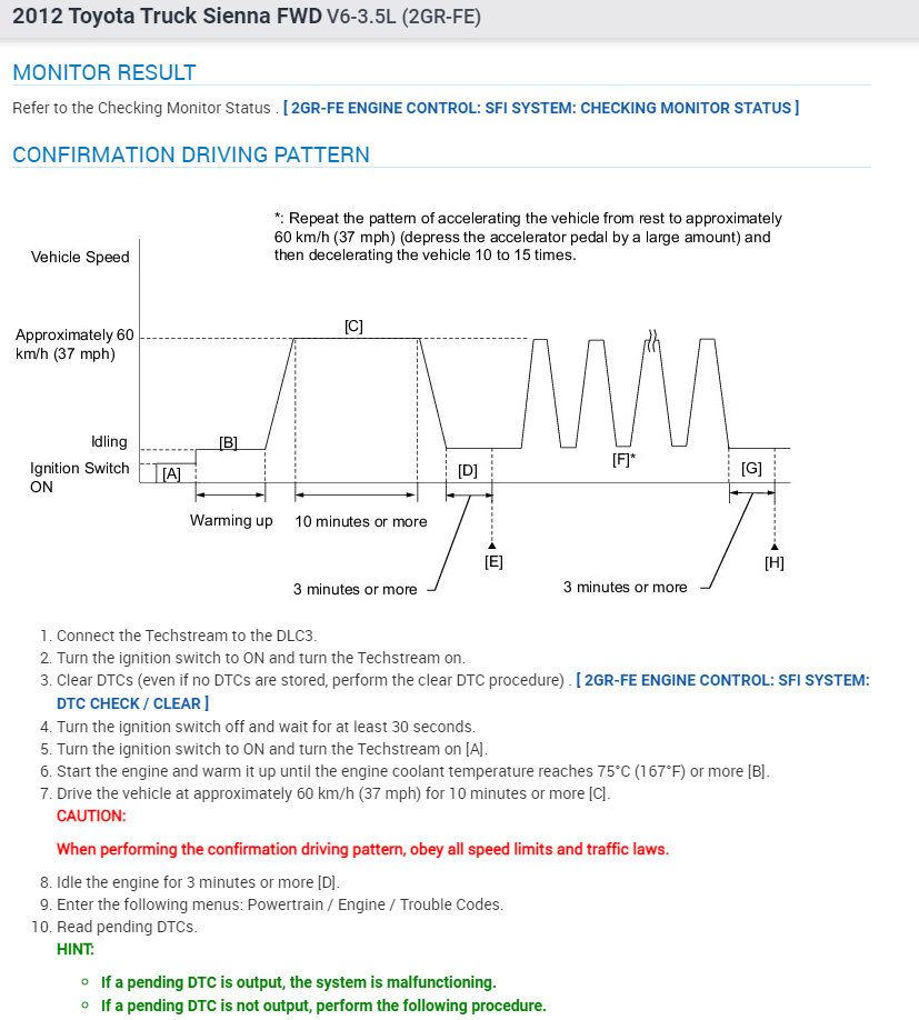

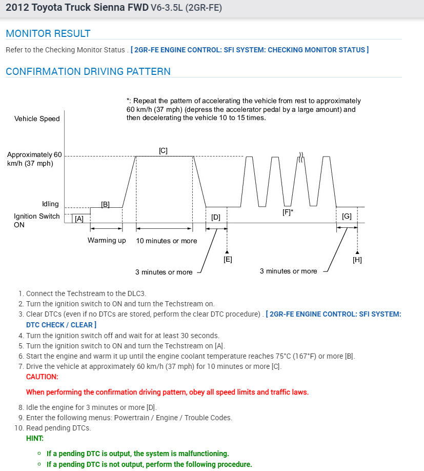

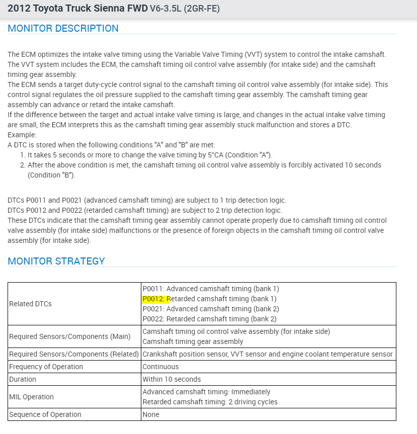

The code P0012 can get triggered due to timing issues, faulty oil control valve filter, the cam timing gear assembly or even the ECM.
This typically leads to irregular idle.
I have attached the diagnostics procedure below for your reference.
Let me know of any questions.
