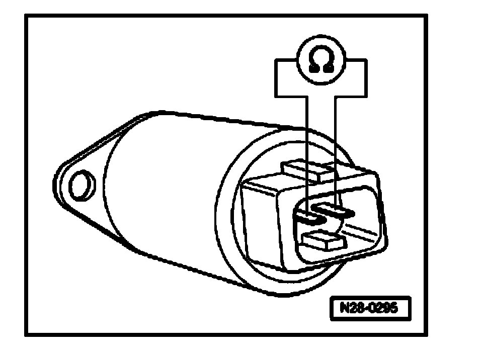

pic 1

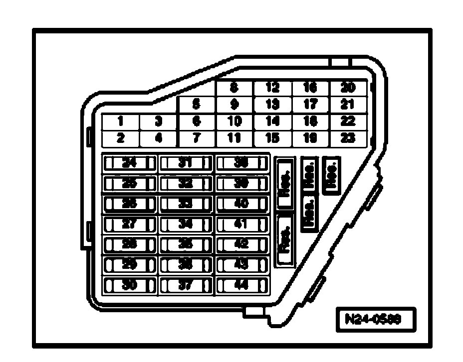

- The respective fuses of the Valve -1- for camshaft adjustment -N205- must be OK
- Fuel Pump (FP) Relay -J17- must be OK, check

pic 2
- Measure resistance between terminals of the respective valve for camshaft adjustment.
Specified value: 10 to 18 ohms
If specified value is not obtained:
- Replace the valve for camshaft adjustment.

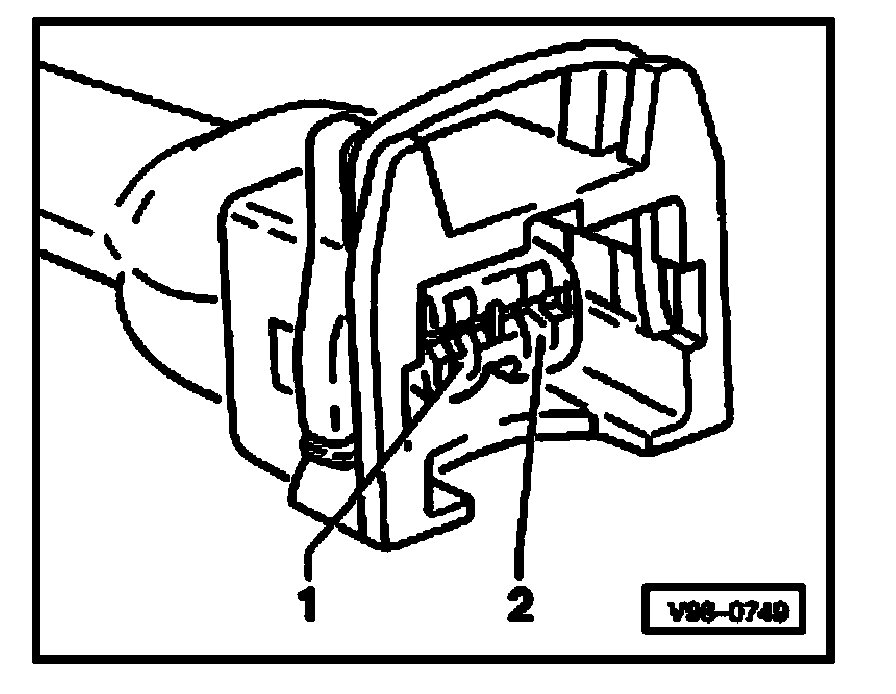

- Connect test box to control module wiring harness. connect test box for wiring test.
pic 3
- Check wire between test box socket 115 + 2-pin connector terminal 2 for open circuit according to wiring diagram.
Wire resistance: max: 1.5 ohms
- Check wires for short circuit to B+ and Ground (GND).
Specified value: Infinite ohms
- Check wire between 2-pin connector terminal 1 and the Fuel Pump (FP) Relay -J17- for open circuit according to wiring diagram.
If resistances and wires are OK:
- Replace Motronic Engine Control Module (ECM) -J220-.
